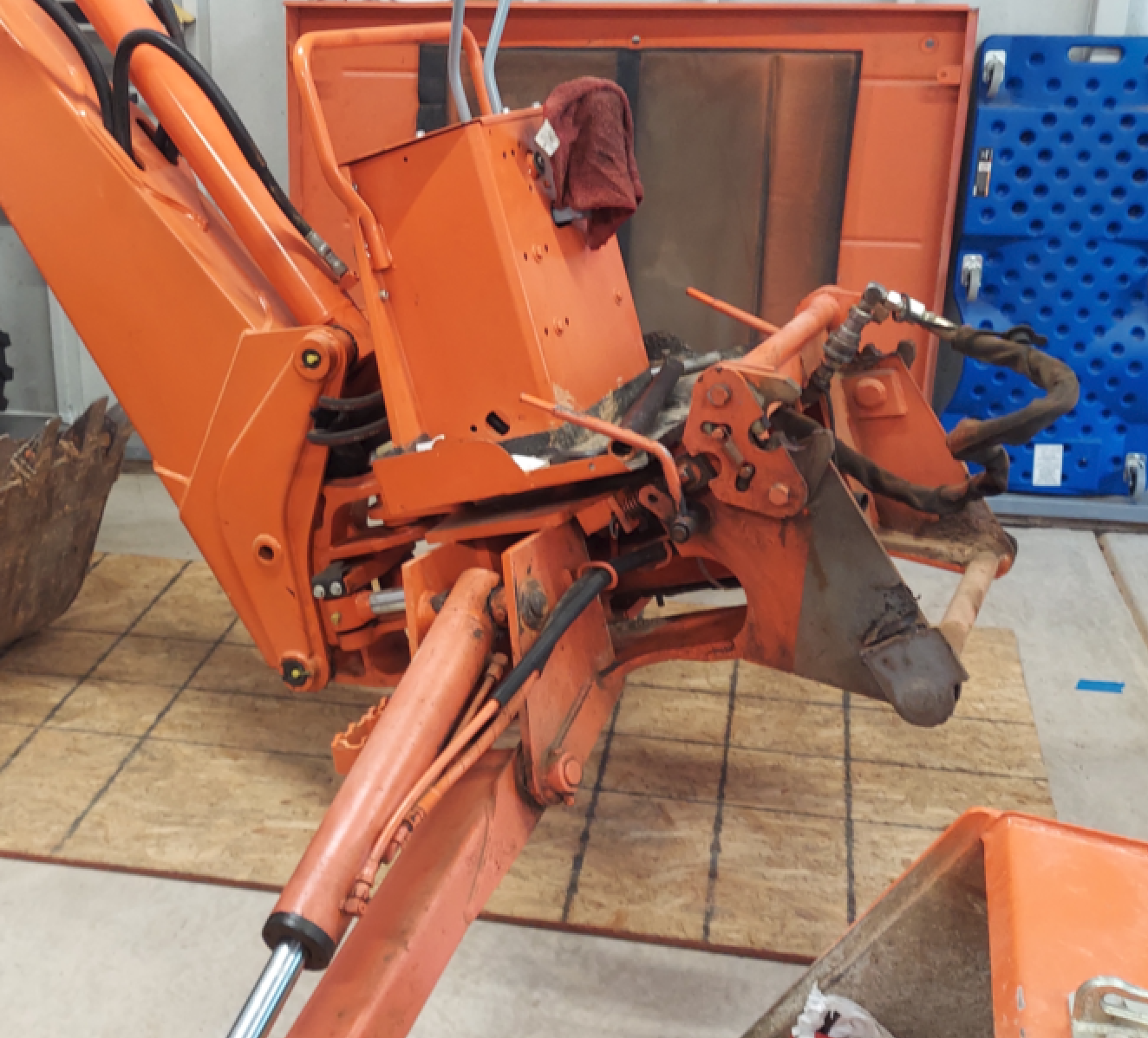

After almost 5 years of ownership and restoration, the time has come to separate my L35 from the BT900 backhoe.
I've restored nearly everything about the two units - except where they connect.
Hmmm, I needed inspiration.
The Mount Release levers were frozen to their pivots in a seemingly permanent bonding of rust.
Unable to move the levers, meant the BT900 was on there for good.
Then I managed to find 2 brand new wheels and tires for the rear and I was immediately inspired!
My original wheels were cracked and I repaired them years ago with welding. The tires, hung on by a thread.
So here's a few pictures of what I did to loosen the Mount Levers and remove the backhoe.
I'm in process of removing rust and prepping for paint at the moment. I'll add to the thread as I go along.

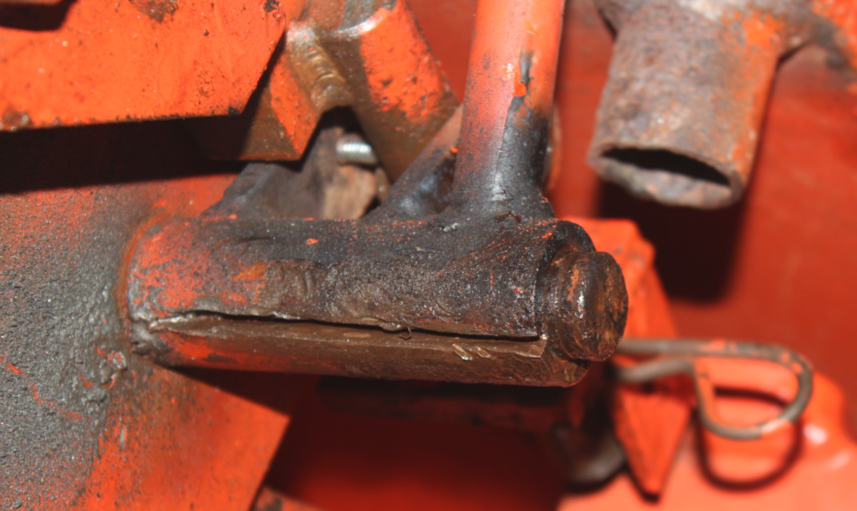

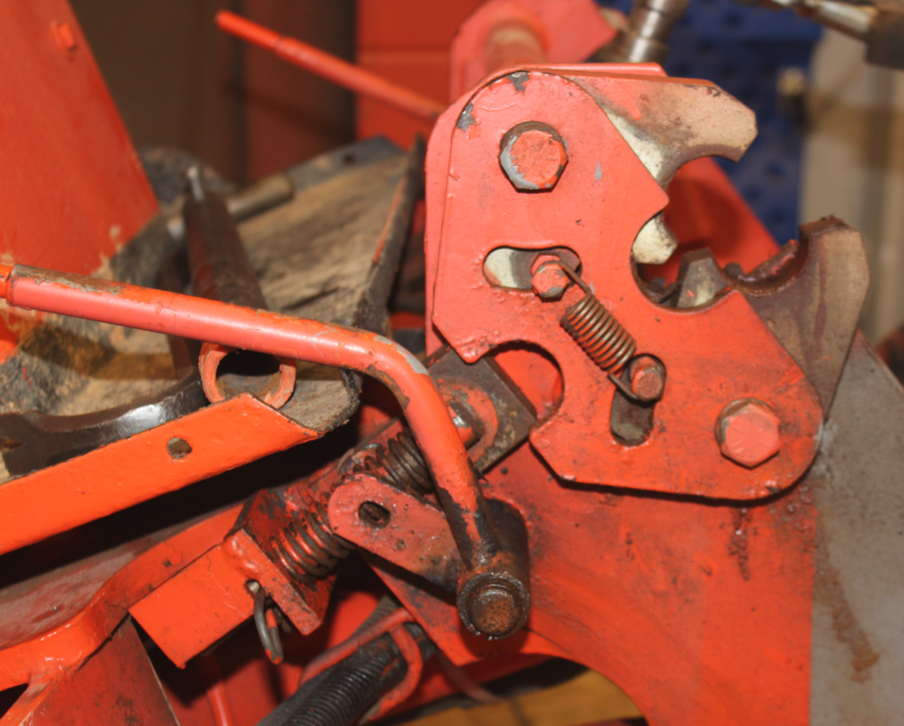

Here is a shot of one of the Levers.

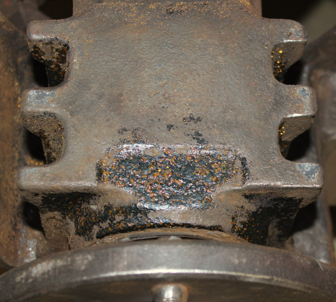

I cut a slot in the pivot tube with a Dremel and 1.5" cutting disk.
That's so the metal would expand after heating and using penetrating oil.
I drilled out the roll pin so that I could move the lever back and forth after I got it to move.
Here's a shot of one side of the assembly that holds the backhoe onto the tractor.
When you move the Mount Levers back and forth, they move the pin with the square piece between the "grip Jaws" which locks the backhoe to the tractor.

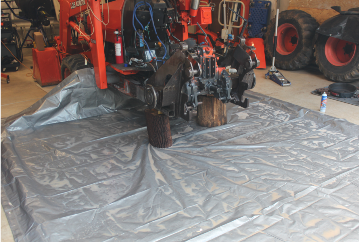

Now I can finally clean and paint both backhoe and tractor where they join!
Here's one side of the tractor cleaned and ready for some Ospho and paint.
Hmmm, might have to do some welding repairs while I'm at it!
How do you like my redneck jackstands?
MORE to come.....

When I bought mine 17 years ago mine were seized also. It was a fight but I won. When I reassembled I anti seized the parts so they wouldn’t give me any issue. Now it stays undercover 99% of the time so that helps as well.
Nicksacco
Kubota L35 TLB, 2014 RTV-1140CPX
Sep 15, 2021
721
439
Bahama, NC
Awesome! Did you have to cut the pivots as I did or were you more patient and gentle?
L35
Jun 13, 2010
600
577
CT
Heat, penetrating lube, lots of back and fourth. Broke the handle off one side when using a cheater bar on it. Welded back on.

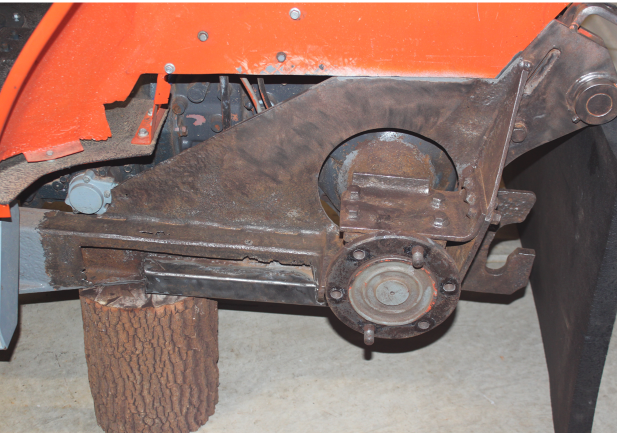

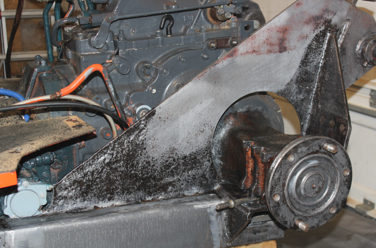

CONTINUATION OF THE L35's RUST WORK.
Since I posted last, it has been an interesting working through the last bits of rusting on the mo-chine!
But good news.
With most of the difficult parts of this process completed, I'm getting closer to painting.

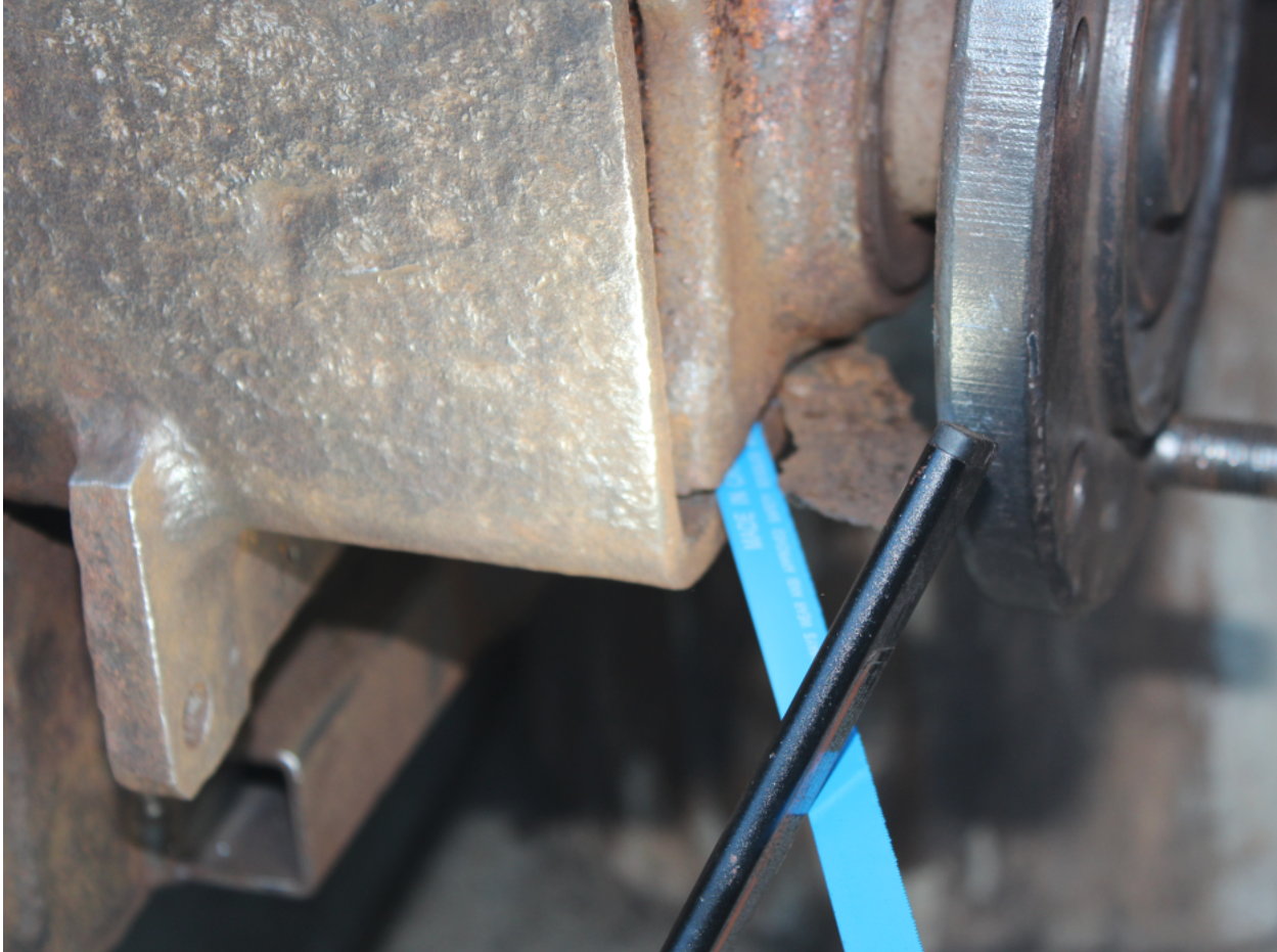

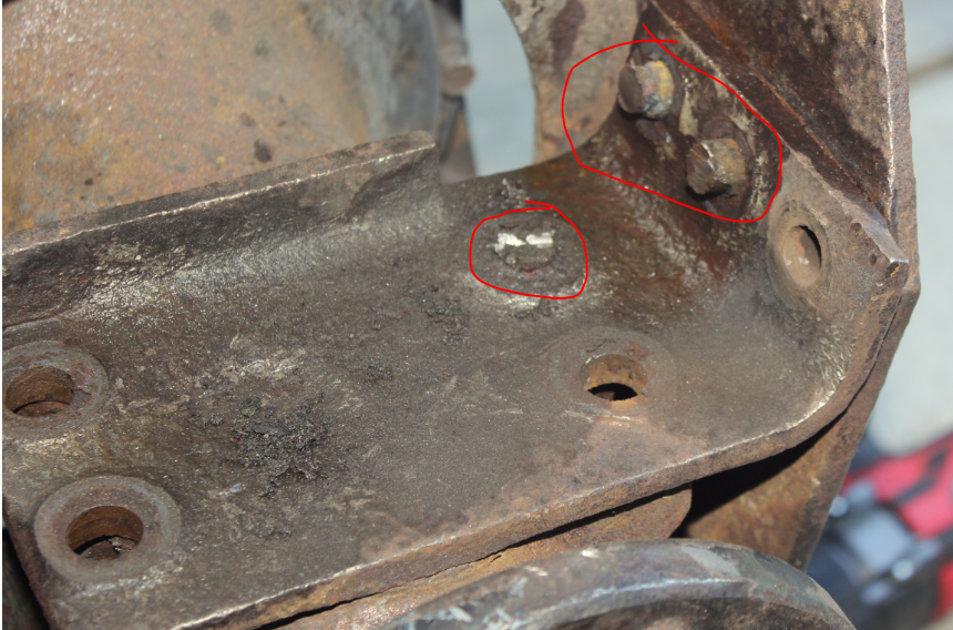

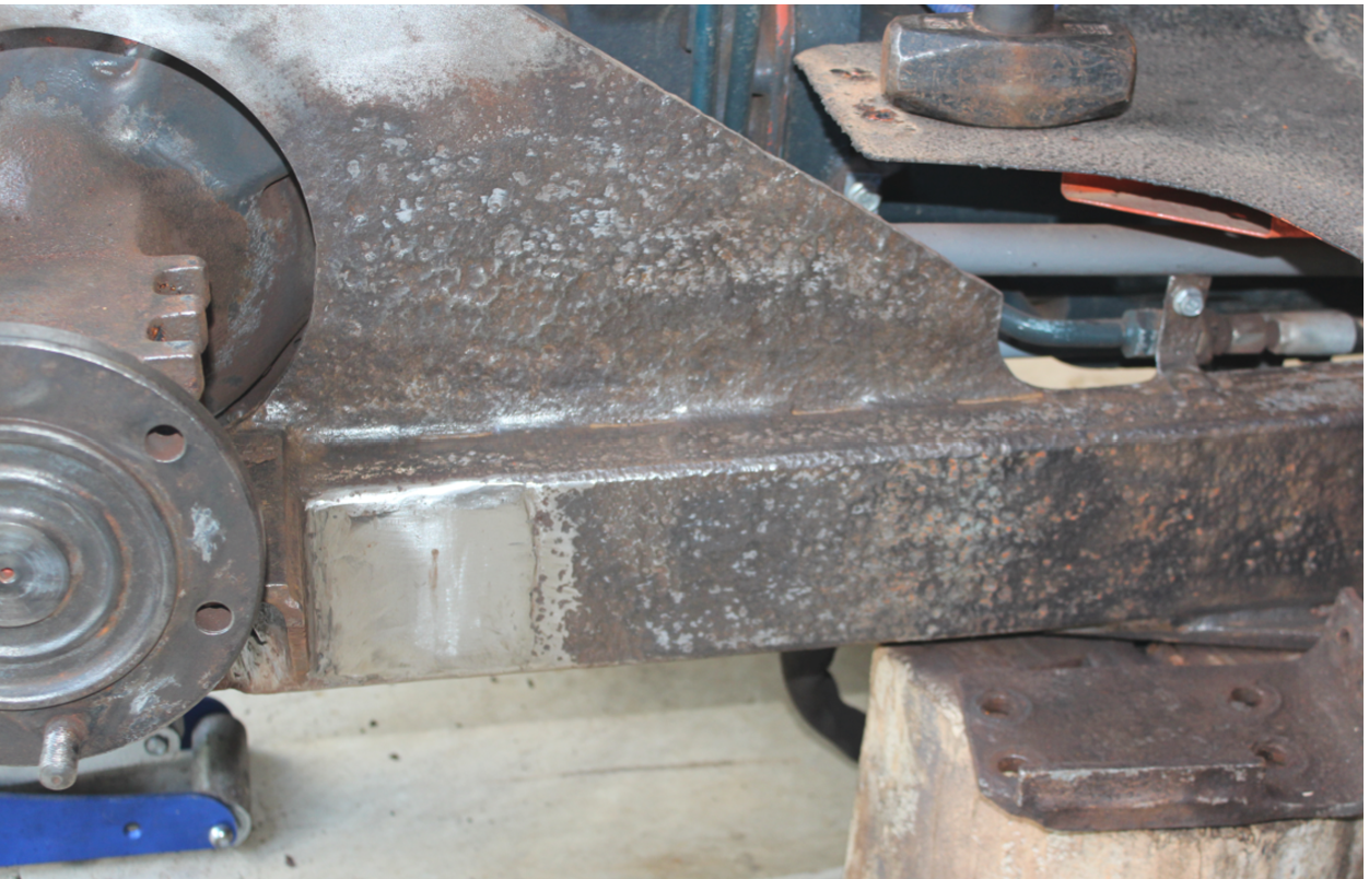

This picture shows the left axle and Frame Support as I'm removing the old bolts and nuts.

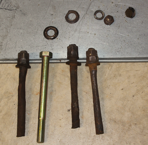

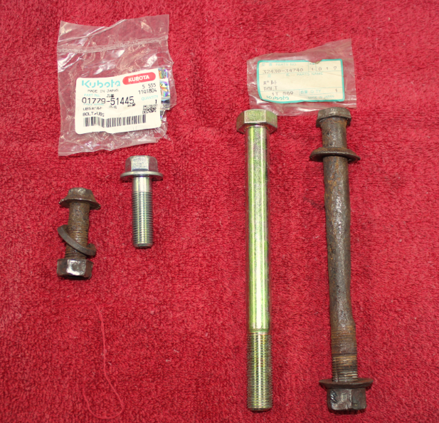

As you can see in some pictures, there isn't much of a head on the cap screws left.
The assembly for the 4-16mm hold-down Cap Screws includes a "Spring Washer" on either end (think something like Belleville) and 2 nuts.
The assembly for the 3-14mm Flange Cap Screws on the side include a Split Washer and a nut.
There was no point trying to use an impact or any kind of wrench because everything was "welded" together with rust and there was no way I was salvaging anything.
So, out came the angle grinders and off came the heads. With some help from my sledge, and some PB Blaster, the Cap Screws were coaxed out.
One Cap Screw was more stubborn than the others.

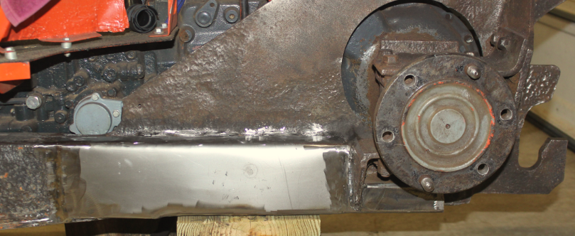

And yes, I did add some metal to the frame tube after cutting out the old rusted metal.

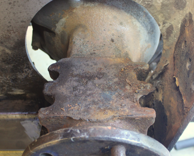

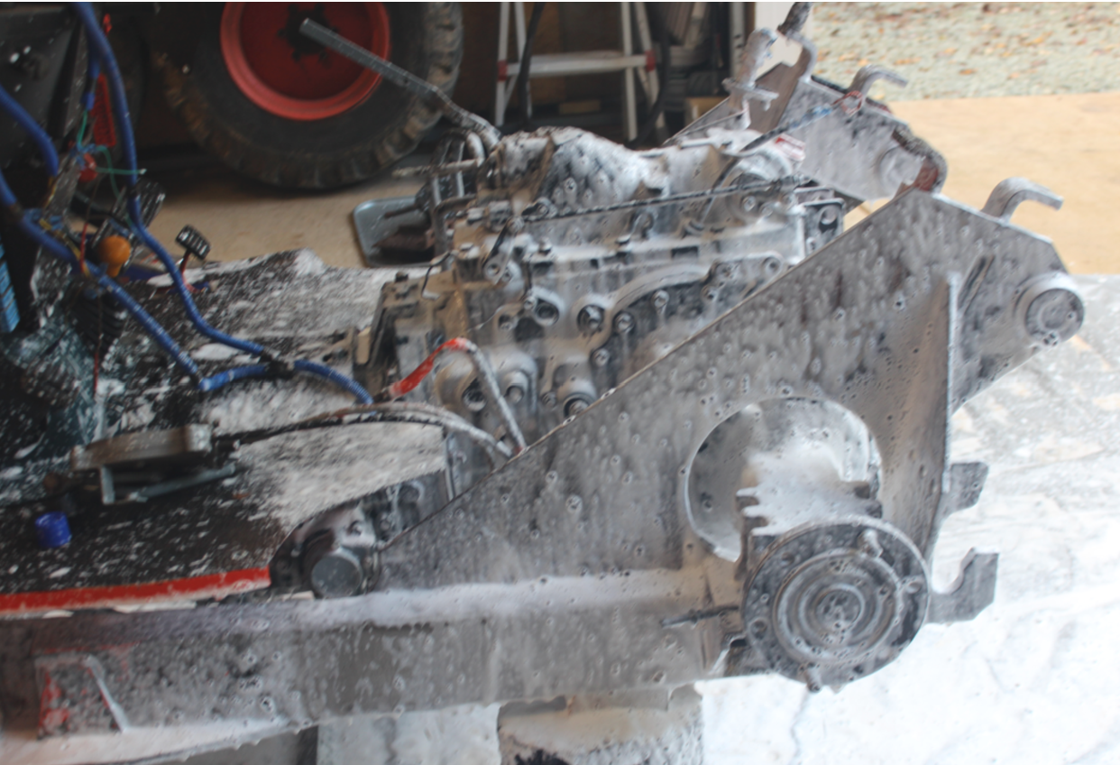

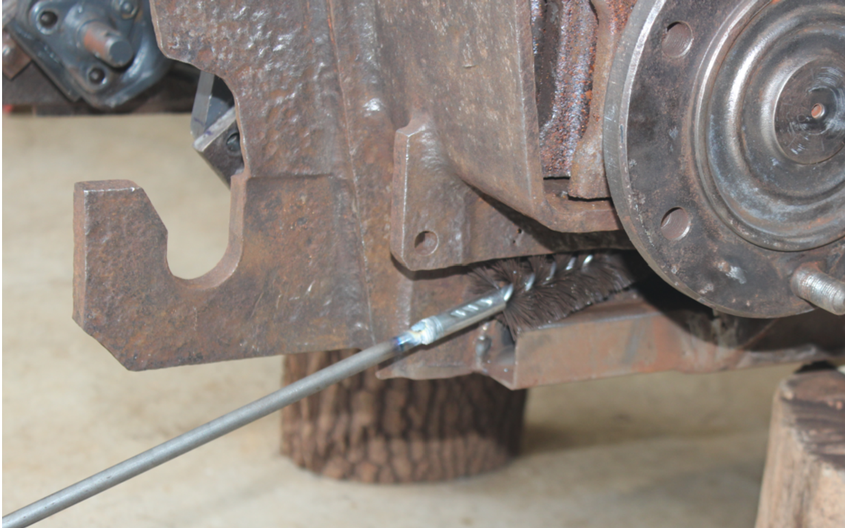

Here I'm in the process of removing rust from the axle.
After removing the rust on one day, the next day I noticed "weeping" and of course, more rust forming.
I read about this phenomenon, and learned that after cleaning metal, the pores of the metal can weep - releasing trapped water - especially if two pieces of metal were clamped together.
In this case the 2 pieces are the Axle and the Frame Support.
Not to worry, I have to wash the whole thing down before I paint to remove any oily products and then I'll be coating with Ospho and Coroseal (based upon location) prior to painting.

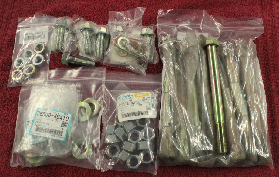

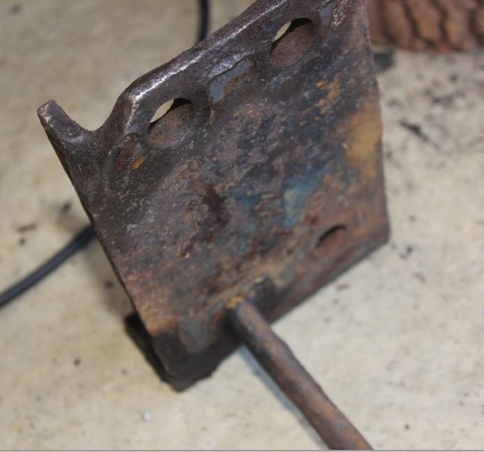

I thought you might like to see some of the cap screws removed in comparison to the new ones.

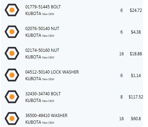

I also found an excellent company in Florida called G&T Engine Parts
The sales lady was Irene Breshnev and I had the parts in 3 days.
They had every part I needed for this project and at a very reasonable price.
AND the parts are all OEM Kubota.
Below are the parts ordered:
One more time:
