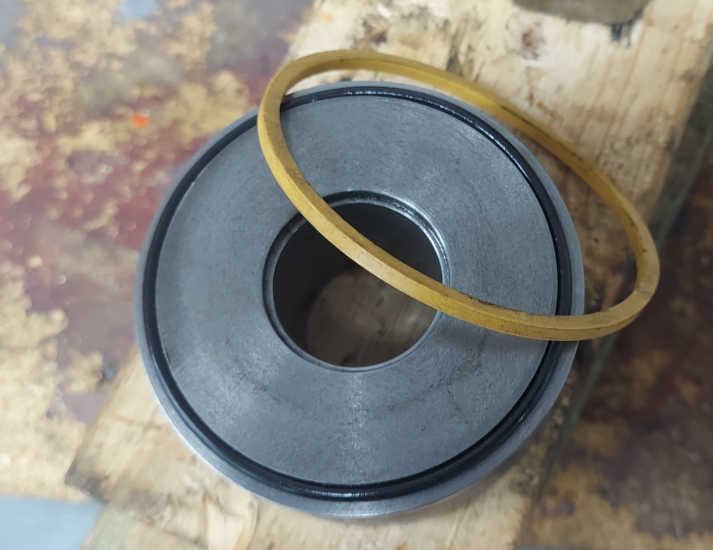

After rebuilding the Boom Cylinder, I installed it back into the Boom. The cylinder is installed "upside down" in the boom - meaning that the hose attachment points are facing the ground in the boom.
Note that the piston is in two pieces with an Oring surrounded by the seal at the middle.
The first section of the piston has an interference fit to the rod (the hole is slightly tapered) so it required a press to remove and replace.
I also replaced the bushing at the gland end of the cylinder using a press.
And Yes, there is a small Oring that fits between the front and rear sections of the piston in the indentation (not shown).

That is interesting. I don’t recall my piston being 2 pieces. IIRC there was a note in the parts catalog for a split in the serial numbers. I imagine I have one of the lower serial numbers and you have the upper, and there were model year changes with the machines.
Yours is much easier, getting that fibrous square cut oring over the piston to seat in the groove was stressful, always a fear of tearing it. I heat them up in warm oil and it makes them a little easier to work over then into the groove.

He had me wondering. I know I had my cylinder out to replace the hoses, and I thought by then I knew to repack the cylinder while I was there. But I knew I hadn't done a 2-piece piston. According to the parts diagrams, there are two types, must be a serial number break. I think I have a later build tractor.

Good Points, guys.
I should've mentioned that there are 2 boom cylinders based upon S/N.
That's S/N of the Backhoe - not the cylinders themselves.
There are 2 cylinder types for Swing, Dipper, Stabilizer, and Bucket as well.
Here are the Boom cylinders:
