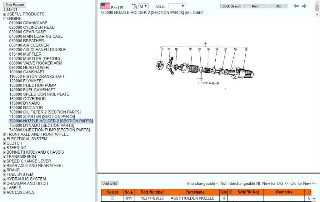

Biffog, welcome to the forum. On the injectors I'd suggest buying for a dealer. Kumar injectors can be less then desired. You can purchase them, install them, think your fuel problems are over....only to still have similar problems. Then end up with Kubota injectors, which requires you to remove the ones you just purchased and start over! Maybe others have had better experiences with aftermarket injectors.
The injector 17391-53000 is $120 from Coleman's Kubota...so maybe that price difference would be worth the hope you'd get good working parts from aftermarket.

From another thread I picked up the injector part no. to be 70000-65400, which replaced 70000-65209, they are $68 from Messicks -or have I got the wrong p/n, maybe V1501 vs V1501DA?

I went to the Kubota Tractor Corporation site and entered the L345 tractor and got the number I listed. It may be wrong, or has been updated.

D2Cat... I'll bet you hit L3450 by mistake when you looked up the part number. ;)
I can't tell you how many times I've done that. :eek:
The L345 takes the 15271-53020, same screw in injectors as the B7100's D750.
This is our favorite place to get these injectors, yes D2cat's favorite too!
https://oregonfuelinjection.com/shop/heavy-duty/kubota/new-injector-kubota-15271-53020/
They are well worth the extra price difference!

Biffog, North Idaho Wolfman is correct. You do not have pencil injectors which means you don't need the special tool and the injectors will cost less.

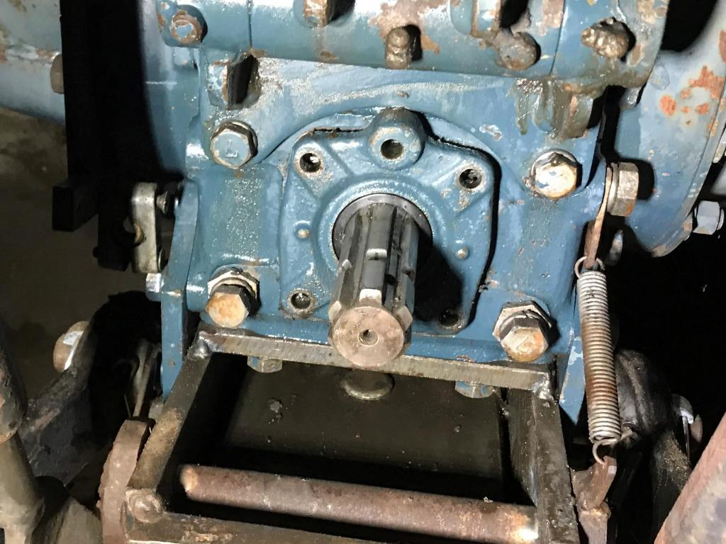

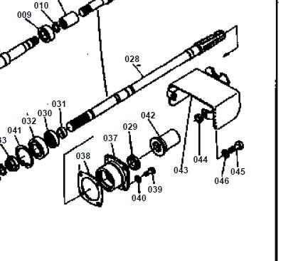

I have another question, there is a small hydraulic fluid leak around the PTO shaft, seemed to be coming from the plate with 4 screws, bearing case according to the manual. I ordered a new gasket but when I went to remove the cover its not coming off easily. Is there a trick to getting this off? the black seal is tight to the shaft and I don't want to damage it. Also the diagram in the shop manual does not match the one in the parts manual

It should come right off, the seal and the tight fit will make it a little tough gently pry it from two sides straight out. ;)

This is one of Kubota’s bad designs. You must remove the PTO shaft to replace the seal. To remove the shaft you must split the tractor. You have a snap ring on the front of the shaft that must be removed before the shaft will come out. The best thing to do is look at a parts book to see all the parts.

007kubotaguy - thats what I was afraid of... I'm only trying to replace the gasket behind the plate- the black seal looks ok, do I still need to pull the entire shaft?

Sorry for the bad info, I didn't look deep enough into it.
If you can get the plate to side out just a little you could use a syringe to inject a little RTV into the gap then bolt it back up.

Yes I can get it out about half an inch, i will try and clean out the old broken gasket, cut the new one in half coat it with gasket weld and slide it in from each side...might work, or else I have made a small leak into a huge job:(

I've actually seen some of the gaskets made exactly like that, try and use gasket material the same thickness as the original, or none at all, If it was a thin gasket RTV (silicone) will work fine and dandy! ;)
