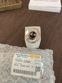

Here is a picture of the bulb from my L185. It may be the same one that you have on the L345 (or not)
I recall that the glass bulb is too large to fit through the rear of the assembly and the glass lens has to be removed. I vaguely remember that just the glass comes loose and the metal part will not pry apart, just the glass. But I know it will be a lot easier to get the whole assembly off the tractor before you get to frustrated. Then look at the back side and see if you can determine how the bulb is held in place. From looking at the bulb it has to rotate CCW to be removed (looking into the assembly glass)

Here are the pictures of my L185 and how it came apart
See posts #7 and 8
7,413
2,789
Here is a view of the rear of the bulb
6,654
4,043
Push IN…and twist.
