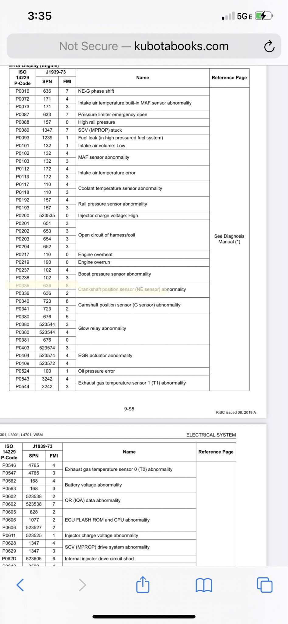

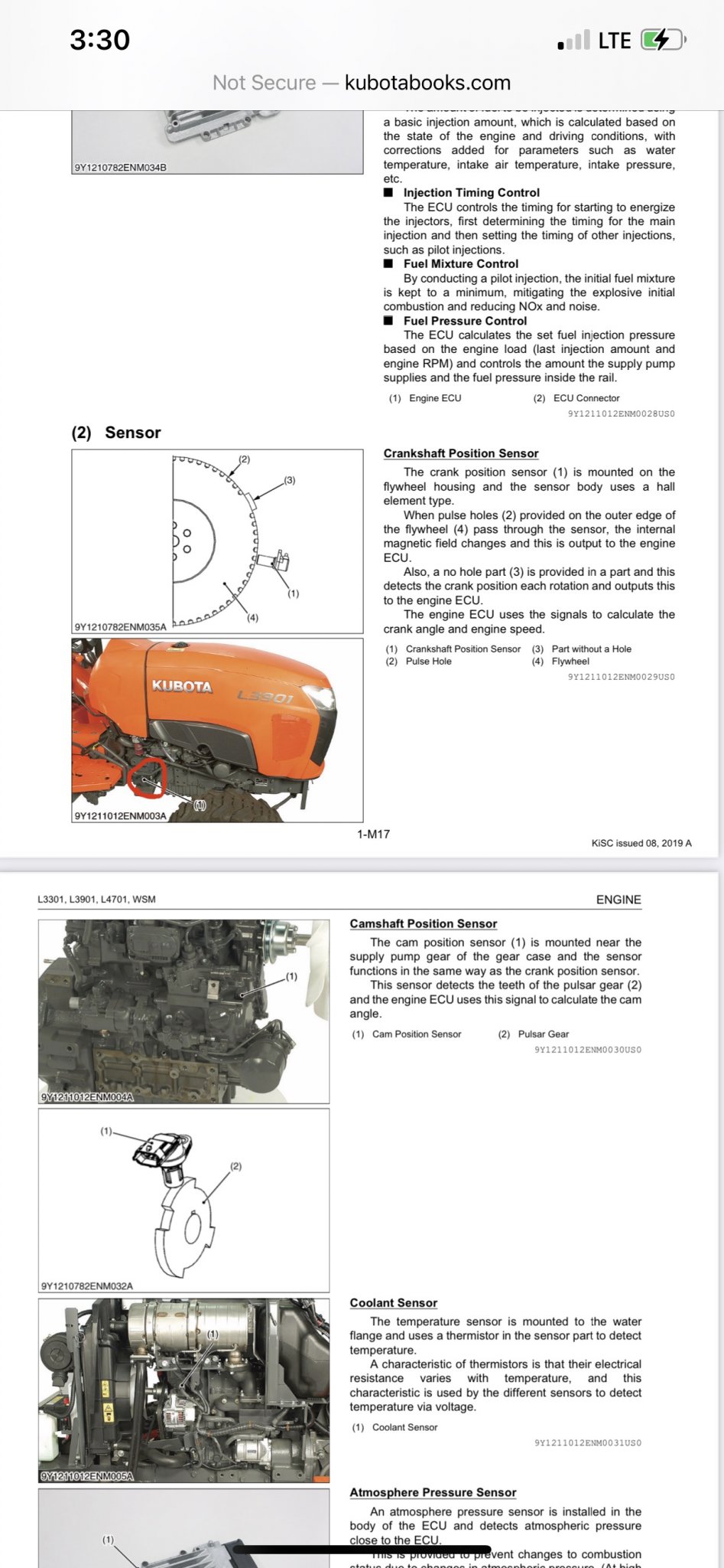

Here is a link to a free workshop manual for your tractor
It doesn’t have the diagnosis manual though, as referenced in the screenshot I posted.
I think I recall some L3301/3901 owners having a p0336 set after stalling their tractors, there might have been a Kubota bulletin? I didn’t search here for it, but recall the code issue. Doesn’t sound like that is your issue though. I don’t deal with tractors, and know their codes don’t directly correspond to automotive codes, but think they are close. P0335 is a circuit issue code, P0336 can be circuit or condition code, thats why I would be looking at a wiring issue. And it happened while bush hogging…any chance you ran something over with the tractor that could have come up and hit the tractor?
