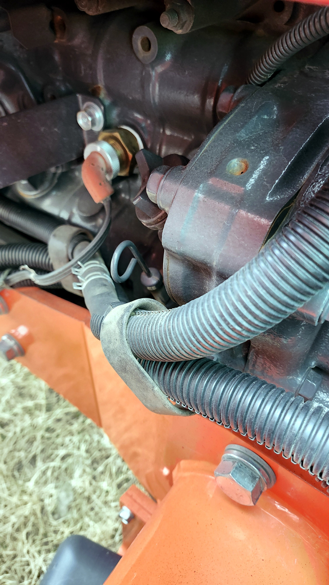

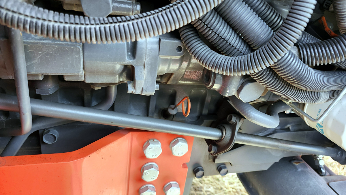

I took a zip tie and made a finger size loop, then another zip tie or maybe it was 2 to fasten that to the grooved area of the knob. That has worked pretty good for my old arthritic hands.
I can remember I will take a picture of it.
Bill
So this is what I did, I understand the thoughts of catching but my arthritis demanded I do something!

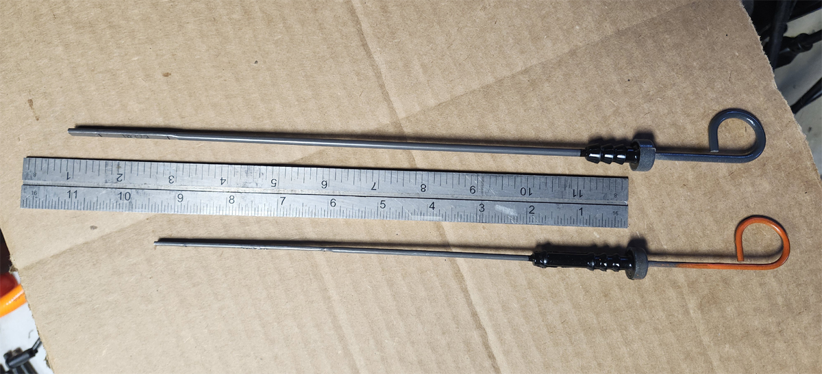

You would think that a dipstick from another model would/could work. If you post some good photos with measurements of all the salient features I'm sure we could figure out a compatible Kubota part at team OTT. Surely there are enough dipticks on this forum. 😂
Here are the dipsticks on the MX6000 and M6060.

Down the rabbit hole we go. 😂

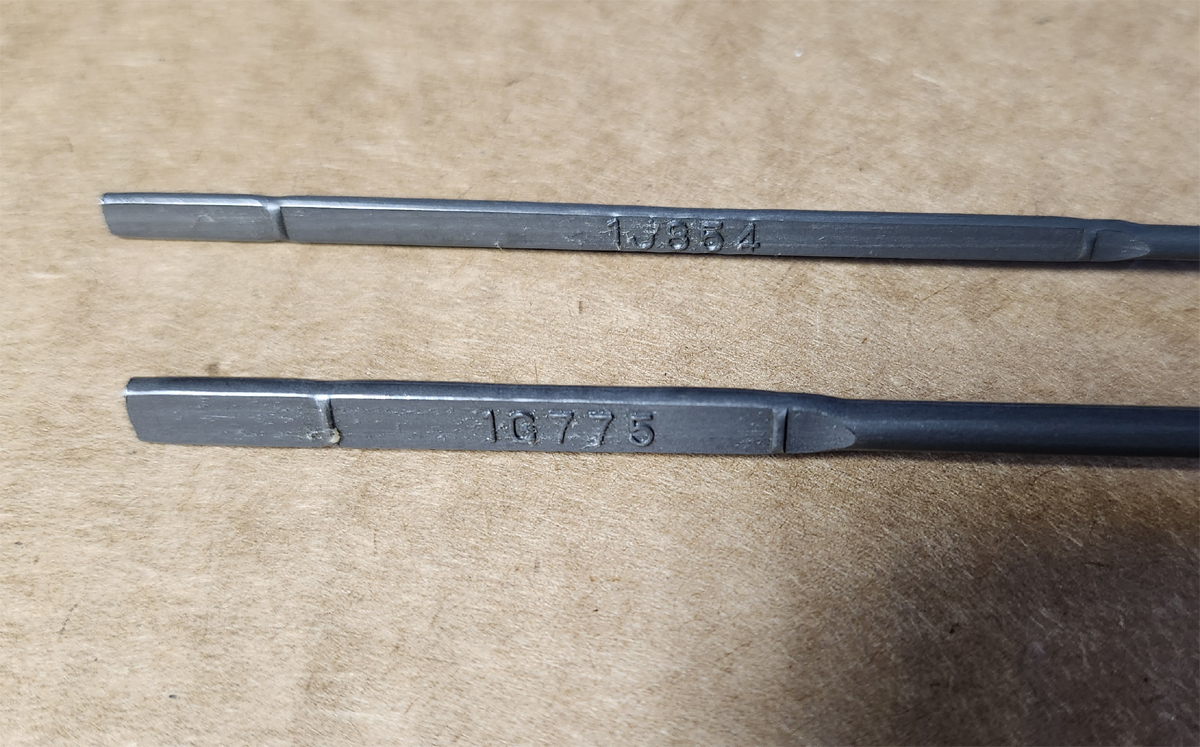

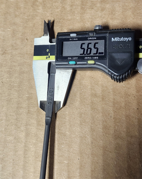

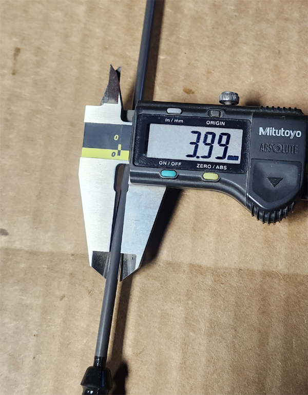

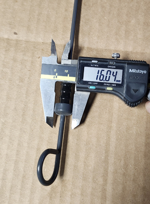

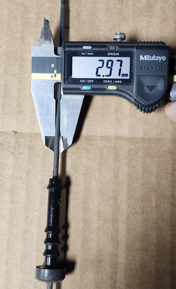

Here are the engine oil dipsticks from the M6060 (top) and MX6000 (bottom). The length is the least critical dimension since a long dipstick can be cut down and remarked, but the image below gives a reasonable account of the length.

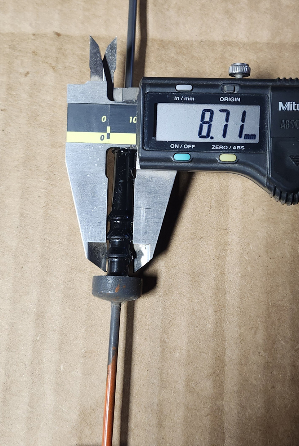

8,337
11,725

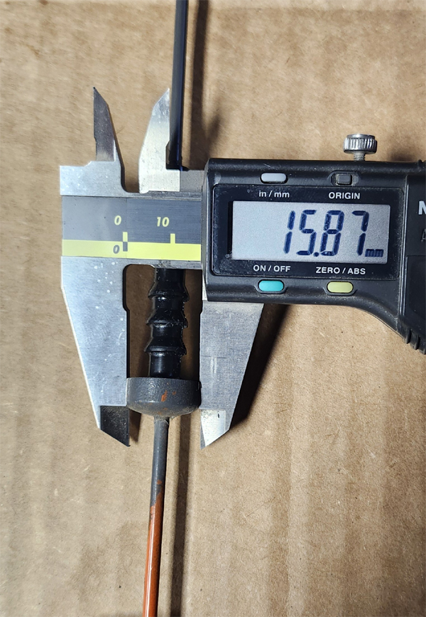

Here are the more important dimensions in mm in honor of our Japanese friends.
MX6000 dipstick.
8,337
11,725
And here's the M6060 dipstick.
