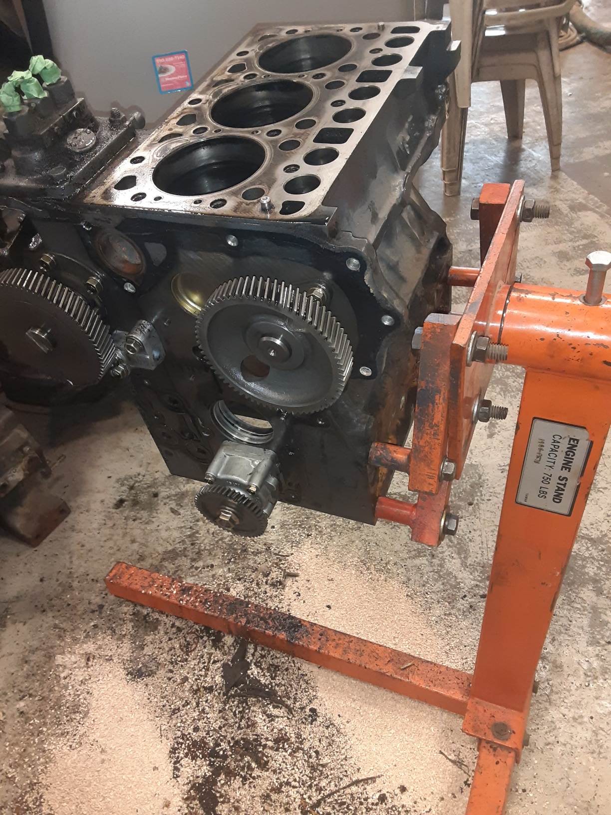

After I hoisted the engine out of frame I mounted the bellhousing end of the engine to an engine work stand. The same way I always do when working an engine. Doesn't work so well on this one. The crankshaft and main bearing carriers load from the flywheel end of the block, and the engine stand mount blocks that access. So I dismounted the engine from stand and manually tipped it over and over to disassemble head and oilpan and crank and stuff. Then I got the brain-wave to mount the engine stand bracket to the SIDE of the engine block, using the frame-mount bolt holes. Mucha betta.
Also a pic of my home-made frame stands that hold the front-half up while splitting. Yes, just rusty scrappy angle iron from the "pile" behind the shop, nothing fancy. Note the "adjustment" bolts on the bottoms that will slide along on the floor. Now that the engine is out, the whole front assembly is unstable and wants to flip over, so theres a similar stand on the nose of the frame to keep whats left of the front half from flipping over. engine on stand.jpg Frame Stands.jpg
