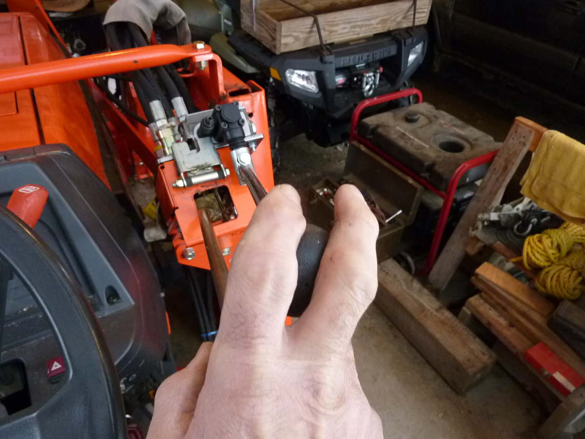

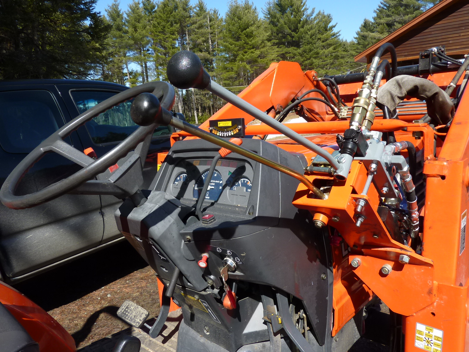

I have the same tractor and loader. Back in 2011 I added a mechanical 3rd function valve for the bucket grapple I have on it.
I posted the project on the another tractor forum back then. Here is a link to it.
CAUTION - At the very end there is a couple posts about some fitting changes I had to make on the work pors and PB port because of interference between the QD connectors.
I still use it today.

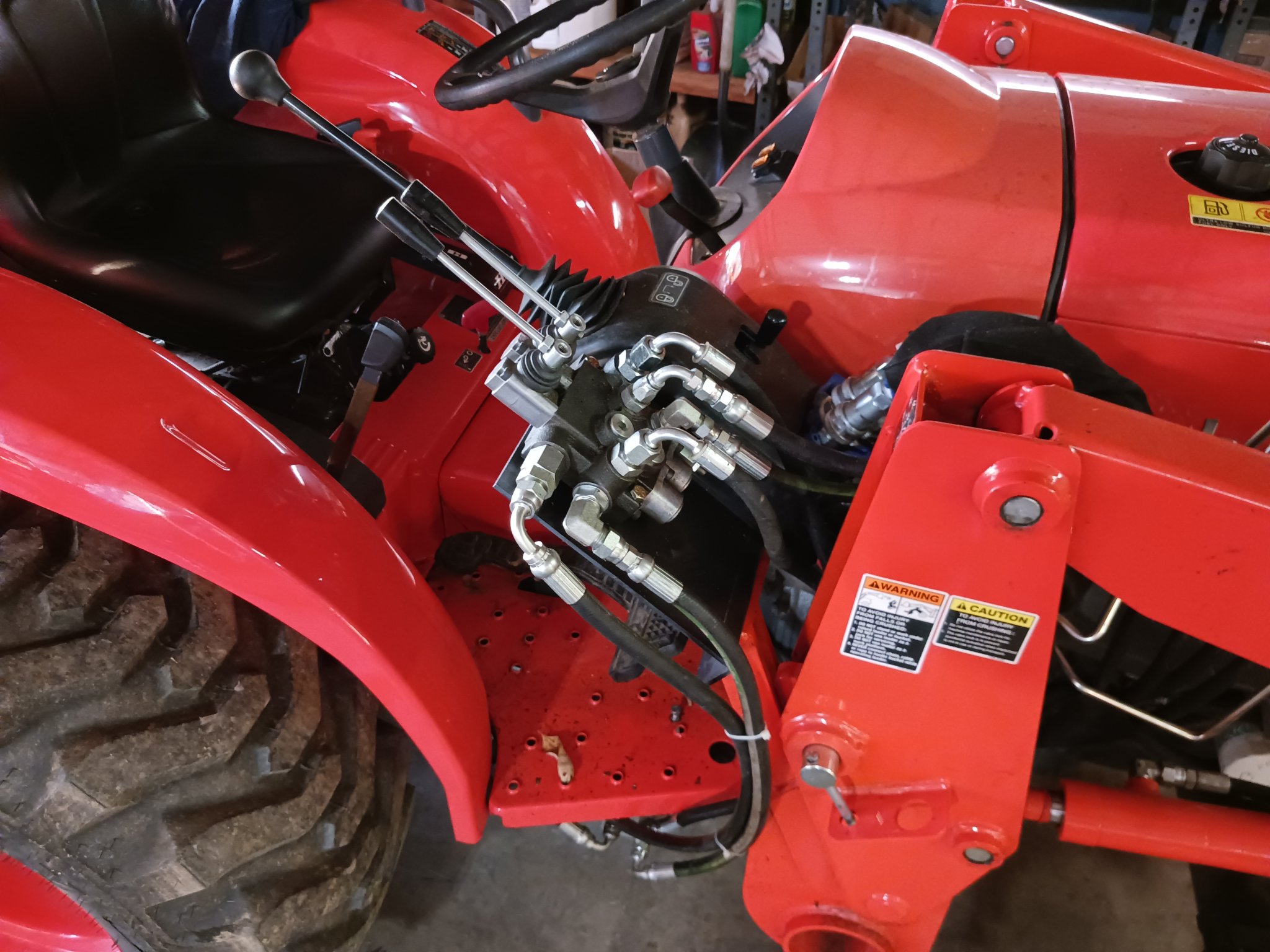

Are you sure that's the way you want to go? I added a section to my valve to get a setup similar to @g_man 's. I'm thinking a push button (actually 2 buttons) on the single stick would be more convenient for my grapple use.

The new 3rd function switches on the loader control handle for electric valves are great. I have one on the M5640. But if you look close you will see that I made the control lever for mechanical 3rd function valve on the old L3010 so that I can control the FEL and the grapple with one hand simultaneously. The grapple lever swings left/right inertly so it will it can follow the FEL lever when doing a curl/dump. That way I can always have both levers in one hand. Also, I like being able to feather the grapple which you can't do with an electric valve. So mechanical valves don't have to be a bad thing operationally though they are more complicated to install.

That sounds like my technique with brush. The 'issue' with my setup is this: the valve section I added is the first in the stack. Since it is not a series configuration like the curl valve, it blocks the curl and lift, I cannot curl and close the grapple simultaneously, I have to alternate, inching each one.
My setup is clean, no interconnecting hoses, but, unless I find a cheap series valve section, I think a solenoid would do. Actually, I'll probably just keep what I have and practice more.
EDIT, that's wrong, the new valve is the last in the stack. But the operation is as I described. Hmm, I'll have to do more studying.
gg
I think your setup allows you to have curl and third function simultaneously. Mine doesn't. That's a clever setup you have there.
