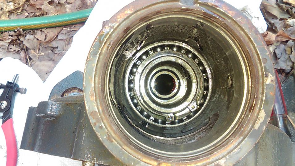

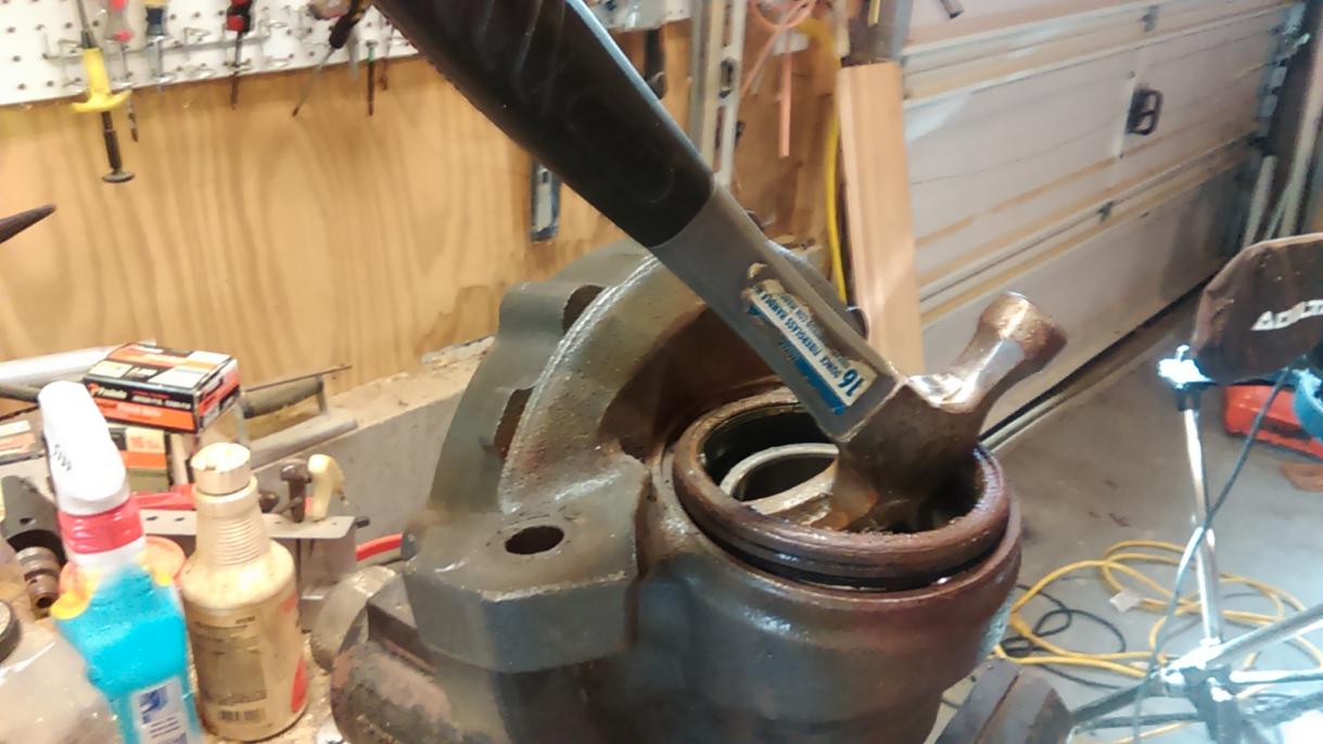

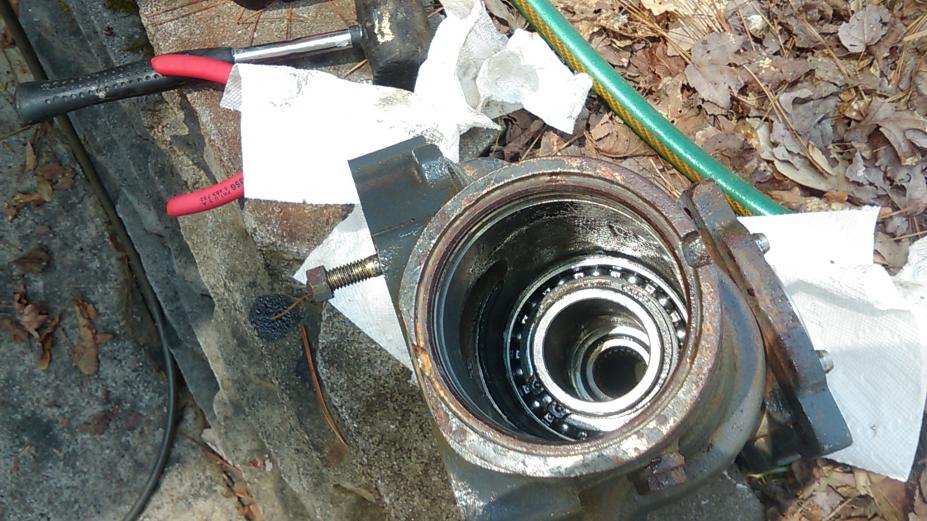

X2 with Wolfman. You want to pry just the seal up. I use a BEEFY large screwdriver or pry bar and just get it under there and pry up. You will want to use PB Blaster/Pen oil on the outside lip of the seal where it meets the housing so it will help it separate/pop out.
I have tried those harbor freight seal removers but broken many of them trying to remove this type of seal. Pry bar is key. Once seal is out...you don't even need to remove the bearing unless its bad. Just rinse the bearing with lots of diesel and/or WD40 to get the sand and grit out of it that fell in from the seal removal.

Hey North Idaho Wolfman - ya did it! I went back and re-read and thought I had to get that 3rd C clip out, but couldn't see how that held the upper bearing and seal in. I had used a screwdriver to try and pry out the seal, then saw the claw hammer and viola!!

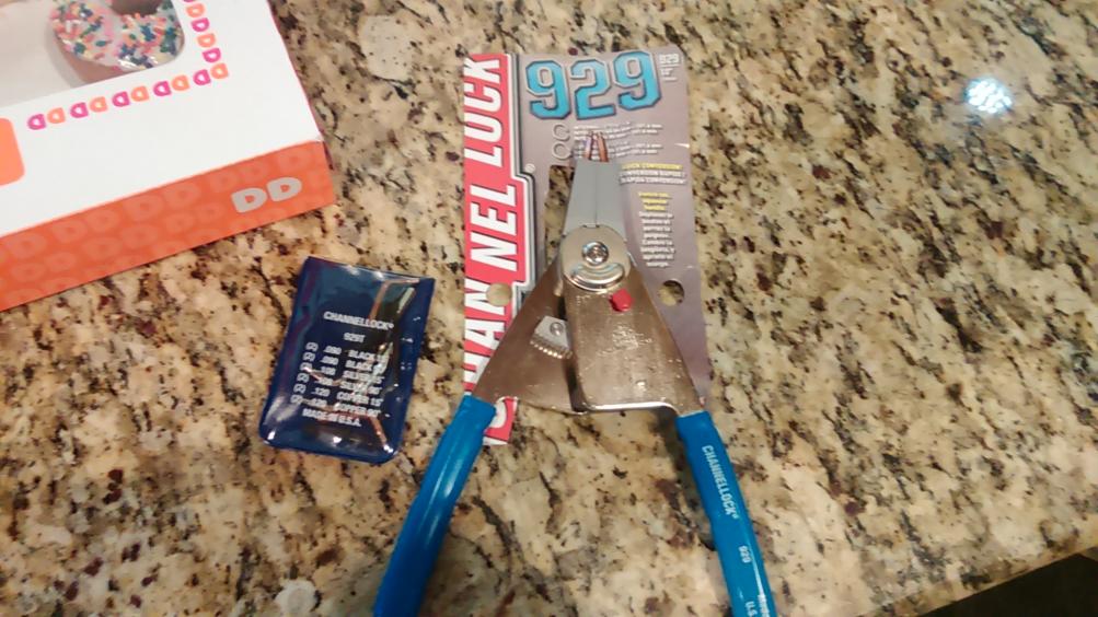

Thanks everyone for the help. My heavy duty snap ring pliers should be in today, so will be much easier putting back together and, doing the left side.

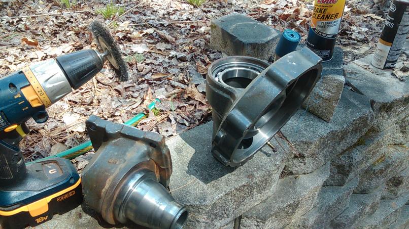

filldirt
L3010
Mar 14, 2016
31
acworth, ga., usa

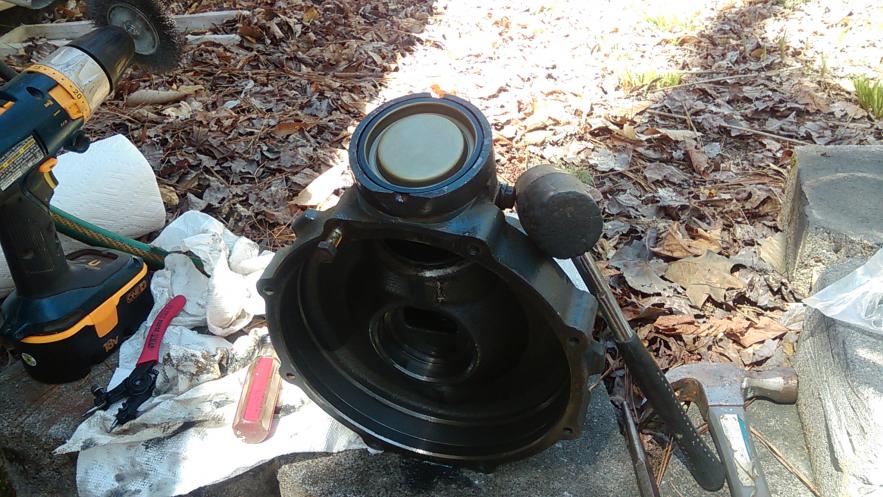

Thanks Billdog350. Yes, I had to persuade the C clip (see pix). After using brake cleaner and compressed air to clean all, used emery cloth and wire wheel to clean up seat faces. I got the external C clip in place but it wasn't completely set. I flipped assy over and tapped with a hammer until it seated.
Also during assy, I poured 80/90 over the bearings and faces. Rubber mallet worked well for the "C" seal on the bottom.
Still waiting for my heavy duty snap ring pliers (they were supposed to be in last Fri). Think I'll wait for them to start left side. Should go much better now that I know what "not" to do.

These look like my Napa ones...$65 and you'll have them in 2 days if you have Amazon Prime (if you don't get Amazon Prime and use it! I love it!)

Heavy duty snap ring pliers made all the diff on the left side. Finished it in less than 3 hrs!
