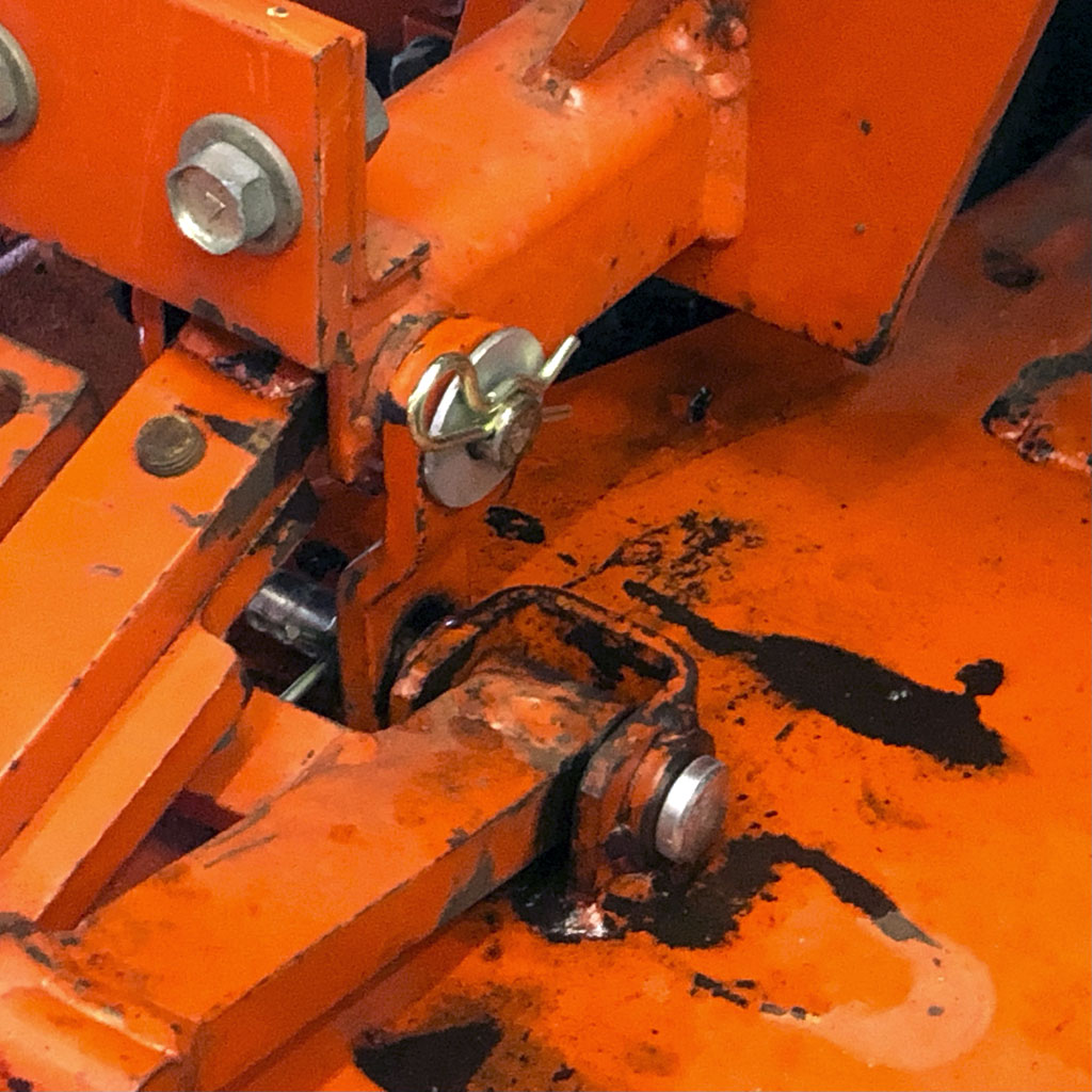

Anyway, no real tractor work in its future, just mowing. Meanwhile, I've been reading up on the mower deck manual and unless I'm mistaken, it perhaps appears I can raise and secure the mower deck in place, then disconnect the two rods from the 3-point lift, and then use an implement attached 3-point (the flail mower) without first removing the deck. This is one of two rods I'd disconnect/remove to free the 3-point to do other things.

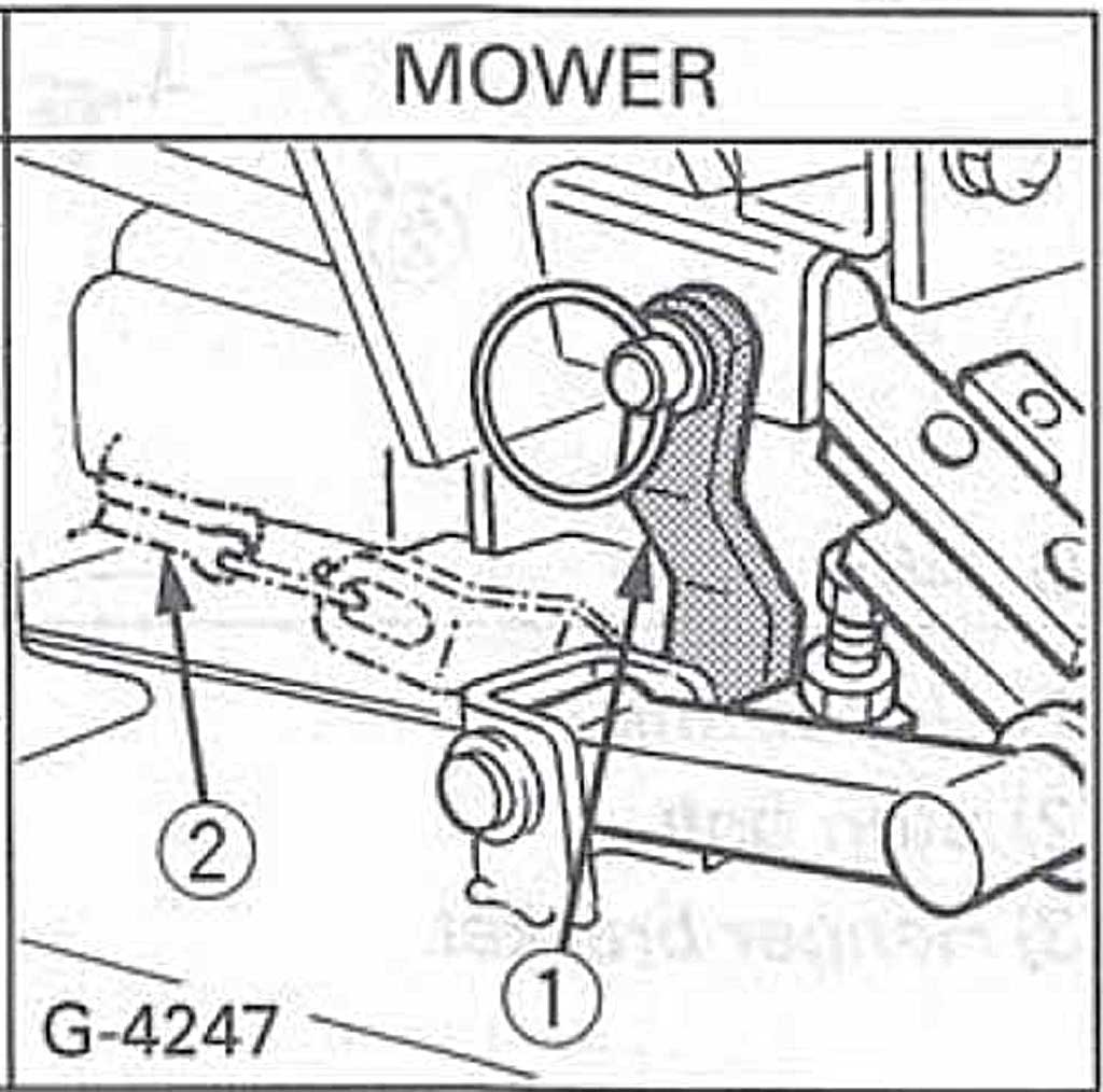

So what I find interesting is Kubota say to stow it with the two locking tabs. I only have two, they only show two, and I am curious how secure this turns out to be. I honestly expected the attached exploded view to show stowing it at aft scissor position, also, but nope!
Anyway, what I see is what the drawing on the right show, the one labeled Mower. I've not quite sussed out if the drawing to the left are the aft mounts but if so, they're not shown with the deck explode views. All will become clear once I return to the project and experiment with stowing the deck for the first time.

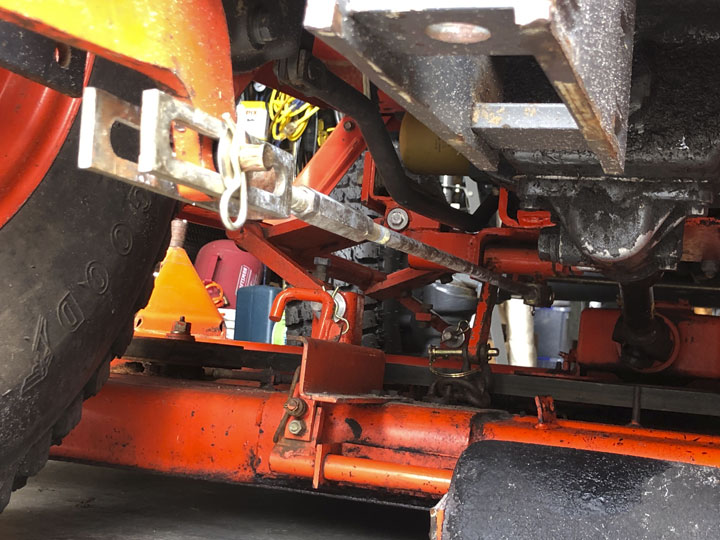

So something rather neat about this mid-mount mower deck, which when installed makes the tractor resemble nothing so much as a regular homeowner's lawn tractor (except in scale) are provisions to raise the deck and lock it in place. This leaves the 3-point hitch fully functional to use with implements like brush hog or finish deck, or what I have headed my way, a flail mower.
Means when the grass gets ahead of me for whatever reason, then simply raise and lock the mower deck, back up to the flail mower and connect to the 3-point, and go! Not having to first remove the mid-mount mower deck is HUGE for me.
This first photo is of the locking tabs, exactly as shown in the manual.
This simple and functional setup is a perfect example of the genius of Kubota's engineers. Raising the mower deck enough to lock it with the tabs proved easy enough using a Johnson bar for the last little bit. Maybe this can be done purely with the 3-point mechanism but with mine, after raising it, it needs to be lifted just that little bit more. Easy enough with the Johnson bar so I'm calling it good enough. Note; there's one of these tabs on each side at the forward scissor mount.

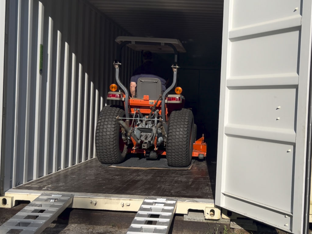

And with that, this thread comes to an end and the tractor moves from the shop to where it will live, within a shipping container. I purchased this expressly for the purpose of keeping this L3010 and the zero turn Jacobsen D417 because I prefer to these relatively dirty bits of kit other than within my workshop. And FWIW, this particular one has opening doors at the other end so I have a set of ramps there. also so I may drive straight through if it suits me.
