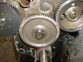

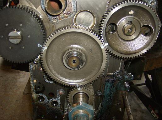

I'm taking apart the diesel motor in this L295DT - thinking the bottom end is needing some attention, and I find the gears out-of-time (marks not lining up).
Any ideas on how this happens, and what might be wrong?
Dave

Hi fj40dave.
Your timing hasn't slipped. The middle gear on that engine is simply an idler gear and as such is not a 2 to one ratio with the other gears. if you turn the engine over enough times it will probably all line up again or you can simply put the cam, injection pump and crankshaft so the marks on them are centered as well as possible on the center gear. then you can remove the center gear and put it on so the marks line up being careful to not move any of the other gears. if you count the teeth on the gears you will find the Cam and pump gears have twice as many teeth each than the crank gear. The center gear has some other number ( not sure if its more or less than 2 times but it certainly isn't two times!
Hope I explained this well enough!

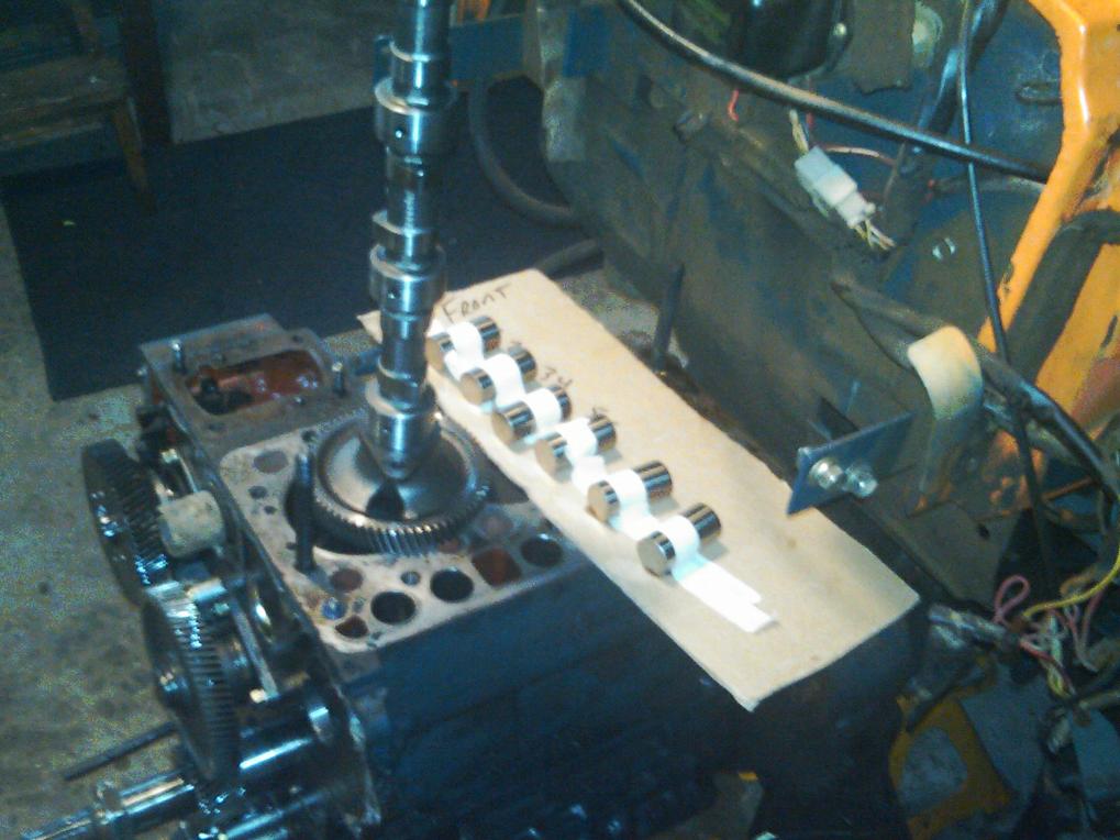

Got the cam out, and the lifters kept in order so they can go back in where they came from.
Mic'd the cam lobes:
1 = 33.325
2 = 33.452
3 = 33.337
4 = 33.362
5 = 33.401
6 = 33.375
My service manual doesn't have the spec's for the cam lobe wear - but they all are pretty close together, and the cam and lifters look fine, no scoring or gouges or heated up areas.
