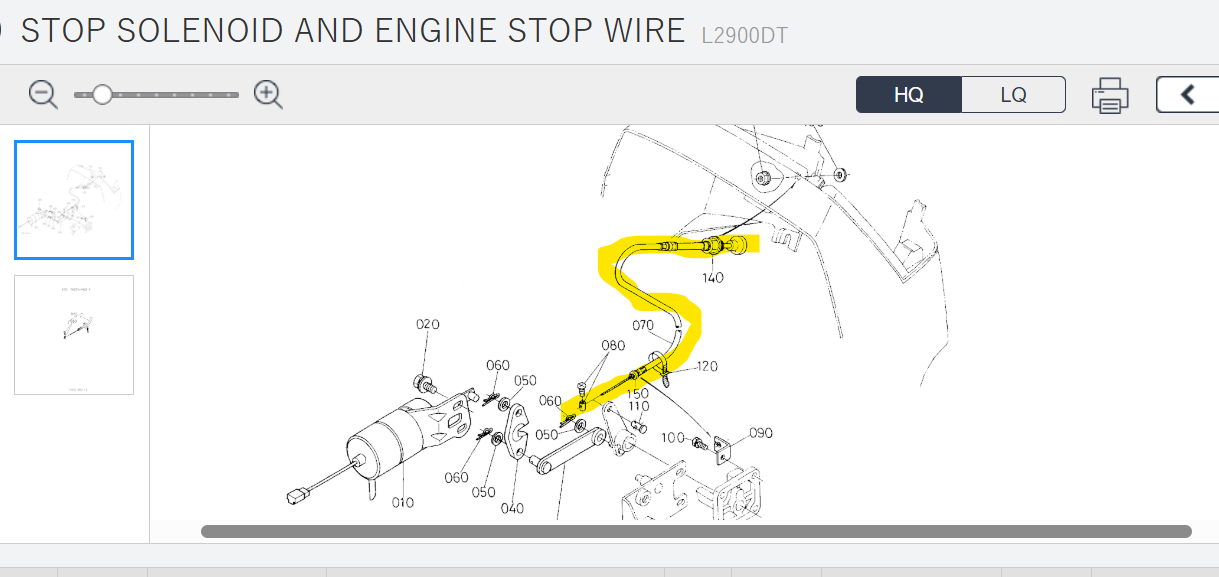

Make sure the stop cable is not engaged:
Bottom right under the dash.
If it's not engaged, then it's more likely a fuel delivery issue than anything else.
