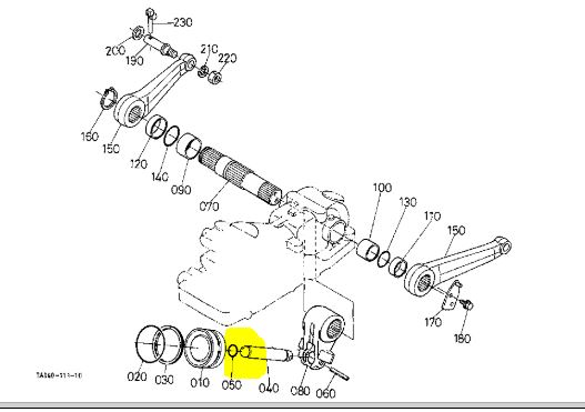

Lifting the arms does not move the hydraulic piston, the hydraulic piston is not physically attached to the push rod for the rock shaft. ;)
