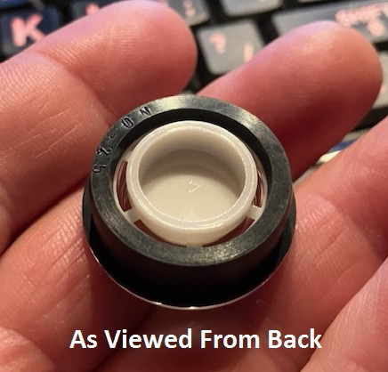

It should have a rubber/silicon seal around it, but I used a light coat of oil resistant automotive sealer around the seal before installing mine, just the same. (for L2350 shown)

Messick’s order arrived a day early. Pressed new glass in with thin coat of black ultra RTV. A bit of a challenge when it’s this cold, but by using a small pry bar backed with a rag, I was able to carefully press it in with no damage. All good, thanks for the help guys!
