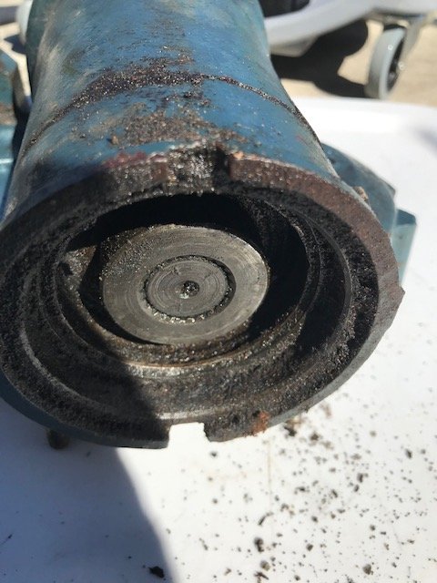

Bought an L2850DT tractor with a bad front axle making grinding noise from front right wheel.
Checked Oil in axle at front left wheel dip stick and found it empty.
Heavy Oil dried on outside right front axle housing.
Pulled front right "Front Axle" and both bearings and Bevel Gear look ok.
Metal shavings in lower front axle case with front axle case bevel gear worn at the bottom.
I Plan to pull the front axle case next.
How much slack should i have in the front axle case bevel gear shaft? It seems to have too much slack.

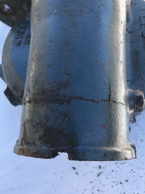

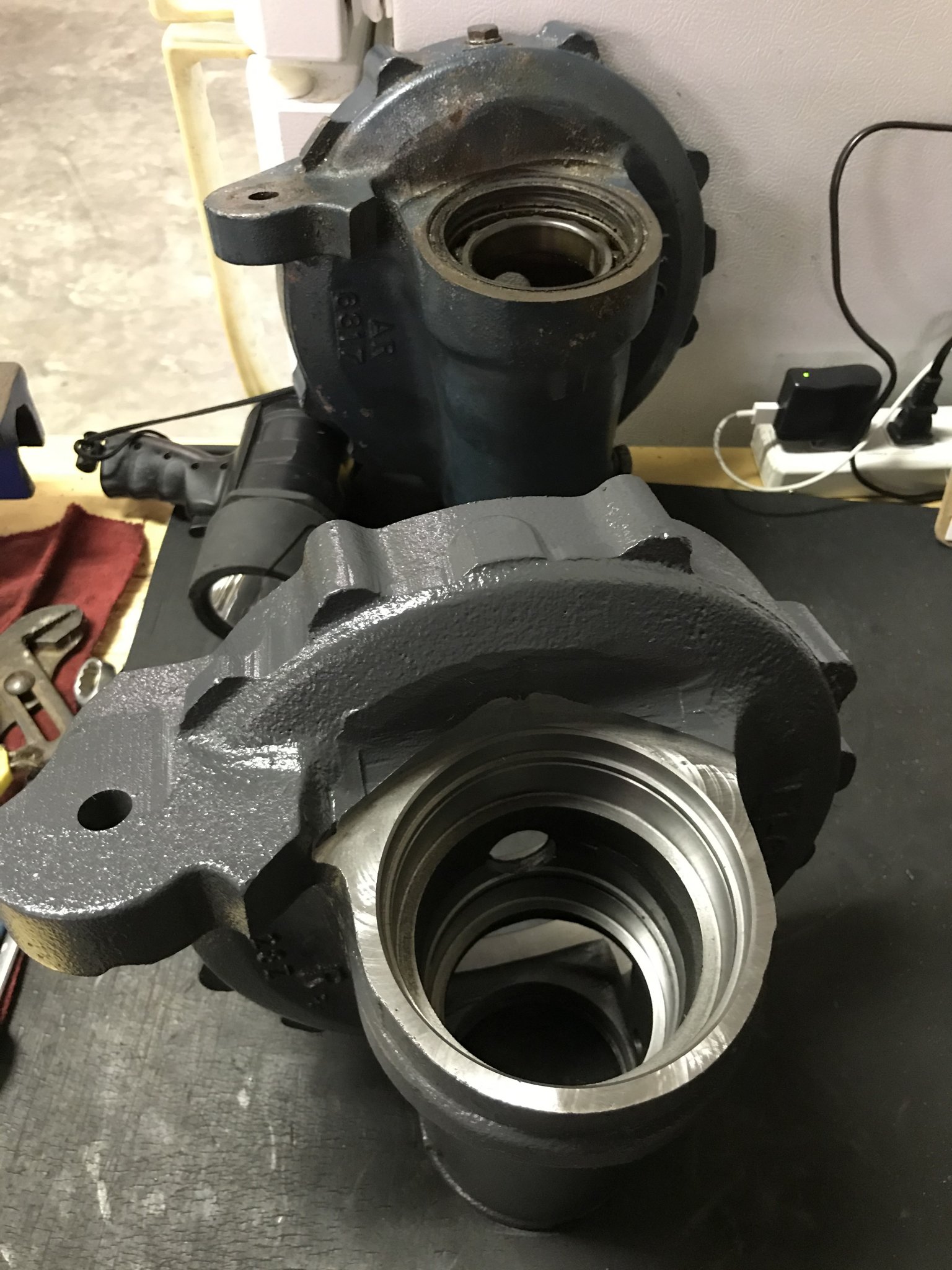

FYI... Found Lower Axle Bearing completely wore out/gutted which caused slack and the axle housing to wear and stress cracks to form as shown in picture attached.
I was lucky to find a new stock OEM Axle housing and rebuilt it with new oil seals and new bearings along with new c clips and thrust collars...
Changed both oil seals in other side axle also as preventative since appeared older with some sign of leaks. Hope this helps someone else!
