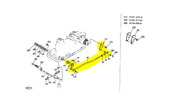

Hi Walt - here's a page from the WSM on troubleshooting. Most common problem is the o-ring in the main lift cylinder under the seat.
33,940
9,154
Usually when I hear" The three point suddenly quit working" it's associated with the feedback linkage, either damaged or disconnected.
