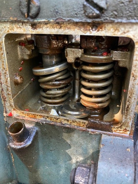

Thank you that helped a lot and I removed the cover and found a spring was broken. Looks like I have to find a pump or a rebuilder.

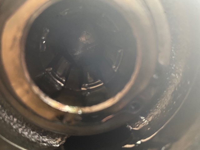

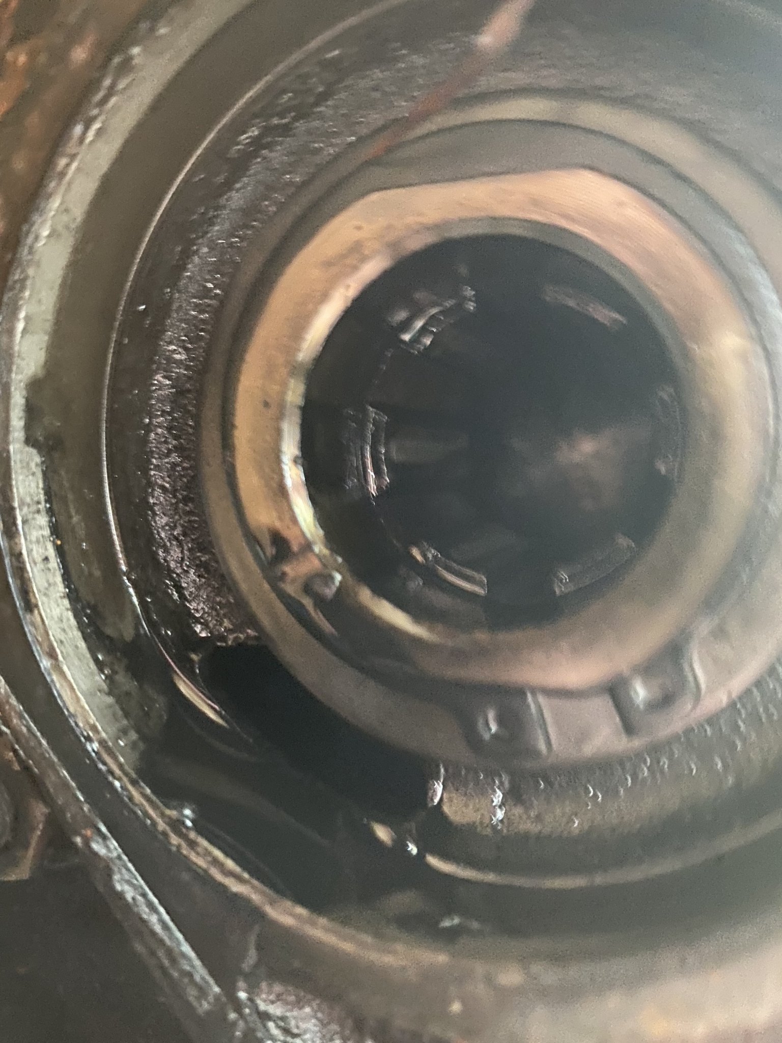

The pump is getting rebuilt locally and the price is between 900 and 1000. I pulled it out and ran it right over the rebuilder. Now I am looking at the drive gear where the pump goes into and the splines look to be spaced equally so I am a little confused on how it could be in time. Any idea if there is a difference in the spacing or a way to identify a locator notch?
Can you do a few more pictures with more light of both sides?
Gear pic 3.jpg Gear pic 1.jpg View attachment 67174
When you say both sides do you mean the shaft and the gear? The pump is still at the rebuilder so I cannot. The gear pic was the best of the three I took but here are View attachment 67174

the others. View attachment 67174
When you say both sides are you meaning the pump side? It is still at the rebuilder so I do not have that to show but here are the other pics of the gear I took
29,004
5,337
The bottom right key is wider than the rest, it is the master, i think you'll find that the pump will only fit one way no matter what you try.

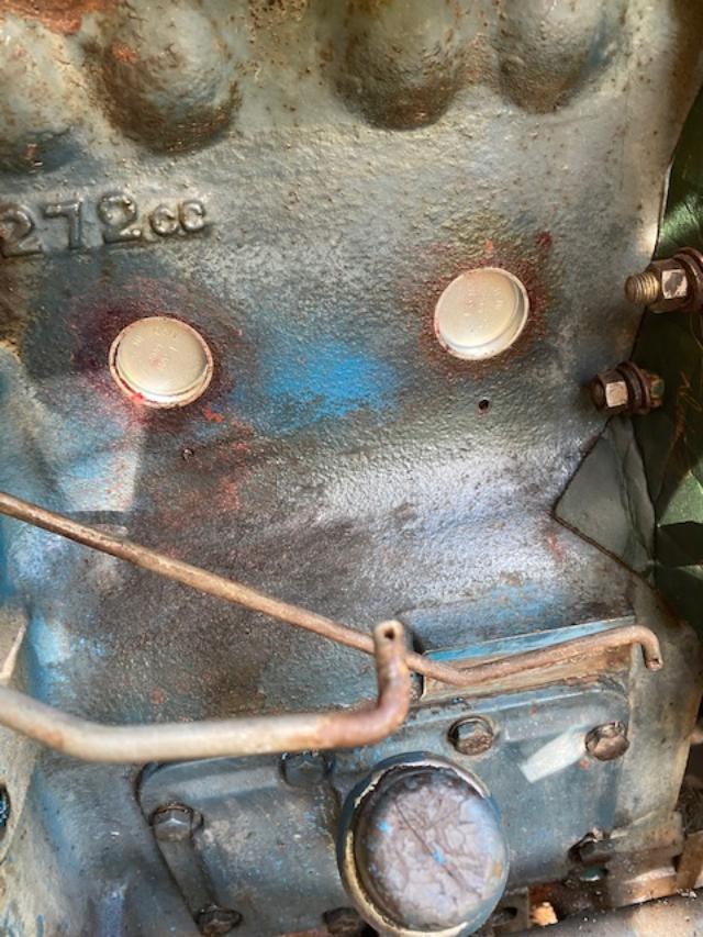

Thank you I expected something more obvious. I am still waiting on the pump to be rebuilt. While I had the pump out I thought it would be a good time to replace the two freeze (expansion) plugs on that side. I have removed them but the 35.2mm plugs I bought don’t fit. I measured the old ones they are 33.9mm but I can’t find that size. Any suggestions?
I looked up the plugs I think your looking to replace and they are available from Kubota directly.
Check the parts diagram on Kubota's site and confirm, or post a picture of their location and I'll give you the new Part Number.

My local Kubota dealer was not much help. I was able to locate expansion plugs that are 34.925mm and they worked great. Napa has steel 381-3080 or brass 381-9008. Pump is not back from being rebuilt so was easy access. (hope this helps someone else)
