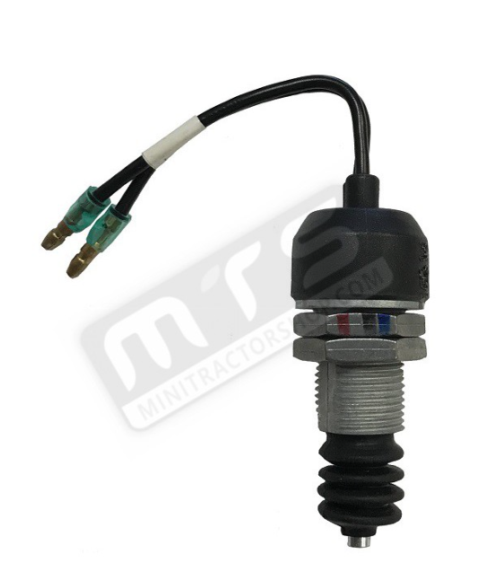

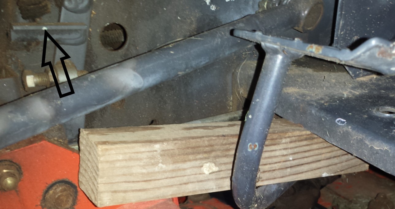

On your left side as you sit on the tractor - the clutch is at the left foot.
Use you hand to push down the clutch and watch the mechanical movement in the linkage. The should be a "button" that the linkage hits and pushes. This is the "clutch safety switch"
The switch looks like this :
Here is where it is located on the side of the tractor

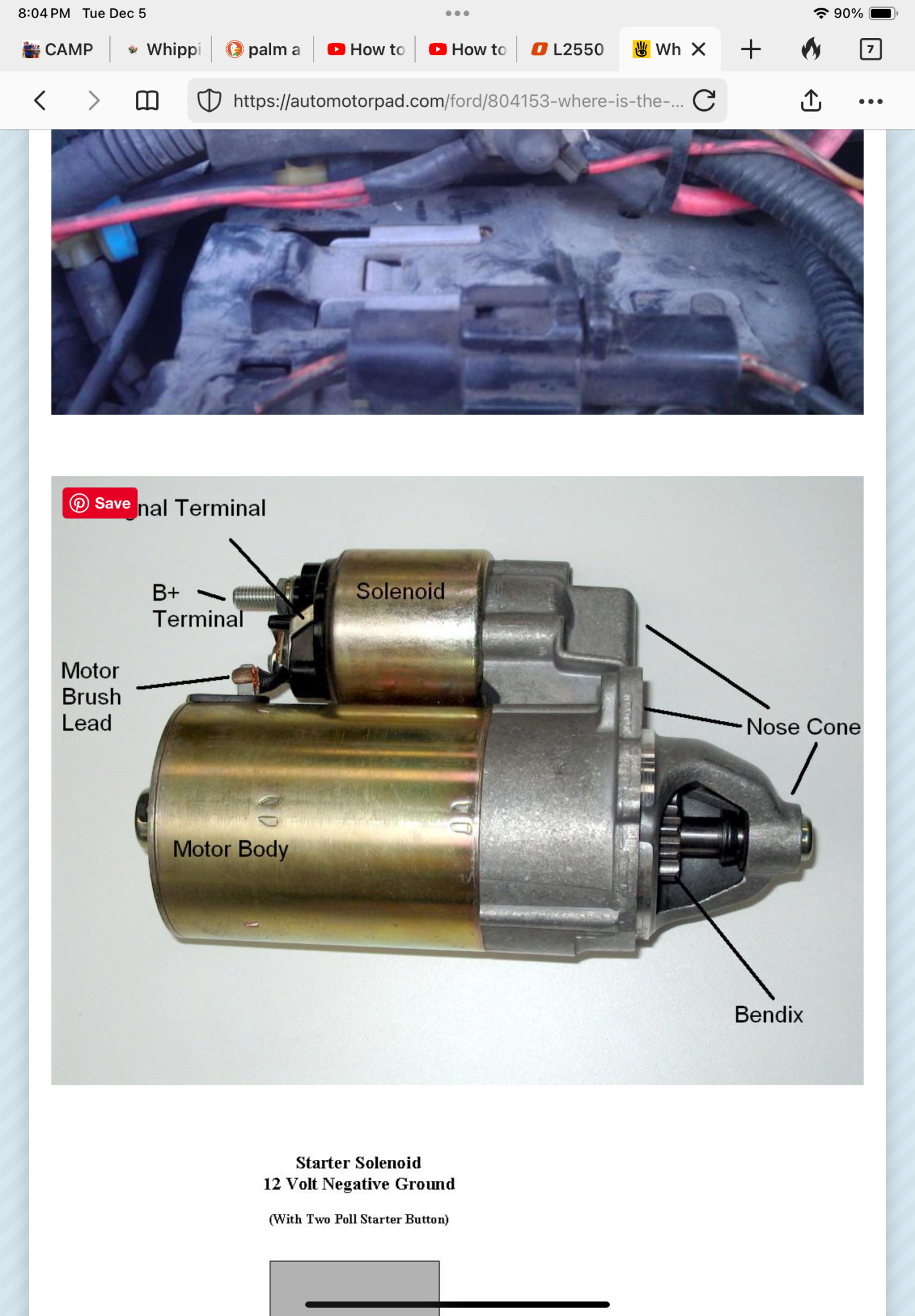

Is that the solenoid in the starter?

I located the switch, and I adjusted it down to touch the actuating tab and a little more. Depressing the clutch actually now moves the switch a little so I am pretty sure it is being pressed to its limit. Still no turn-over of the engine. Is the switch itself likely to be bad? I can hear it click when I push the button up and down by hand.
TAKE the two leads OFF the switch ..... connect them and then turn the key (make sure you are IN NEUTRAL!)
See if that makes any difference
Not really IN but ON the starter. See picture
or you might want to look at this site
I think all Kubotas have the solenoid on the starter but other vehicles (Fords…) have a separate solenoid that is often mounted on the side of the engine bay
Thanks for the help. Later today I am going to hotwire it as suggested by Hokie and try that.
