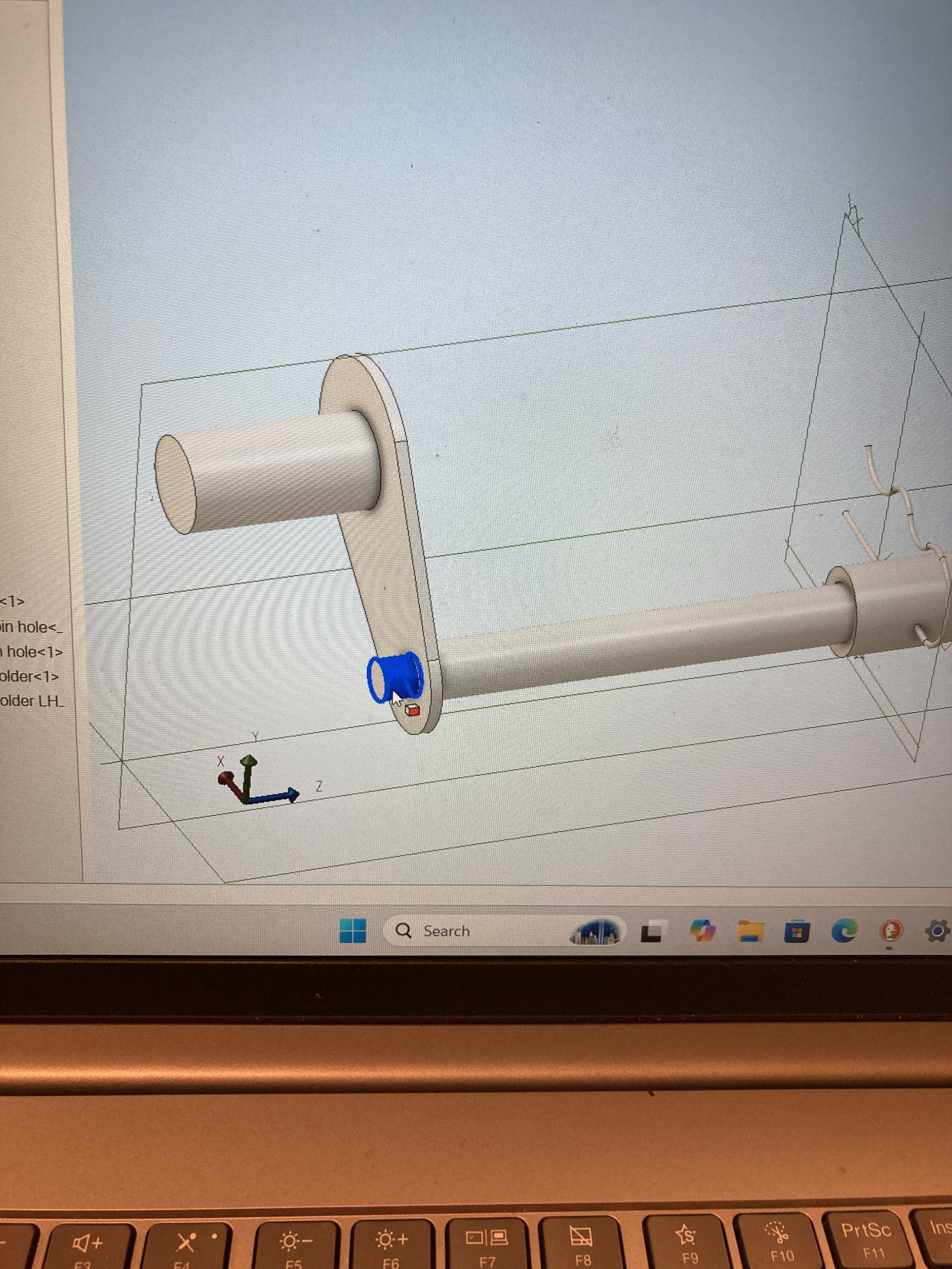

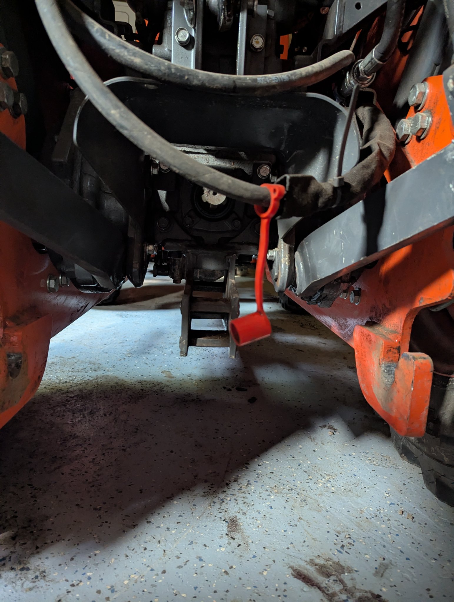

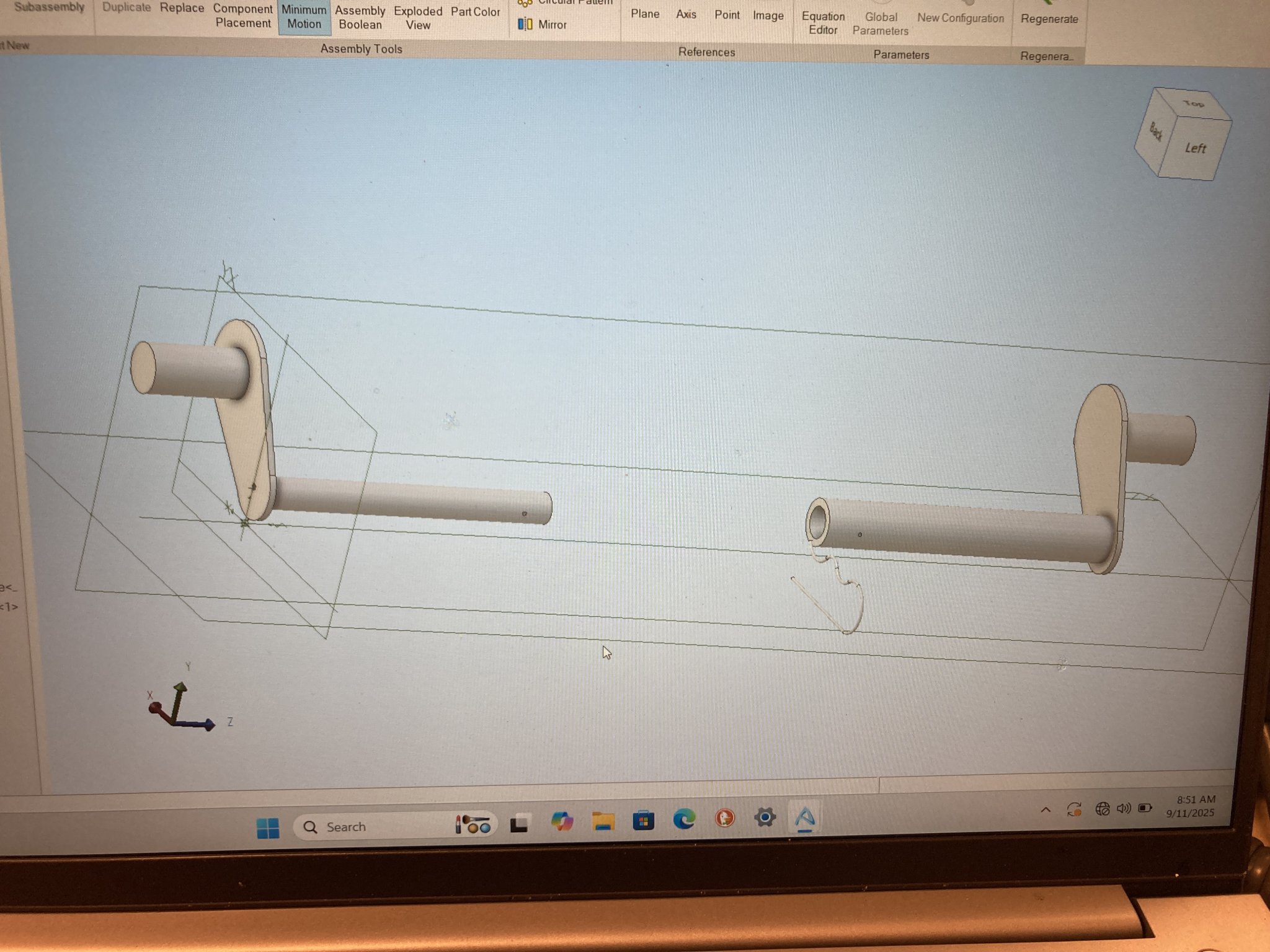

There will be the pto and the hitch in the way. But that can be solved easily. I might try something today after work 1000009219.jpg

Is this “more or less” what we are talking about?

exactly. but I wanna keep my original pegs in case I need to revert back. A new set is 50$ CAD.
So I might just make my own with steel rods and square tubing.
That's cool by the way. those drawings are nice.

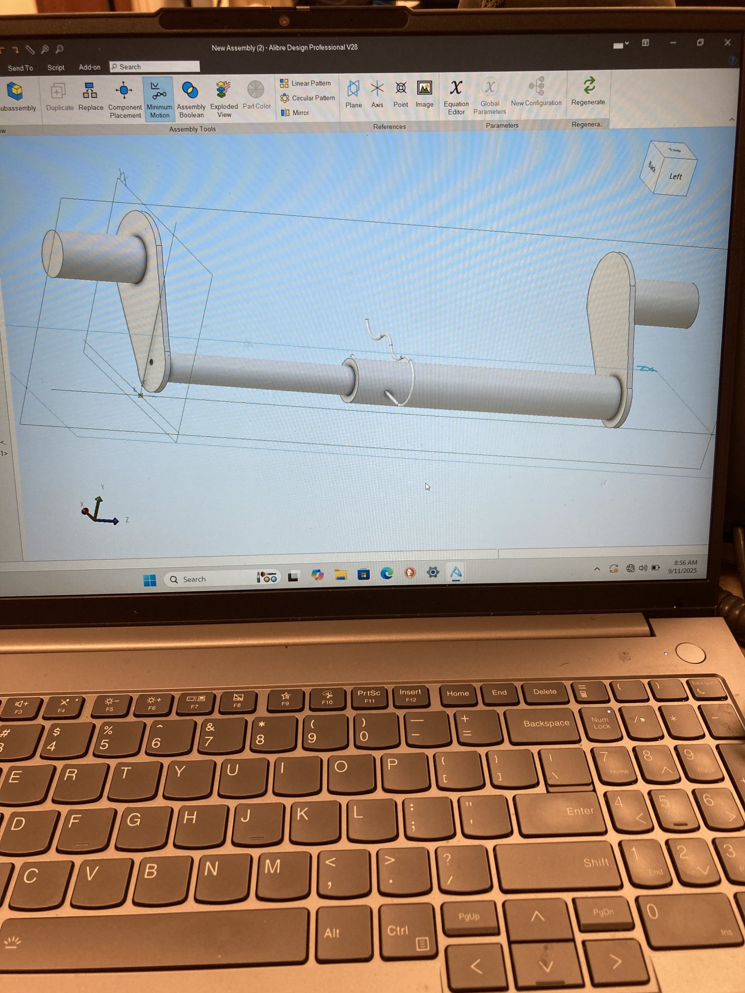

I think if you used some “cap screws” to attach the pin plates to the rods/bars (instead of welding them) you might be able to use your current ones, without ruining them.
Possibly saving 50 bones.
Just a thought.
3,942
5,311
Kind of like this.
By tapping the solid rod and securing it with something like a “cap screw” , I think 2 things will/might happen
1. You could save your originals
2. It might be possible to make it so that the head of the fastener goes into the existing bolt hole and acts as some sort of “locating pin”( purple headed thing)…This would of course have to be some “custom” fastener though…..

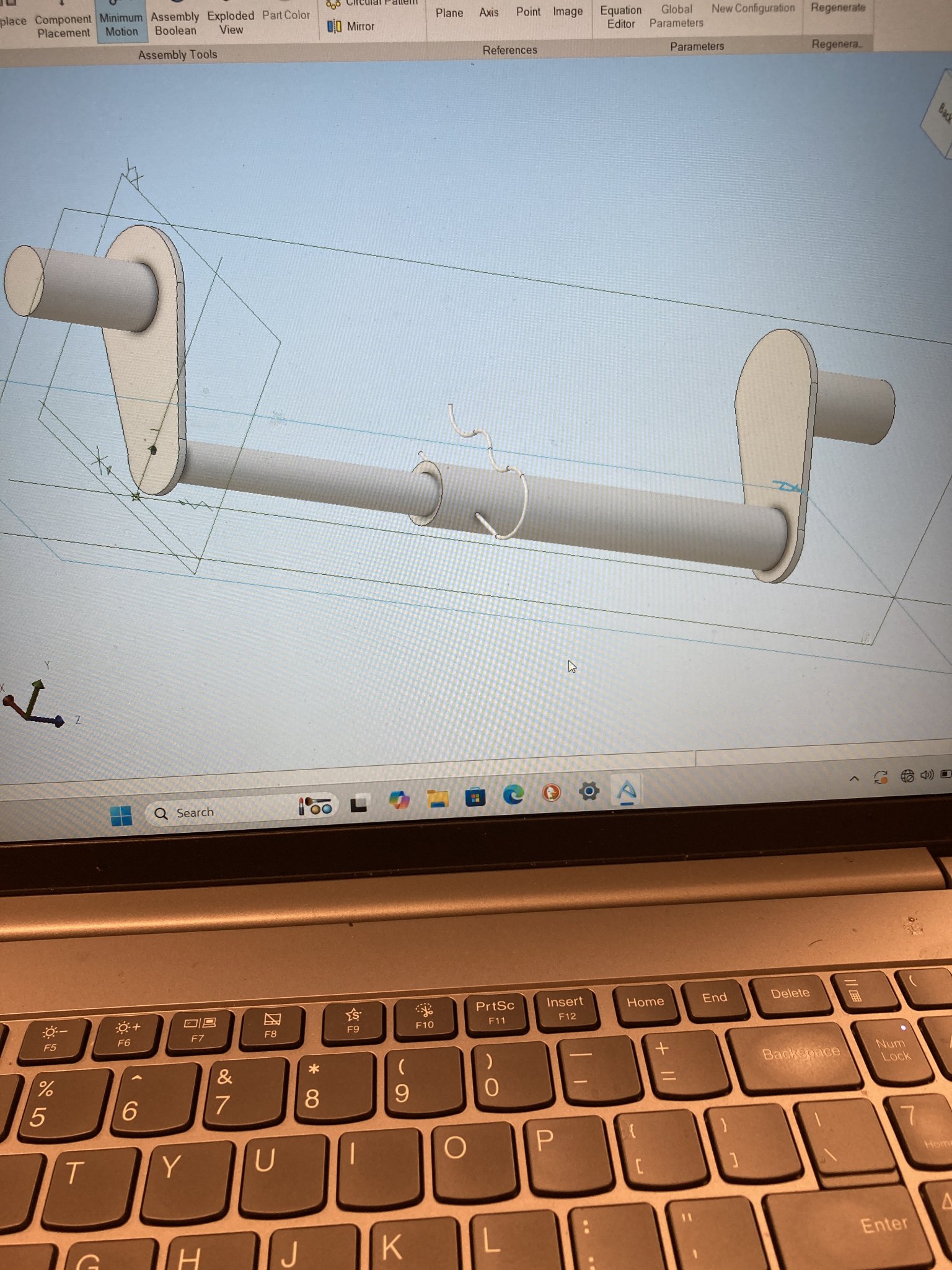

The caps wont work because no matter the rotation, the hole is blocked by the casing of the tractor.
I tried doing a very rough prototype. There is little room to slide and extend. Also, it would need to be welded very precisely, otherwise it doesn't slide if there is the slighest angle

Looks like it certainly has a shot at working.
I am presuming it will be “easiest” to drill the “hair pin” hole when they are installed.
Keep us updated please.

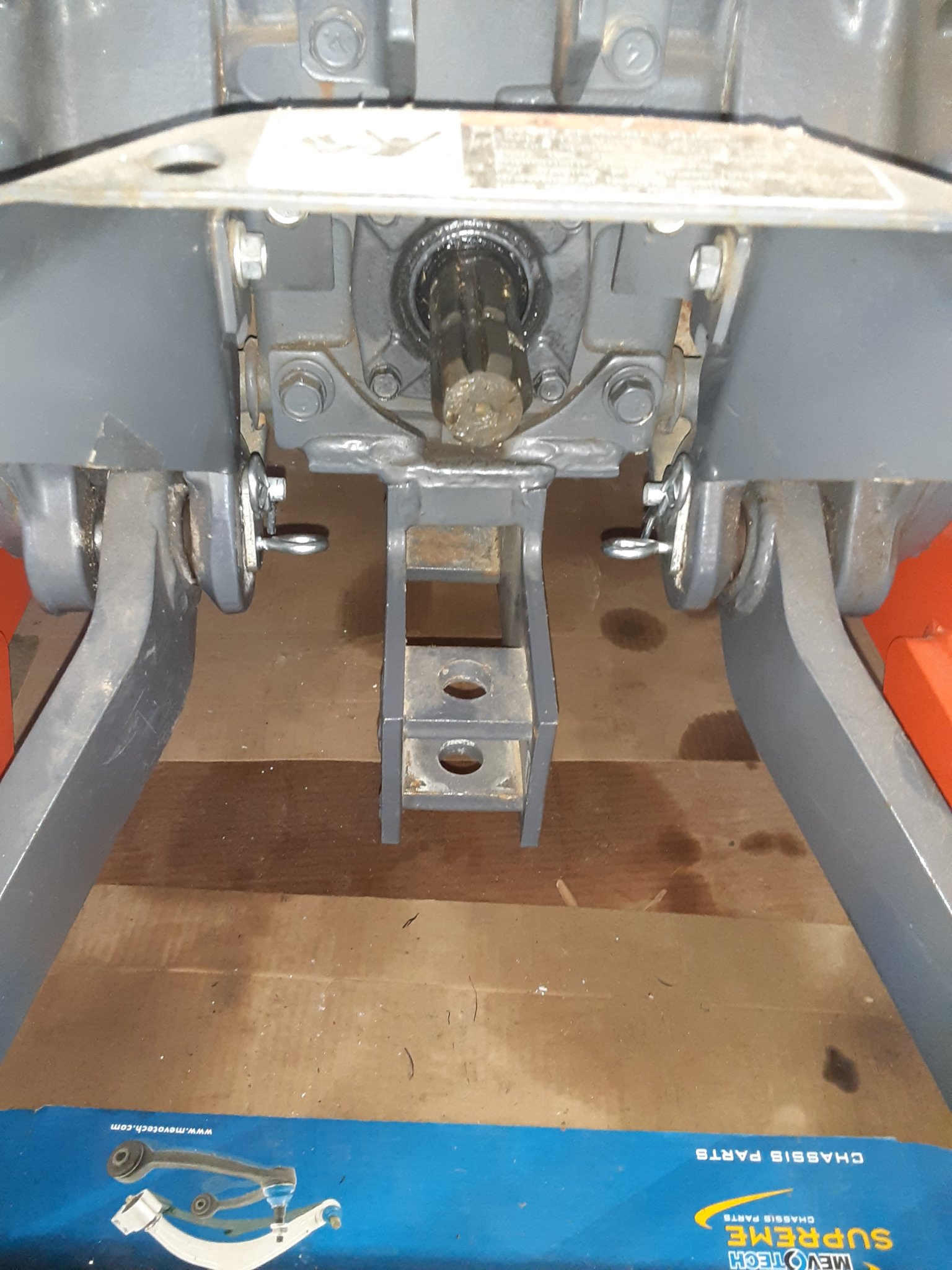

Gonna try this out it the field today with my blade.
I left the bolts in just to protect the threads, but they are not holding anything.
If that works, then it should be a quick and easy solution

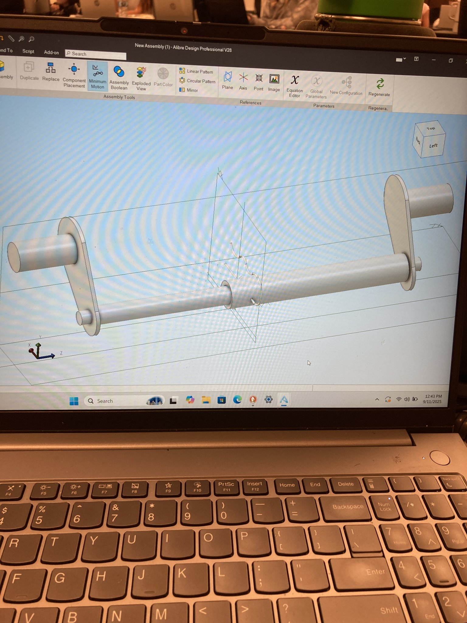

Interesting. I'll have to consider this then. I'll update my design

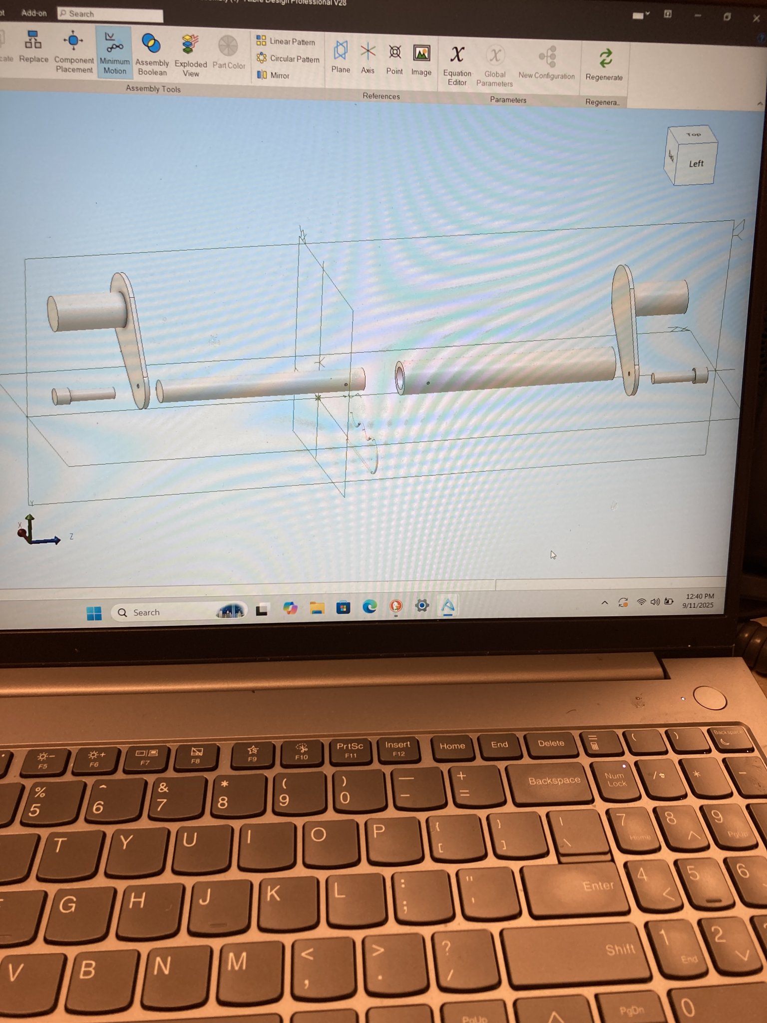

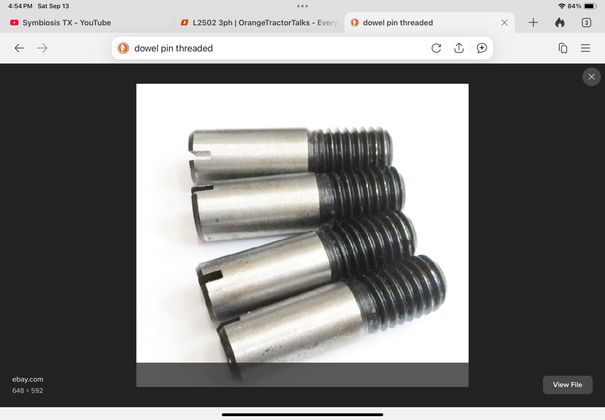

You can just install studs in the threaded holes and let the pins slip over the stud/dowel.
I would use this style
Actually you could just use these with a hole in them and a cross pin to hold your large pins in.

I’m gonna try some sort of “adaptation” of this design too.
@Russell King those studs are a fantasic idea in order to prevent the spinning.

I looked at the bolts in there now, I believe they are 10mm-1.25. with 13 mm of thread.
Kind of an odd one. I searched mcmaster, grainger, global and fastenal. And of course ebay and bolt suppliers there. There are a few studs with that thread but not much with a smooth area.
I think it was fastenal that had a stud with a hole and a clip thru like I mentioned but it was in 10mm-1.5.
They did have some choices of bolts, some gold ones medium strength, 45mm long, about $2 each. that I think I could make pins from.
I tried and thought I set up an online personal account but couldn't get my cart to check out.
Thought too of trying the the 10mm-1.5studs and see if you could start a die on the course thread and get to the smooth area to make the 1.25 then cut off the crappy thread. I could try that idea with bolts if I have a die but haven't checked that yet.
Just spit balling here!
