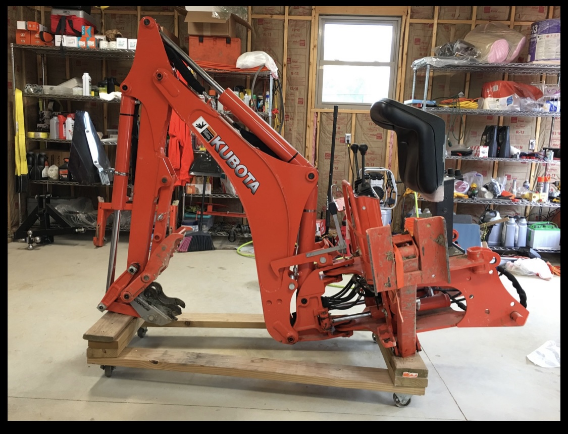

Plan on making one of these dolly’s for moving it around in your garage any time you want to have it off. Really makes it easy to go back and forth.
Of course these days that’s likely $800 in scrap lumber. 🤣

Really like the dolly fab. Just curious, why do you take off the bucket and do you think it would work w/ bucket on with some mods?

With two separate dollies like that, do you find droop where the arm moves away from the base? Do you need a strop around the bucket and arm to stop that?
No.
It doesn't move at all. I think because the hoe frame is on two supports it really can't go anywhere? I don't really know, but it will stay in that position over the entire winter.

Curious, what is the weight rating on those casters? Where to buy locally, like Tractor Supply, maybe?
Got mine off Amazon. I put two swivels at the rear end of the dolly and two rigid ones at the seat end.

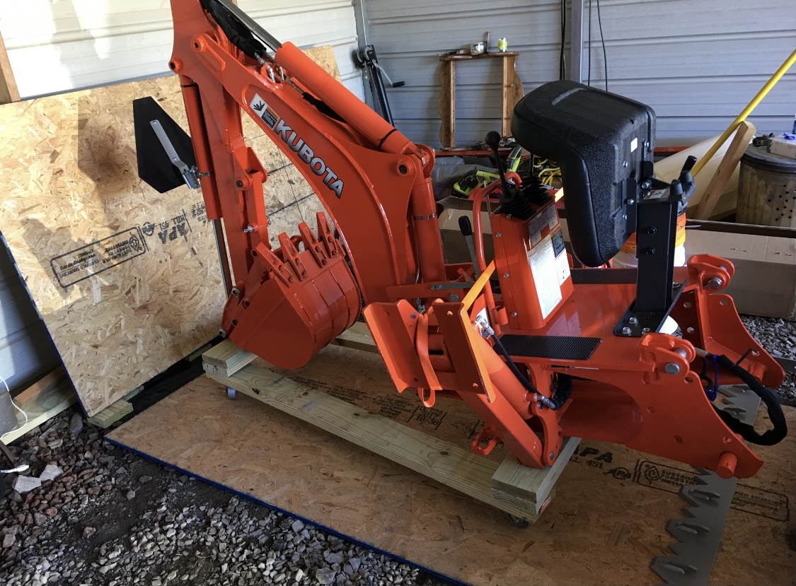

As far as working with the bucket on, that was the original way I used it. Then I ordered a trencher bucket along with that quick-change adapter so I decided to add that one extra piece of board to the top of the back end, so I now keep the buckets themselves separate.
Here was the original dolly before adding the other stuff (and before my garage😁)
