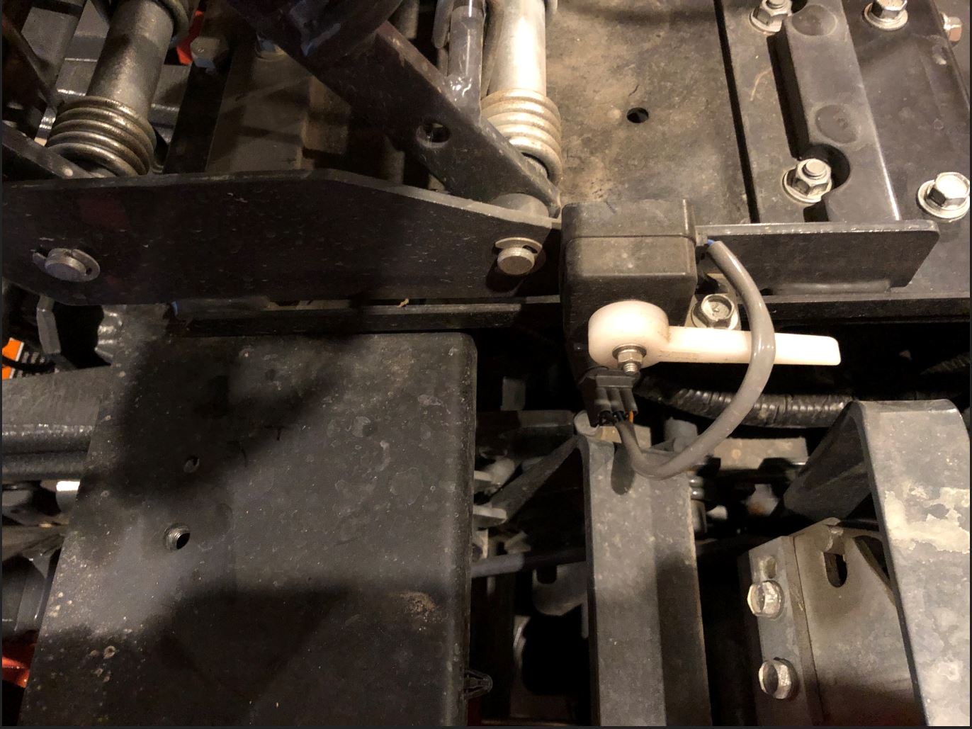

Can you post a photo of how you tied it?
Sorry for the delay
The arrow is pointing to zip tie around the white toggle helping to hold it in the down position. That is what tells the tractor if there is an operator in the seat. I also pulled a wire harness over the toggle as well.

Could it be the operator presence switch? It only seems to occur when I am leaning to the right trying to see what I'm doing with the bucket or forks, sometimes the tractor will act like its gonna stall or turn off then when I move back and sit normal it continues to run.
Starting to think me being 160lbs isn't heavy enough for the seat lol. But it's really annoying.
Has this happened to you? Is it the safety switch or something else? Any ideas would be helpful.
I weigh about the same, had the same problem. I didn't defeat the switch but I put a piece of rubber air hose tubing over the lever of it so it was pushed down just a little more. I think with the switch on mine it was 1/4 id tubing but may have been bigger.
Not in front of me and nasty cold out to go look and take a picture.
It has worked for me for 3 years now.

Here is my simple seat switch mod. It measured close to a 3/8 ID tube.
It sticks out a little too so it contacts the metal tab sooner.
