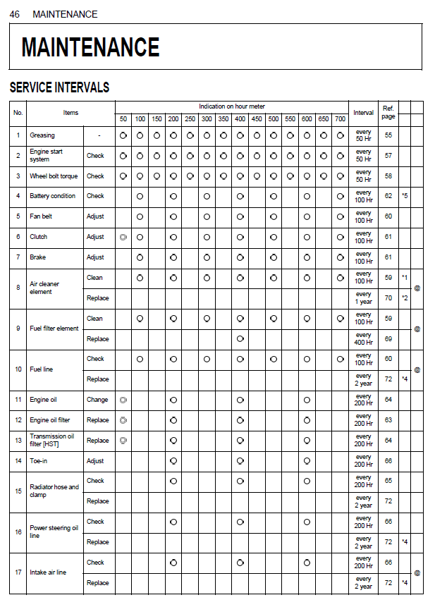

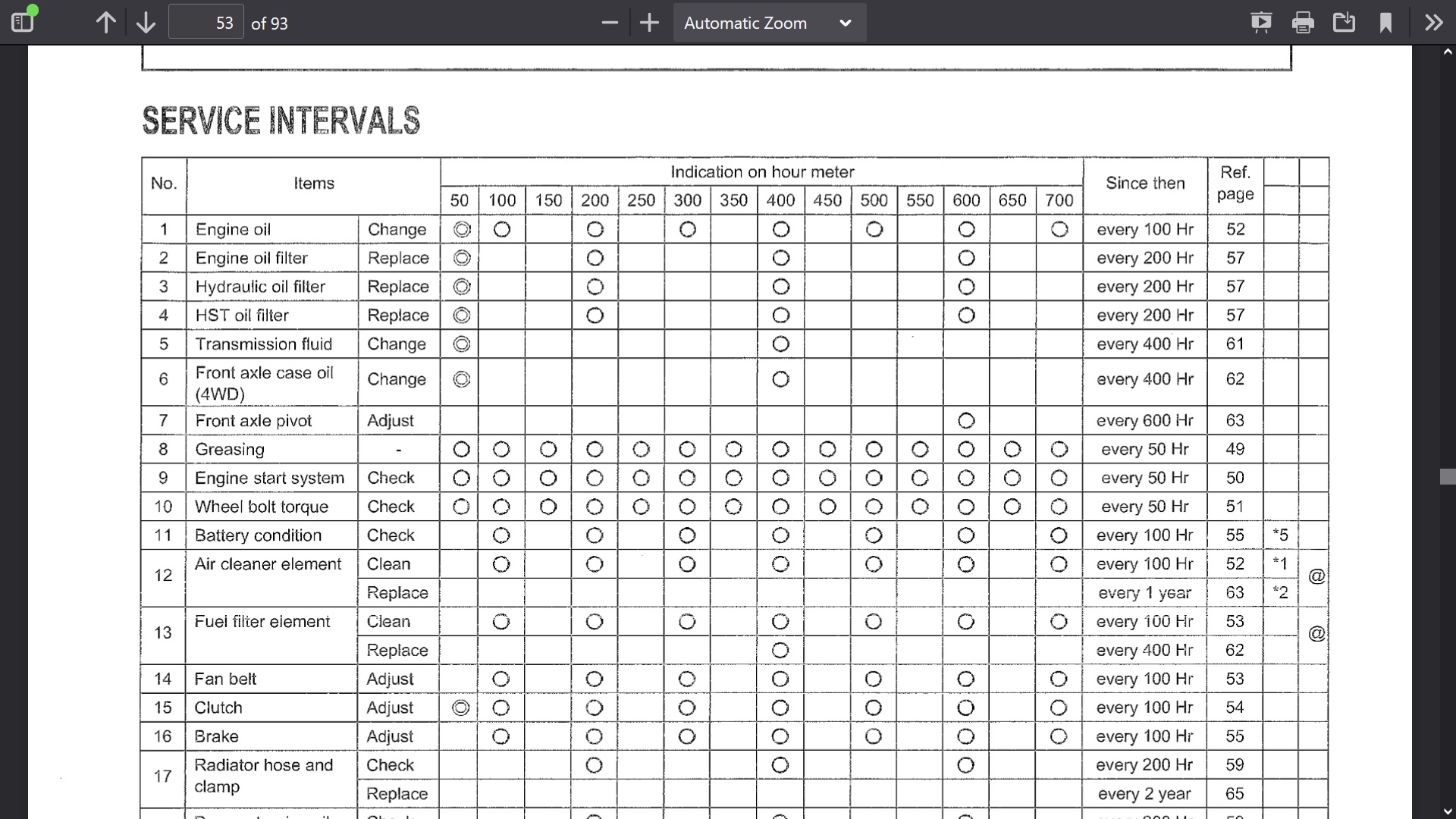

I downloaded an electronic copy of the operators manual. It says to change the oil at 200 hours. I've done all of the service except the oil change when I noticed my paper manual says I don't have to change the oil until 400 hours. Have any of you noticed this discrepancy?
I realize an extra oil change won't hurt anything. I'm just curious what you all I've done.

My paper and electronic both say 400 hours.
At my current rate of 50 hours per year that means 7-1/2 years 'til the second oil change.
I'll probably let it go to 150 hours for the second change, then maybe every 2 years.
It only takes 5L of oil.
If you let a car go 400 hours at 100KPH that would be 40,000Km.
Seems wrong.
