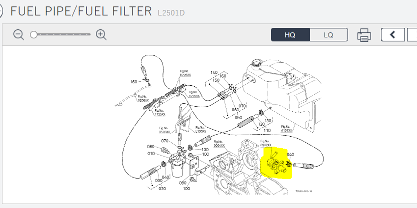

Remove the lines from the fuel pump. Plug the line coming from the tank so you don't lose fuel. Put your finger over the inlet side of the fuel pump. Crank the engine. Fuel pump should create a vacuum and hold. If it does not the fuel pump is bad. I have replaced a lot of fuel pumps on these machines where the check valves inside of the pump pop out. Have the same symptoms you're talking about. It's a quick easy test.
How do you get the top bolt out of the lift pump? Is that a power steering line that has to be removed? Thanks. Have the same symptoms.
My issue was not the lift pump. It was the small fuel pump behind the fuel filter/ws housing.

I would examine a fuel sample in a clear jar and if it looks ok , just replace the lift pump. Took me about an hour and the average owner can probably do it. Our old Ford 1700 25 hp has been running on the same fuel without issue so I replaced the lift pump and it runs like new.

I know this is an old post, but I'm having the same issue. Ive replaced the lift pump already. Was the bad pump on your tractor the lift pump or the injector pump?
mikeyt's problem was the lift pump. Remove the hose from the separator at the lift pump. If you don't get a full flow, you have a blockage somewhere between the tank and the pump. Have you checked for water in the separator? What exactly are your symptoms?
