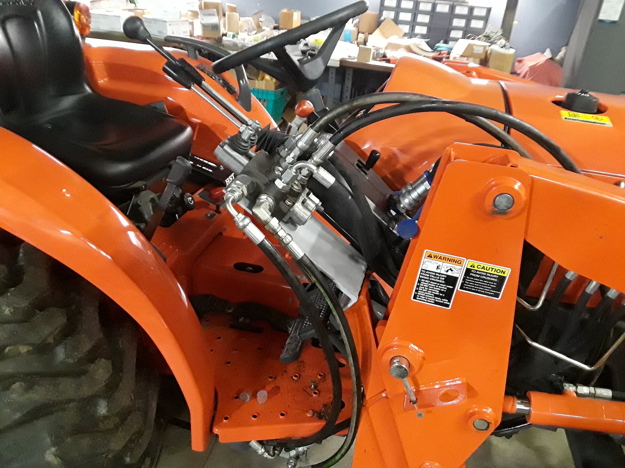

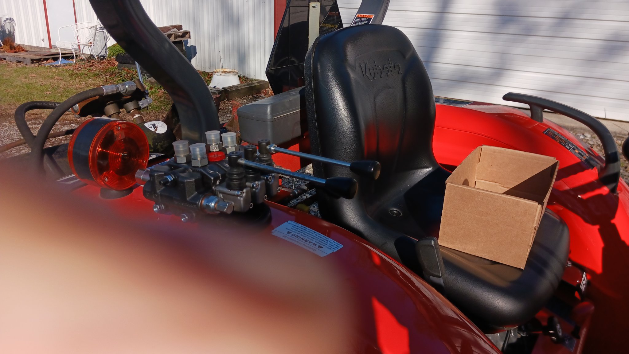

Close but no banana. You can lash something along those lines together that will work but its not according to Hydraulic Hoyle. Here is the correct plumbing and how Kubota does it with the factory remotes:
  1. Purchase the power beyond sleeve for that valve and install it in the N port
  2. Remove the hose that is currently connected to the backhoe quick connect from the coupler but leave the coupler in place. Now connect that hose to the P port on the new valve.
  3. Next use a new hose to connect the N port on the new valve to the quick connect for the backhoe
  4. Run a second new hose from the T port on the new valve back to tank. There are a couple ways to to do that but I will leave that for follow up
Your new valve is now fully functional and totally independent of the backhoe, its a permanent part of the tractor, and your backhoe works just as it always did.
I just put together a nearly identical paackage for a man eith sn older L and backhoe. The only difference is tge valve was mounted on the loader post (see top picture)
I am currently doibg one with the valve on the fender (second picture)

I think I'm following what you're saying. My question would be when the backhoe is disconnected (which is about 80% of the time) how will I make the valve still function so that I can operate implements on the three-point? As far as"return to tank" how do you usually go about that? I've never done tractor hydraulics before. Is there a plug someplace I can remove that is a common place? Sorry to be a pain this is all brand new to me. Thank you very much.
8,736
4,477
You take the backhoe off just as you do now. Plumbed this way the valve dont know or care if its there or not.
Tank return is typically done by adding a tee on the hydraulic outlet block under the right floorboard. However I will be making some adapter plates for the OEM return port under the seat. Lot closer and gives you a neater installation.

You are welcome and one more conment. You will probably find the hose going to your backhoe is not long enough to reach your new valve. The end fitting on that hose is a JIC-8 female swivel and you can extend it with a JIC-8 male union and a short 3/8" hose with JIC-8 female swivel ends.
