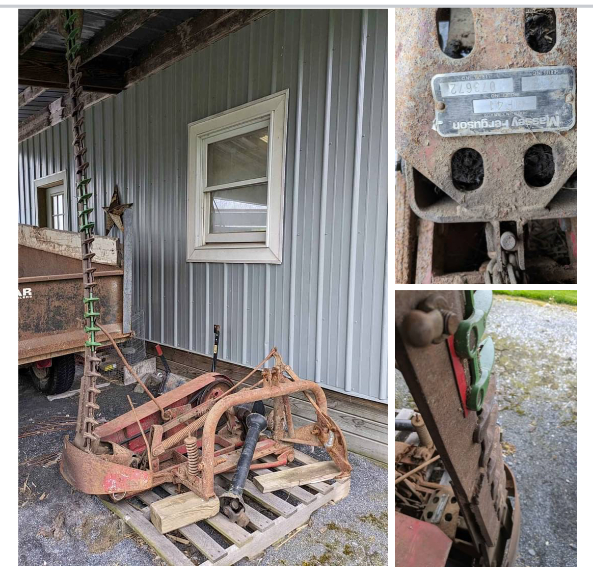

Looking at the pictures you posted, the cutter bar looks bent where it was welded up. I would not buy it. Bent cutter bar will not work well and will be very hard to remove the sickle bar, plus the sickle bar will not move very easily. I would keep looking for another mower. Yes your tractor will run one, because they don’t take much power to run.

I'd have to see it work with that bent bar before I'd buy it. I doubt it would work well at all. And even then, I'd probably pass on it.

hmm, looked at pix(well, copied then ZOOOOMED up...) . IF you get it for scrap price,say $100-200 AND you proper;y repair it, it'd be a 'good deal'.
Obviously sat outside rusting away. Maybe the bend is less due to camera angle ?
I don't know IF you could add a wheel at the end, seems like a bad idea though maybe check online to see if anyone offered it as an option ?

Thanks for the replies, i was going to reweld the patch and make it “straighter” if purchased but they sold this morning so theres that too, oh well. I work machinery repair so have access to a lot of steel and
