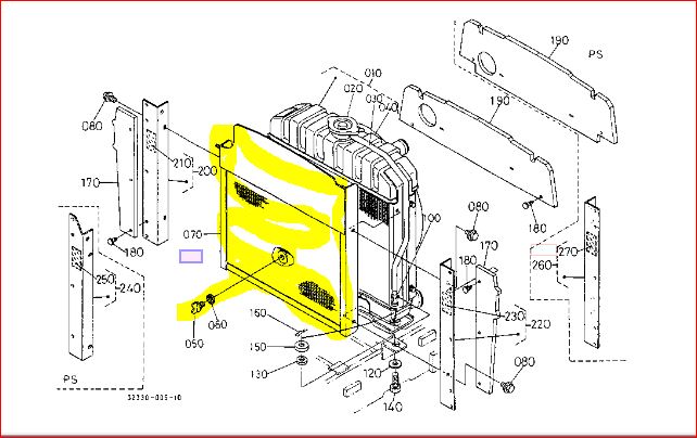

Second what Bulldog said,
First pull the radiator net clean it and then, back flush the outside fins of the radiator with a garden hose, from the fan side.

You also should not have much actual dirt in your radiator on an L series. It's way back in there and you should be cleaning it like this REGULARLY.
There is almost no heat overhead available on an L series so you don't have much leeway between normal operations and an overheat condition. That gauge can go from normal temp to max in under a minute if you're working the engine, especially while mowing.
I religiously blow out the radiator every morning before operations and before I fire it up again after lunch if I'm mowing. This has kept my L series down in normal temps the entire time I've used it since my near overheat.
