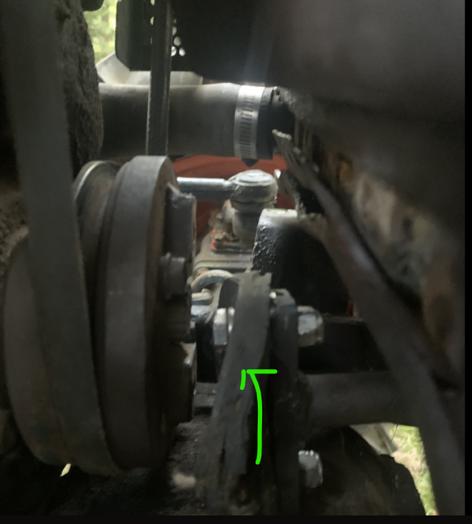

There were mutiple versions of the front drive systems.
There are also cranks with long and short crank end splines.
Your joint and connection is a flex disc design green arrow is the flex disk, or rag joint.
It's a reinforced rubber joint. that connect the pump drive shaft to the crank.
The flex joint attaches to the adapter on the front of the pulley via 2 bolts, yellow arrows.
If you need help sourcing the flex disk just ask I might be able to find it or if you give me specs on the original I can make you a new one.

Thank you the first disc that was on there did not last a half hour of use so I replaced it with heavy mining belt it did the same thing

I did not put a new disk on yet. I think that is a bad set up and I think it will keep happening. I would like to try something different. As far as the deadhead goes, I took the acorn nut off of the control valve, and there was a piece in their lodged, blocking the flow

I assume that setup was working fine before the deadhead problem. That just caused the coupling to fail due to the excessive amount of torque the pump was needing. The coupling failure actually saved the pump from failing.
But you certainly have some options that you may want to take. You can replace the flexible disk (there may be some commercially available parts but I can’t locate them easily), you can add some other machined shafts with a different type of coupling between the pump and crankshaft, or switch to the tractor hydraulic system.
If you do the last you will need to replace the current hoses with hoses routed to the tractor sump instead of the current sump on the FEL. I think I would cap off the FEL sump and keep it full of some sort of oil to keep rust from forming on the interior walls. There are some oils that off gas and coat the walls, I recall them being called triple phase oils.
You may need to add a tank return line or move it also. I think I can see a pipe elbow and a hose clamp on your FEL valve that I assume is a tank return line.

I appreciate all the help from you guys. i’m still a novice at wrenching on equipment. If there is a different system that works better. I’m willing to try it. I don’t mind the shaft. I just think it is gonna break again. Let me know what you guys think. Thanks.

I'm pretty hard-headed, so I'd try to make the existing system work. After all, a similar system works on my L35. As @North Idaho Wolfman says, you might want to use something other than the rubber. At ~3000 rpm I'd be concerned about the shaft whipping and the rubber being too soft to restrain it. The L35 uses thin fiberglas disks. Thin steel disks, think shim stock, is used on commercial couplings, several pieces clamped together.
First, check the alignment of the crankshaft and pump shaft. Has something maybe cocked the pump relative to the crank? Is the length such that it doesn't put too much tension or compression on the disks?
Consider a filter or strainer on the tank outlet/pump suction, especially since you've had a prior problem. Filters are available at TSC et al; they are usually used on the tank return, but I think one would work on the pump suction like Kubota does.
