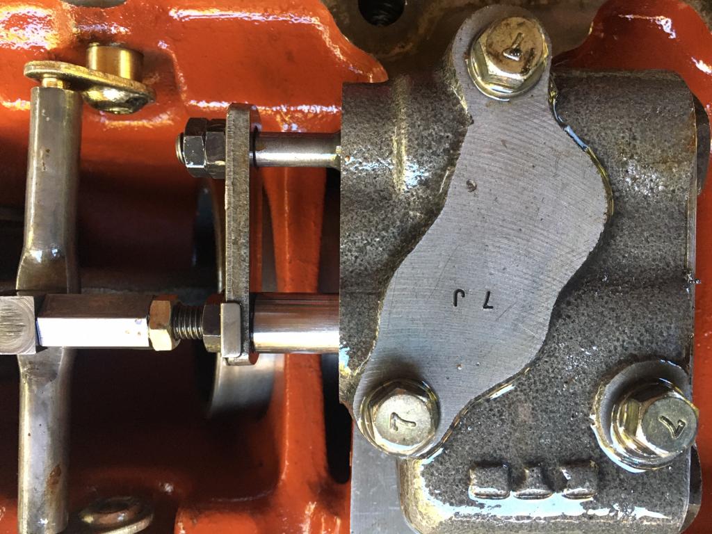

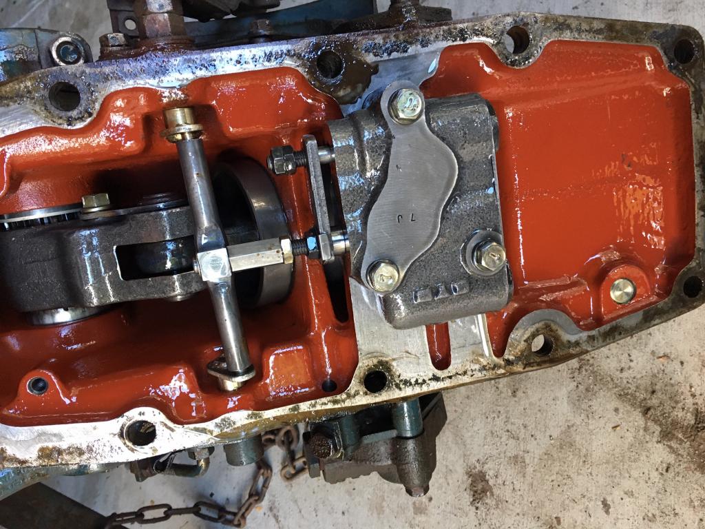

Okay, my assumption that the lever spool drive that had come off before had come off again was wrong! I removed the rock housing cover, flipped it over, and the position control valve and all the spool levers were in the proper places. But as I was taking it apart I realized that the 3pt arms had no tension on them... and the piston wasn't falling back to it's lowest position inside the cylinder. I took the cylinder cover off and everything inside looks pretty good. The cylinder and piston are both smooth, unworn, and no rust, but the piston was stuck at the top of the cylinder. So... I guess maybe the position control valve has somehow failed.
I'm going to study the WSM and search this site and try and figure that out. It seems like there's a thousand threads labeled "3pt failure" and at least a hundred that are specific to my tractor or its immediate family.

The feedback control arm is working properly although it's possible it had something to do with the original problem. I pulled off the relief valve and it's clear and oil is flowing. The supply line from the pump is flowing as well (and the FEL is working properly so the pump is good). So, I'm thinking it's the Position Control Valve, which looks okay but might have failed or have an obstruction.
But there's something I don't understand: where does the Pos Control valve get it's oil? And when the valve is opened to flow oil how does the oil get to the cylinder in order to drive the piston to operate the arms? There are no hoses that I can see nor are there any on the diagrams in the WSM or the parts book. So there must be veins or passages cast into the rock shaft cover that lead from the valve to cylinder. Could something be lodged in one of them? Where are they?
It seems to me it would be more logical that something is caught in the valve but I'm not at all sure. I'll pull the valve today and try and muscle it open. I'll also look for openings that lead to the cylinder.

The valve is feed from the top, yes in the casting of the cover.
The piston is feed from the front cover that has ports.

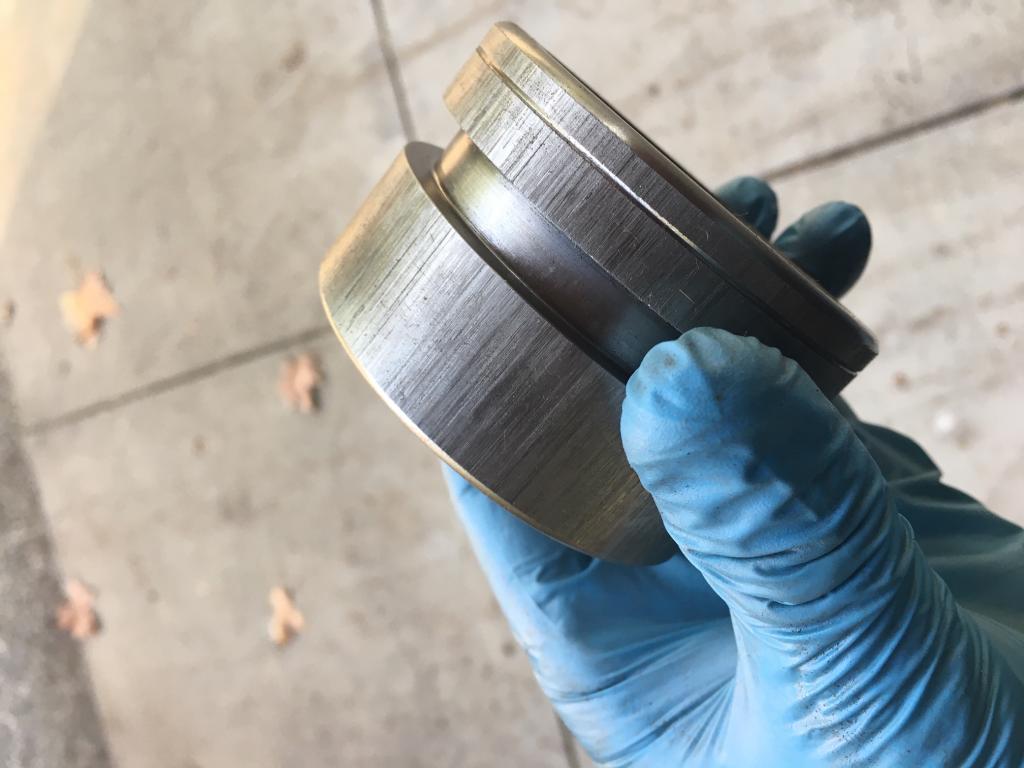

Thanks Wolfman. Of course the oils pretty much flow through wherever there's an O ring. Duh. I blew out the all the veins and ports in the cover casting (they were clean, no grime, no debris) and opened up the cylinder cover to check in there. There is oil in cylinder (though it isn't full in anyway) and the piston is still sitting, stuck in the top even though the rock arms are slack and the dogbone is completely disengaged. (Yeah, it needs oil to push it down). But I can't easily push the piston down the cylinder. I can tap it with a hammer and force it down. So I took the cylinder out and the piston and I see some scoring on both and even without the O ring the piston only moves reluctantly in the cylinder.
Could THIS be the problem. I am extremely reluctant to pull apart the Position Control valve. Those big flat nuts don't want to move and I really don't want to mess with it. I'm going to try and clean up the scoring and go from there.

Yep that could very well be your issue, a sticking piston will do all sorts of weird things.
I would look at getting a new piston, seals, and liner.

Well... I didn't do that, I wire-wheeled the piston and the cylinder and smoothed out most of the scratches so that the piston, dry and without the O ring, smoothly dropped through the cylinder. I put the O ring (and the plastic backer thing) back together and reassembled the whole thing. I figured it might be leaky but would probably work alright.
The O ring makes the piston tight and seems to maintain pressure but it doesn't matter, the rock shafts will rise and fall slowly when the tractor's revved up high but the 3 point hitch won't even lift my puny 160 pounds.

In all my experience with these I've never see a bad three point valve, at least not bad like your having issues.
And a wire wheel to the piston and cylinder are far from the best option to make that combination work well for you, a hone to the cylinder would have been much better.
Like I said before a leaking piston will do all sorts of odd things.
