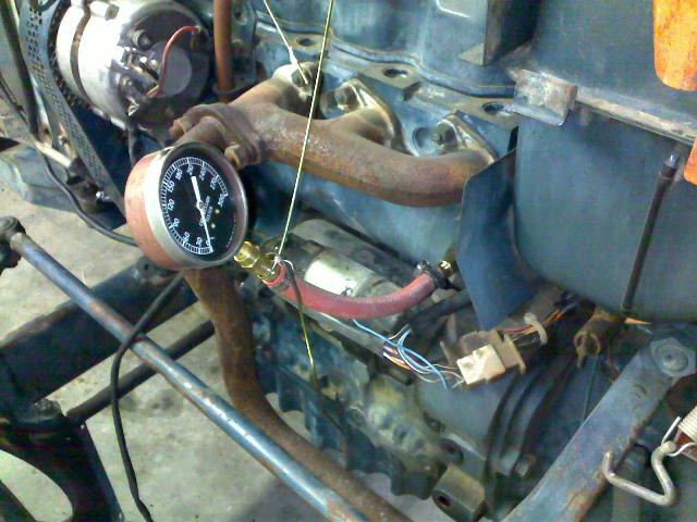

So the uppity Kubota dude down town said "oh yea, you pull the cam, tap in 1/8 NPT plug, and weld it in.. tell you what, you ain't tapping nothing into that cam.. It's harder than my aunt Verna.

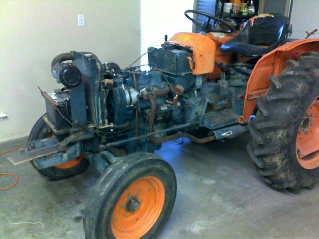

Final adjustments being made:
tach drive mounted = DONE
alternator, belt, and guards = DONE
radiator + 3 hoses = DONE
battery, box, and air cleaner assy = DONE
Tonight, oil + filter, coolant fill.
...As the morning dew settles in the wee hours of Saturday morning, come 8am, I fully anticipate 25 dark diesel horses roaring to life amongst billows of exhaust clouds emanating from my garage.....oooh, I can't wait.

Turned down and Tacked a 5/16 bolt head and shoulder in the cam.. it ain't pretty but it ought to slow the oil leak. Got the case all goobered up with RTV black and back on. though I had everything cleaned, but found oil oozing around the bottom of the case after I set it in place.. oh well, I'll probably be back in there soon enough anyway. check out this site for tunes:

Final Act
...and then one day he went out huntin' food,
and up from the ground came a bubblin' crude...
OIL PRESSURE that is!!
Yee Haw! Oil pressure at last.
Stick a fork in this project- it is officially DONE.
Looking back on this thread, it took about a month.. 15 minutes here, an hour there. It was fun, but I'm glad it's over.
Thanks to all on OTT for the input. Priceless!
