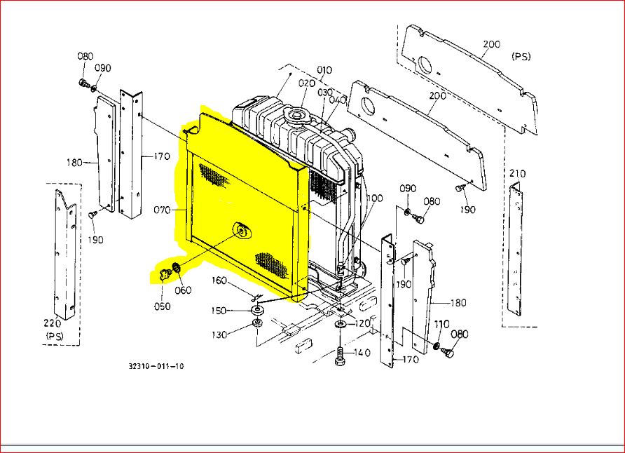

Does your tractor have the Radiator net installed?
If not you need to get one It greatly reduces chaff build up on the radiator, and it's semi self cleaning.

No Wolfman, I do not have a radiator net. There are screens on the front grill and on the side engine covers, but the screens are about 1/8" openings and they just keep out big pieces of trash. This chaff is small, almost dust like. I took a picture, but I can't get my phone to download to the computer. I noticed the biggest buildup was outside the fan suction. Evidently the fan does a fair job of keeping the fins clean near the center of the radiator, but not on the bottom corners.:(
