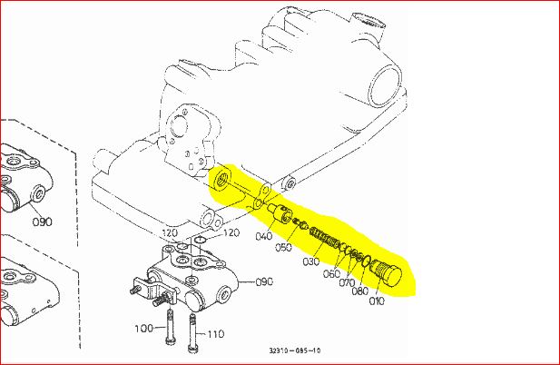

The other cause (Very much a long shot) could be a stuck bypass regulator that is causing it to build too much pressure, you can remove the valve and check for any trash or restriction in the valve, clean it and replace every component in the same order or it will not work.

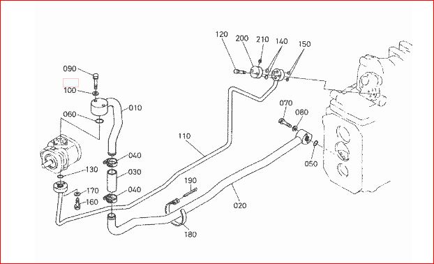

Pump lines:
Pressure regulator valve:

Yea I found that schematic on Messicks after I posted and realize the hose is suppose to link the two pieces of rigid line. The seal looked OK and the lock ring was in place. I replaced a hose on the front loader about a month before. I will check the valve, thanks for replying.

Wolfman I think you are still in the lead for best reason all my fluid is exiting through the pump seal. I just purchased the shop manual since I am still having the problem after replacing the seal and then replacing the pump. Pressure has to be released somewhere and the seal is the weakest point.
The manual describes the purpose of the pressure relief valve you had me check as to "when the pressure in the circuit rises the valve will open to allow fluid to return to the transmission case to relieve pressure." I don't think this valve is operating correctly, not opening, therefore building too much pressure and blowing the pump seal. (I am getting a good schooling in hydraulics.) The spring should compress allowing space between the poppet and the seat. When I took apart the valve only the spring came out not the poppet or anything else in your diagram.
I will take it apart again and see if I can get the poppet removed as well. Not sure how I will remove the poppet if it is stuck inside the chamber perhaps with some fine pointed tool to pry and poke it lose.
