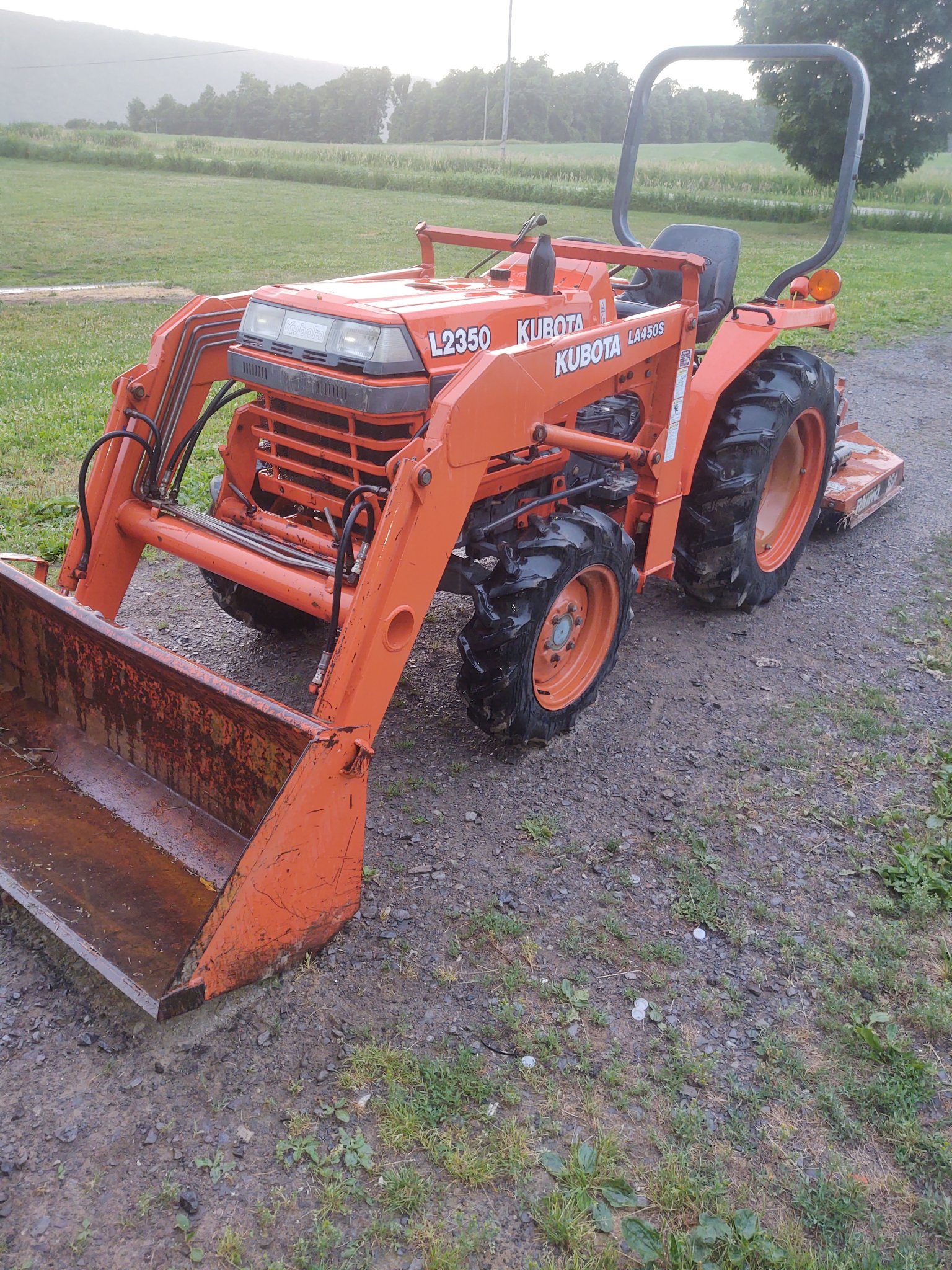

Hi all, recently purchased a l2350 from the original owner, with 570 hours. Since the fuel gauge wasn't working I yanked the cowling off, and saw lots of rust from mouse piss.
Fuel tank sending unit is very rusty and coming apart. Looking in the exploded view, it looks like the fuel tank and sending unit are considered 1 unit, and for the small sun of $1400!. Has anyone else run into this, or found a solution for a replacement?
