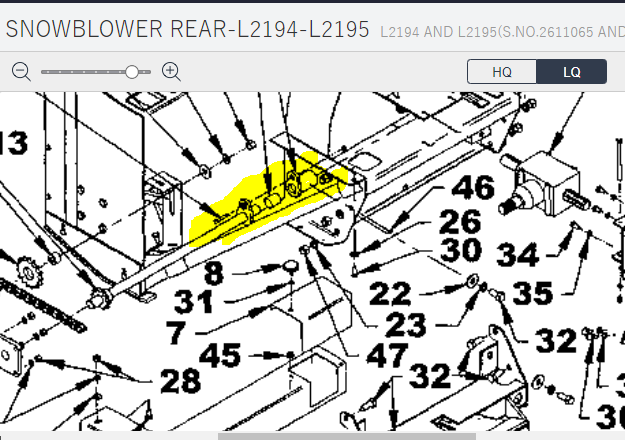

I was running the snowblower the other day and sucked up a big rock.
The auger stopped spinning however the impeller still spins
What would cause this?
29,132
5,422

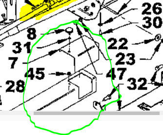

It's probably under this cover:
You shouldn't have to remove any supports to get to it.
