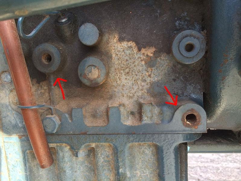

Now, I did notice on the side of the tractor down by the oil dip stick, there are 2 open threaded holes that I'm not sure should be open or not (see photo attached, red arrows pointing to open holes). Could dirt and debris be entering there, and over the years have filled up space to the point that I can only add half the amount of coolant? Tractor didn't always overheat, just started the last year or so of the 12 years that I've owned it.
