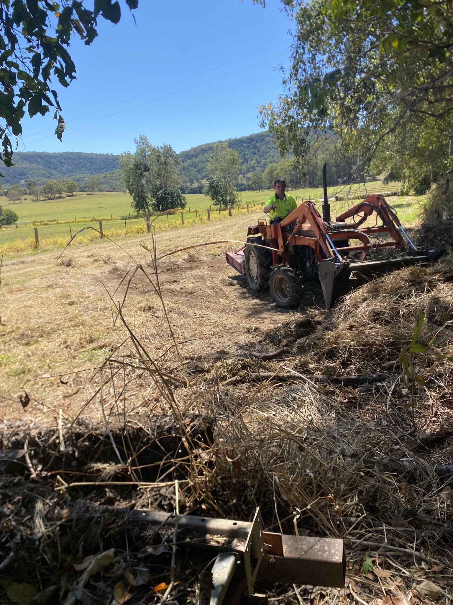

Hi all, I am new to this site and new to owning a Kubota. I don’t have much of an idea of what I’m looking for on these machines in terms of parts replacements. I have an old L1802DT and the seals are gone within the cylinder for the bucket lift for the front end loader. It’s got so much bypass it can’t even lift the bucket up with minimal weight on it. Where am I able to find an aftermarket seal rebuild kit for these cylinders. I don’t particularly feel like spending 300 AUD at the dealership for these seals. Thanks in advance
this is the best photo I have of the machine
