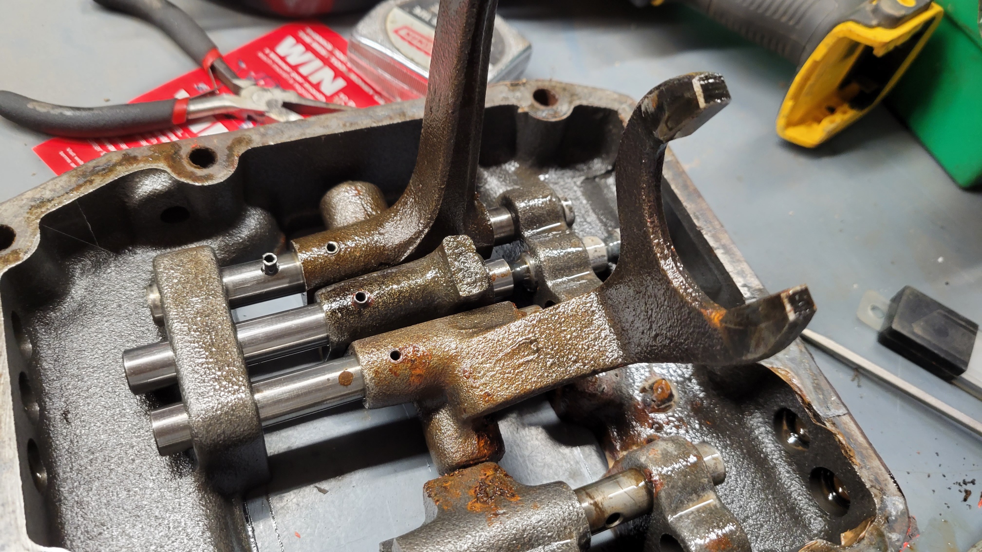

I have a L175 that seems to be in some gear but, will not move. If the clutch is let out, it will bog the tractor down. I have tried high and low range, as well as forward and reverse. If I depress the clutch, it will not roll although when this started it would so I feel sure it is not a brake problem. Any thoughts??? I really need the tractor out of my driveway.

I would think it is stuck in two gears. You need to remove the top shift lever cover and line up the shift rails.

Jack up the rear of the tractor and try and spin each wheel separately.

Last 175 I had one of the shift forks broke and it hang in the gear set that was floating back and forth. As said pull the cover, drain the oil if you have to, and do not lose any balls or springs!
