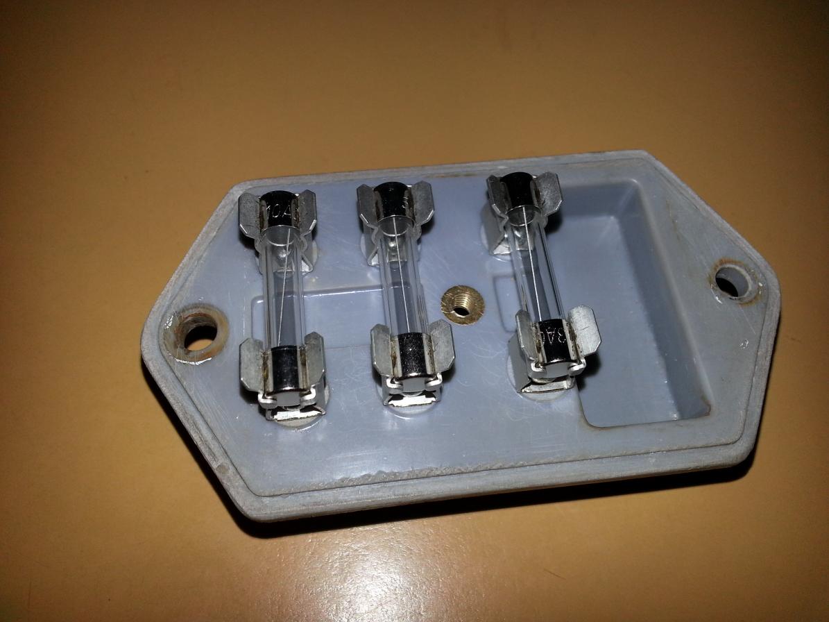

Since I was having trouble finding anyone who carried the wire fuses for my tractor, I decided to upgrade my fuse panel to use the more readily available glass barrel fuses.
Attached is a PDF file documenting the upgrade.
Hopefully someone will find this useful.

@D2Cat - Thanks and you bring up a good point I forgot to ask about.
I currently don't have a cover for the fuse box but I see they do sell them online but was wondering if anyone who has one might be able to measure the inside depth (height) of their cover so I can see if it will fit over my modified fuses.

I will try to remember to measure it this weekend. Mine is a L185 but should be the same. I recall that mine has the glass fuses but it has been some time since I had the cover off.
13,654
5,285

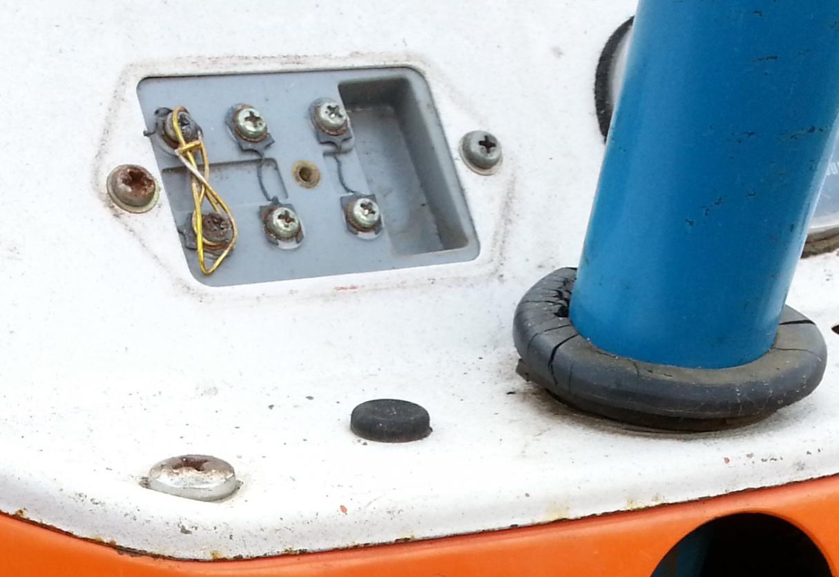

Was out in the barn today and took the fuse cover off and brought inside. It was dark in there so I didn't pay attention to it, but I think the lip fits down over the tractor side about 1/16th of an inch. This is what seals it. I'll go back out tomorrow and tape a couple round fuses to this cover and see how it fits. Only thing I'm not sure of, is how far the holders you used extend up.

Thanks for looking into the dimensions of the fuse cover. Just from the pictures you posted it looks like it's probably not going to be tall enough. I don't have the measurement of the fuses I put in but I'm pretty sure it's just about 1/2" high. If anyone has the glass fuses I'd love to see a picture of those as well. It might give me an idea how to make them shorter as well.

I'll take a look at mine and see what the dimensions are. The l1501 has the same fuse panel as the l185. The covers either a little deeper or they recessed the fuse panel a tad to get the clearance needed. Can't remember which, it's been about a year since I pulled the cover off. Looked at the parts diagram and couldn't tell if the part number listed was for the fuse panel and cover or just the fuse panel.

Measured the cover on mine. It's 1/2" tall. Measured where the base of the cover sits to the top of the fuses. It has 1/16th of an inch clearance between the top of the fuses to the cover if that. It's definitely tight.

You could make either cover work, just shim out our fuse panel (that will move it deeper as your is mounted on the inside) and then use a longer bolt on the cover. :)
Daren's pic has the cover on the outside and it couldn't be done the same way if it needed done.;)

Thanks for all the reply's everyone. I think I'm going to buy one of the covers online and hope for the best. Sounds like it will be close and I'll make it work either way.
