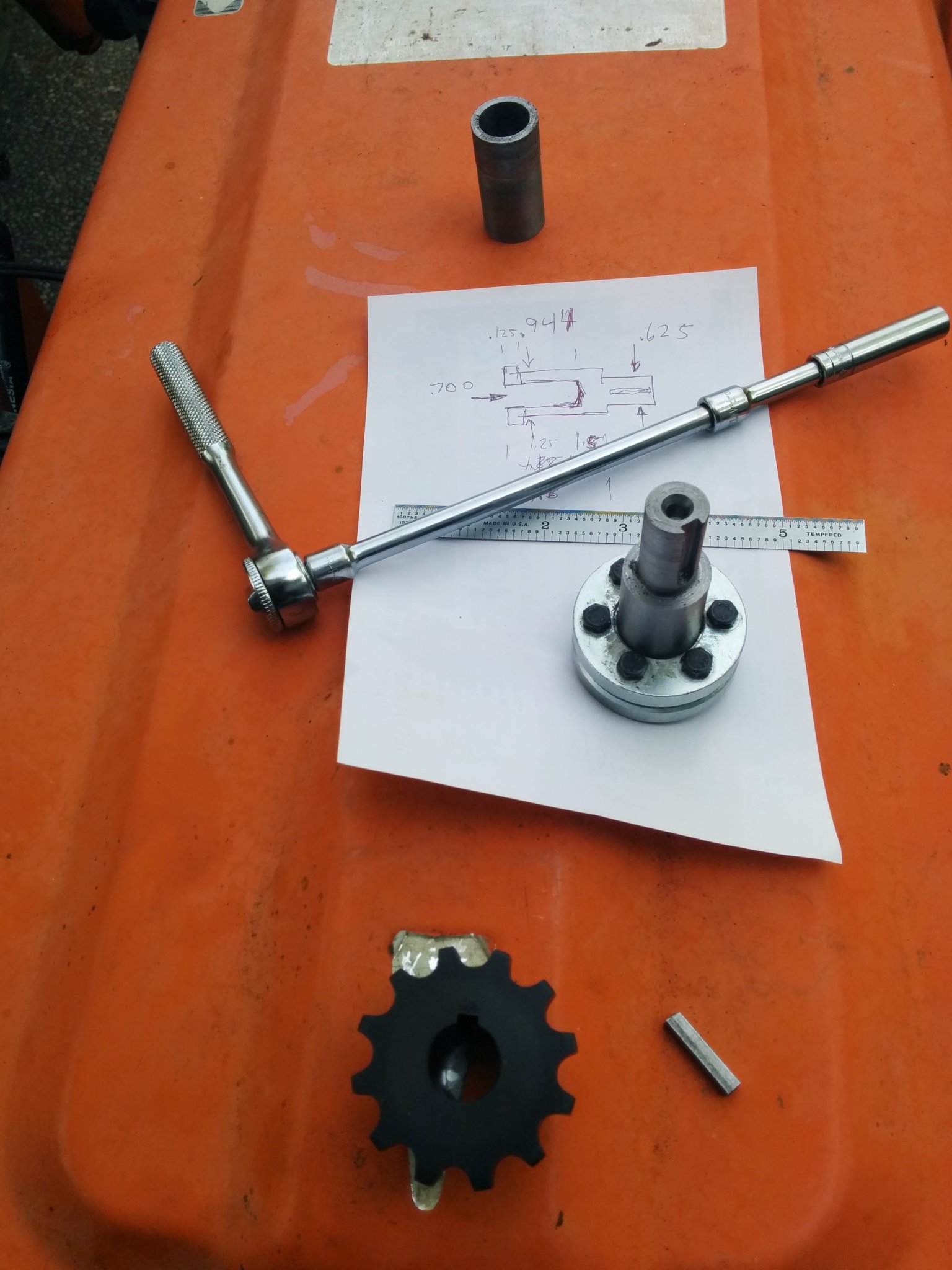

If this setup is similar to the one used on the B5100 tractor, I was able to make a sleeve that just slides over the male splines in the front of the crankshaft, and then transition to a 5/8" drive for a hydraulic pump. A shrink disc anchors the sleeve over the splne; it's been in service for almost 10 years w/o any issues.

This is similar to what I was looking for…
what I don’t understand is how the shrink disc over the sleeve you made grabs onto the splined shaft.. you didn’t split the sleeve you made so that it can compress around the shaft?
I understand what you did I think I just don’t understand how it works.
A little more explanation would be helpful, but I believe you have answered my question.

Look at the picture on the paper, it's split.
The other way to do a retro fit is to bolt the flange to the crank pulley.

thank you I misinterpreted your drawing. Both options are similar to what I figured had to be done. You could probably hand make something too. That would engage the lines. It’s just not the most convenient location.
The shrink disk will compress a sleeve that is solid; it doesn't need to be be split. The shrink disk has a very shallow internal taper that develops a very substantial compression force; of course, this means that the tolerances are pretty tight on the internal and external sleeve dimensions.
I ended up using a metric dimensioned disk because they were available surplus and affected only the OD of the sleeve which I had to turn to z finished dimension anyway.
