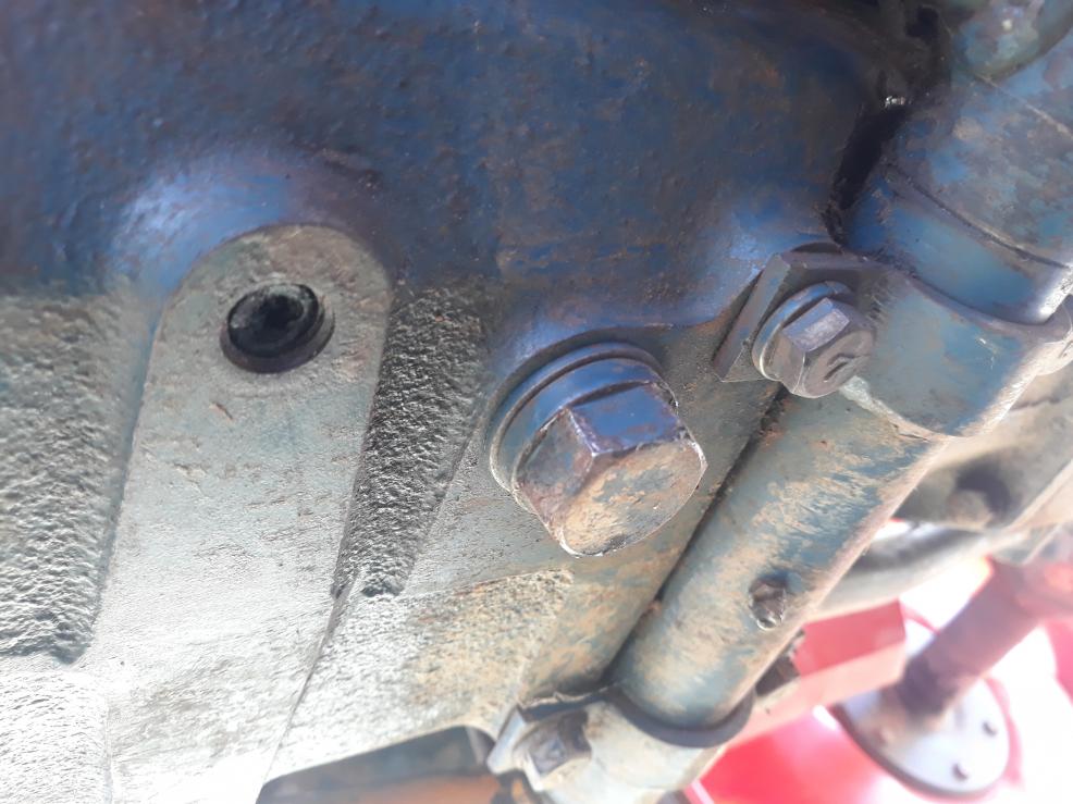

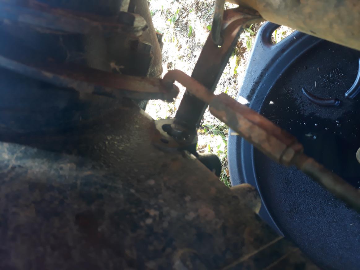

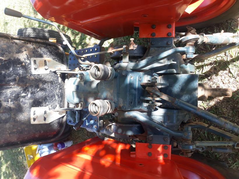

So im looking for the drain points, I got the screen draining right now, so where or how do these bolts look like specifically the axle ones?
I assume one would be the big bolt directly under the shifter but I dont know where the rest would be.
Also I dont see anything under the seat either.
Diesel N8
Kubota L175, Bush Hog.
Dec 27, 2016
49
Lincoln, California
Update, I did drain whatever fluid was in it through that big bolt under the shifter, so now Im trying to find the other areas so that they can also drain what is left inside as well, so please let me know

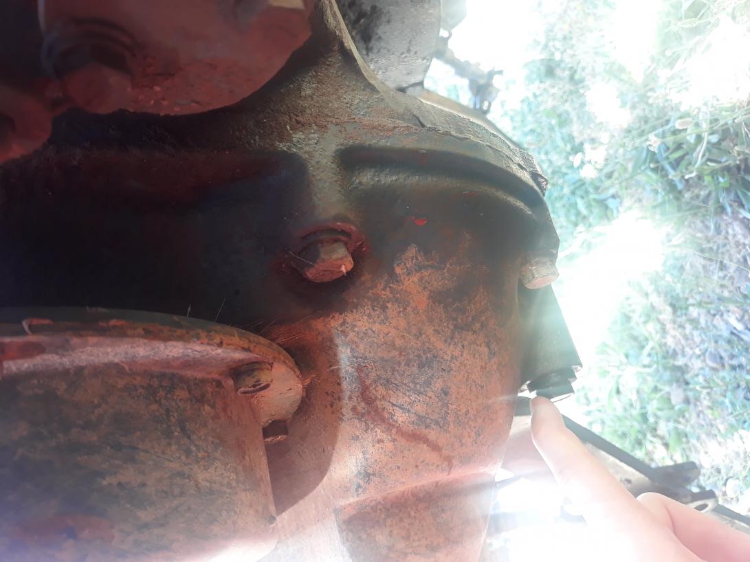

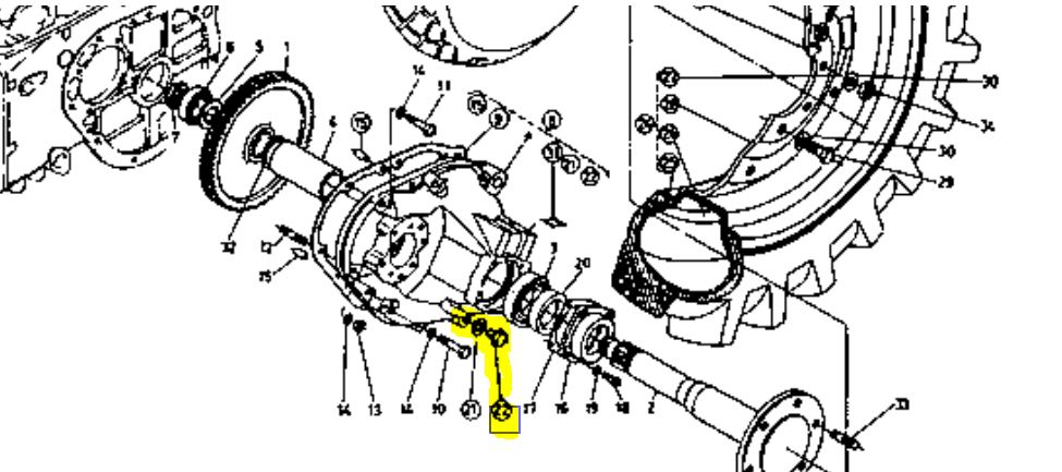

Yep one per axle
Sweet it worked... are there any other draining bolts besides the one under the shifter and these on each axle? I have images that show another bolt near the axle ones but I dont seem to find that either...
Added a pic of where the big bolt is on the axles.
