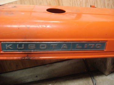

Help! I'm the proud owner of a L170. It's a one cylinder diesel 784cc. I just got her home last night. Hasn't been run in 12 years. Need info on it, starting procedures manuals, etc. Engine is a E800-3501.

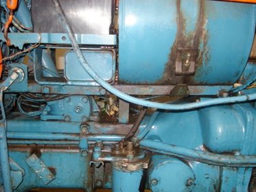

plenty of pics, front, rear, side, dash, and importantly under the hood!!!!!

Got the L170 running! All fluids changed, greased, hoses and belt replaced, radiator fixed and ready for some paint.
Thanks to a fellow at Tractor Parts in Apple Valley CA. Ron was the only guy in the US that had info on the L170.

L170 is back up and running good. I have some info for you guys that may need to rebuilt your L170. The ring end gap was an average of .098. That explained the oil and smoke problems I was having. It should be .020 to .025. I had head rebuilt. Some cylinder honing. Cylinder Bore Size 4.016. New Ring Set from grantpistonrings.com, set# C1603 and oil ring spacer # BC-4.016-0-130. With this ring set I had the correct ring gap. Ran it for about 30 minutes then head retorque. I have about 1 and half hours on it. Tractor is running strong, no oil or smoke at this time. Another thing, I also have a drawing file for new head gasket.
