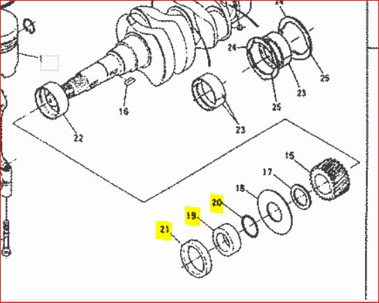

I should have paid a little more attention to the details:) the gear case cover is fine. Looking for the part numbers for the crank shaft lip seal and the gasket for the gear case cover. I gotta pull the cover to replace a cam shaft plug. I'm trying to get what i need ahead of time so i can put it right back together. This is all depending if it's the front one. If it's the back one, then i'll order the head gasket and what ever else i'll need later. I already have the plugs ordered. Found it in the oil pan when i dropped it to check the oil pump screen. I have one question while i have your attention ;) is the crank shaft sleaved where the lip seal rides?

These should be the right parts for you:
The 175 and 185 both list the same part #'s
The part that the seal rides on is called a collar, and there is an O-Ring behind it to seal the inside of it.
Gasket gear case
15222-04130 $22.76
http://www.goldeneagledirect.com/index.php?l=product_detail&p=70030
O-Ring
04811-10300 $1.14
http://www.goldeneagledirect.com/index.php?l=product_detail&p=53515
Collar Crankshaft
19202-23250 $25.70
http://www.goldeneagledirect.com/index.php?l=product_detail&p=80650
Seal Oil
09550-00001 $5.28
http://www.goldeneagledirect.com/index.php?l=product_detail&p=56071
