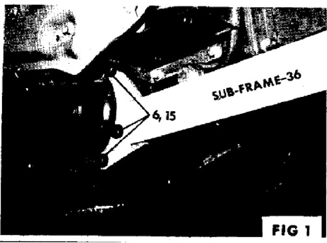

I hope I am wrong, but it looks to me like it is clamped to the axle shaft not the axle housing. ?????
That was one heck of a good catch, I totally missed that detail, I too am so used to there being nothing but housing and a hub sticking out.
One way to fix it is do like it's done on mine, and bolt a plate to the axle housing then bolt or weld the axle bars to that plate.
8,168
3,535
Here is a (poor) pic from the manual for my B219 loader- it shows the sub frame ending in a circular cutout, which bolts to the differential housing.
Perhaps you could do something similar- maybe even the bolts that hold the end cap/seal housings would be sufficient…..

Want to give thanks for finding my big mistake. Changed the design, moved the bracket back to where it is now located and I think were out of the woods.
Now to do the other side.

Yes, the second one went faster and turned out better because I already had my cardboard templates cut out and did not have to put a dog leg in this one to clear the steering arm.
Got it all back together, painted, put the ballast box around, went and grabbed a full bucket of caliche from my pile, traveled three quarters of a mile back to my place and nothing moved or broke!
Again, my thanks for all the input that solved my problem.
