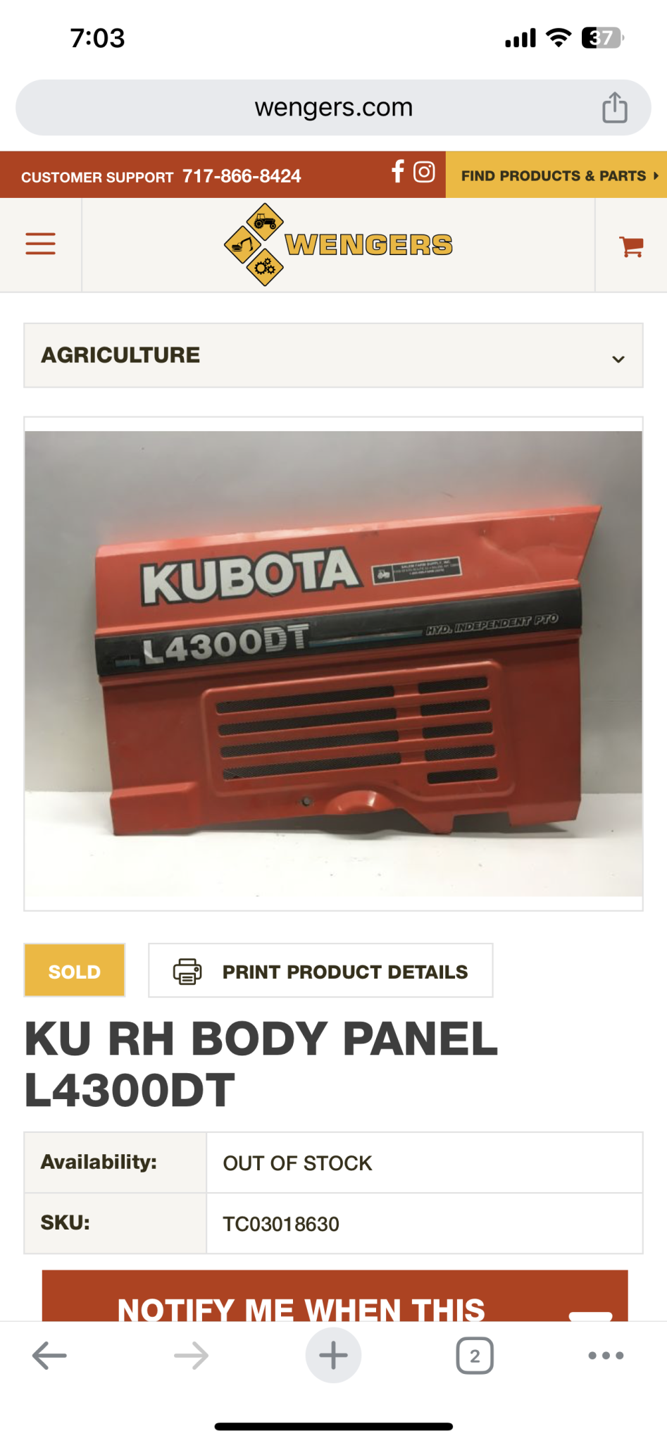

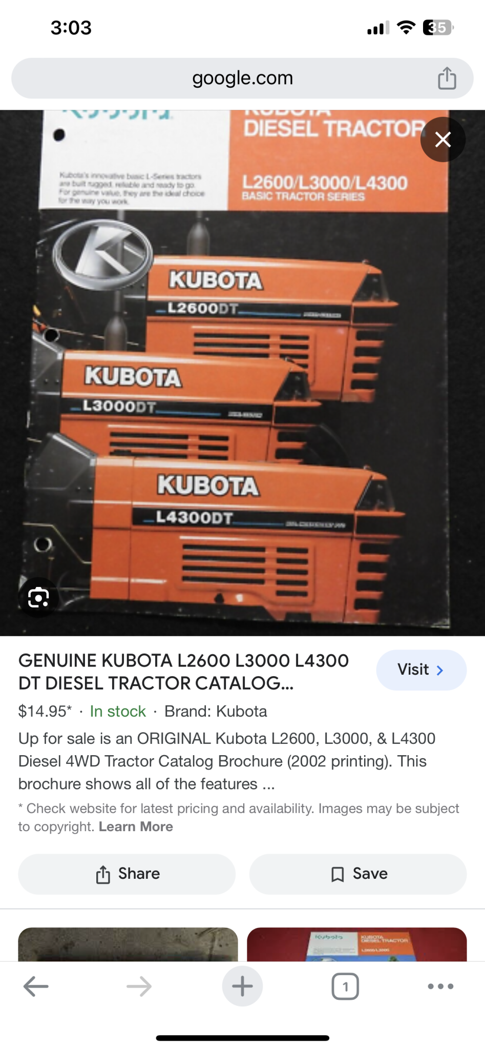

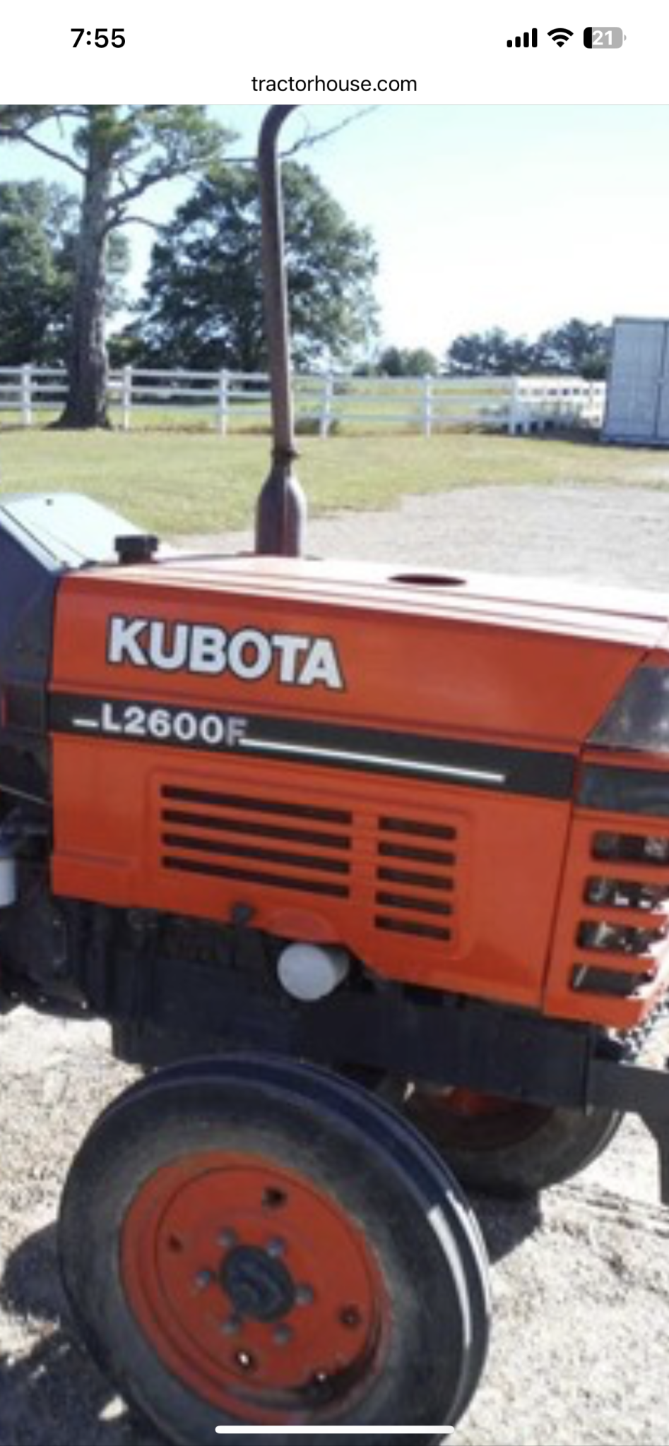

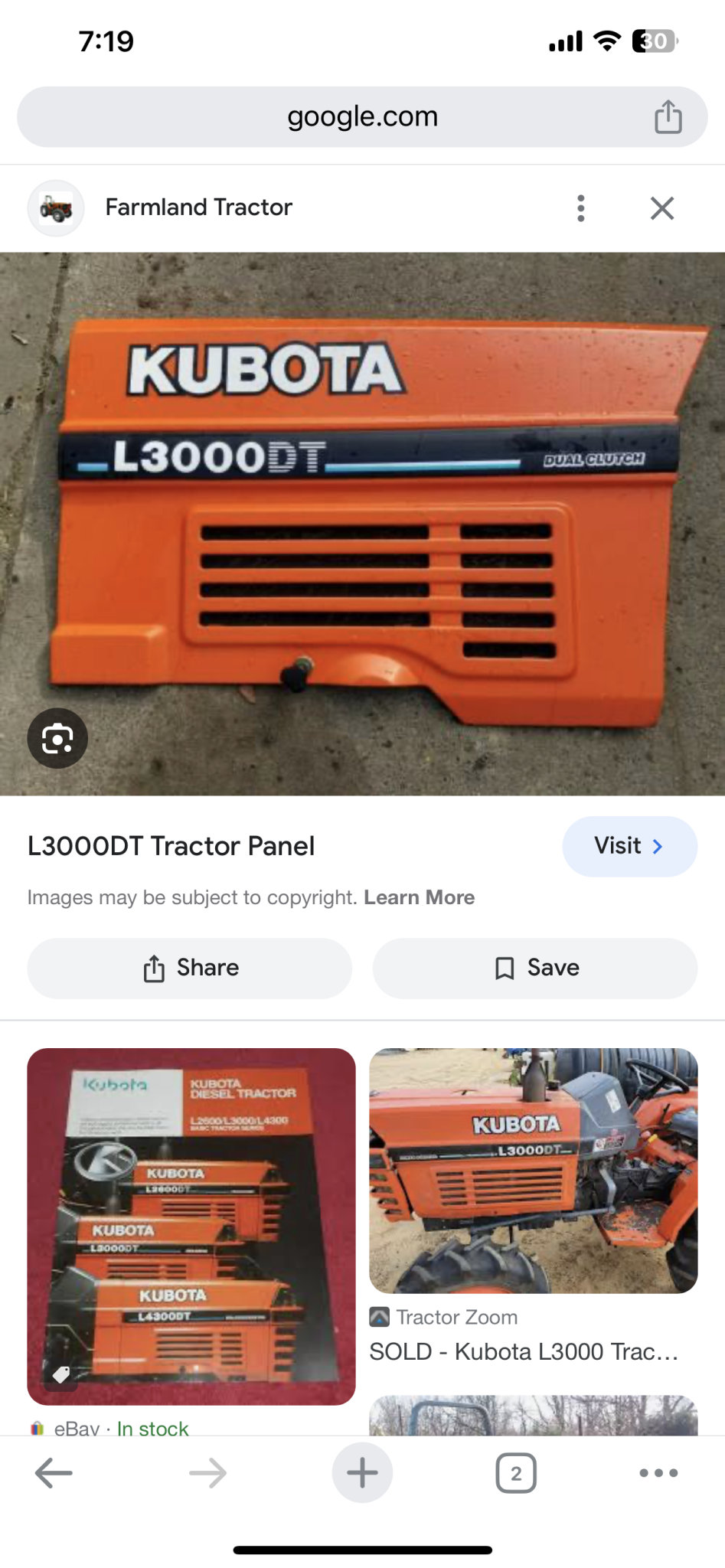

I Purchased an l4300 DT a few weeks ago. It’s a nice low hour tractor but it’s missing the right hand engine side panel. Somehow it came off when the guy was mowing and he accidentally ran over it with the brush hog and destroyed it. Having trouble finding a used one. A new one from Kubota is around $1100. I don’t really want to pay that! I was looking at the L 2600 and l3000 side panels. Does anyone know if these will interchange with each other. They look identical. The only difference that I can see is that on the 4300 it has a little notch cut out at the bottom right side. I looked at my tractor and the only reason I can see for the cutout is that the radiator drain plug is right there behind that cut out. If that’s the case, you could just remove the side panel to drain the radiator. And if the notch had to be there, a sheet metal shop could probably cut that out for you. I was wondering if anyone knew if those were interchangeable as far as the physical size. Just looking at the pictures they look identical. Might be easier to find one if you had two other choices. A guy could just change out the decal.

Its hard to tell by looking at pictures as far as the actual physical size. But they sure look very similar in the pictures. Yes, I have even thought about having one made at the sheet-metal shop. Could probably do it cheaper than $1100.
But if they are the same, I would probably have a better chance of finding one of the three.

I checked on messicks. The 2600 and the 3000 are the same, they have the exact same part number. The 4300 is one number off from that part number. But, it will have a different part number even if it’s the same size because of the notch cut out in the bottom of it. I just need to look around and see if I can find a 2600 or 3000 tractor and measure the panel.
