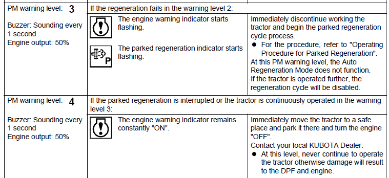

If light 10 is flashing you are in PM warning level 3 OR if constant lit you are in level 4!!!
beeping frequency no longer important should be 1x/sec. regardless..
if level 3 (flashing lite 10) stop using the tractor, perform immediate PARKED REGEN as auto regen is disabling
if lite 10 solid ifs too late and you are into stage 4 a trip to the dealer is going to be required so they can force a regen or service the DPF depending on how bad of trouble you got it into.
good luck, fingers crossed for you!!!
Wow thanks

In other words, if it's in stage 4, 4.5 or 5, it's been beeping for a long time, and the two upper right hand lights have been blinking for how many hours? Perhaps another operator was using it and had no clue.
I don't disagree with it being way too much crap to put on a tractor of this size, but we gotta get used to it....our illustrious government mandated it and they are so big and powerful that "we" have no say-so anymore. Or that is how I feel anyway.
