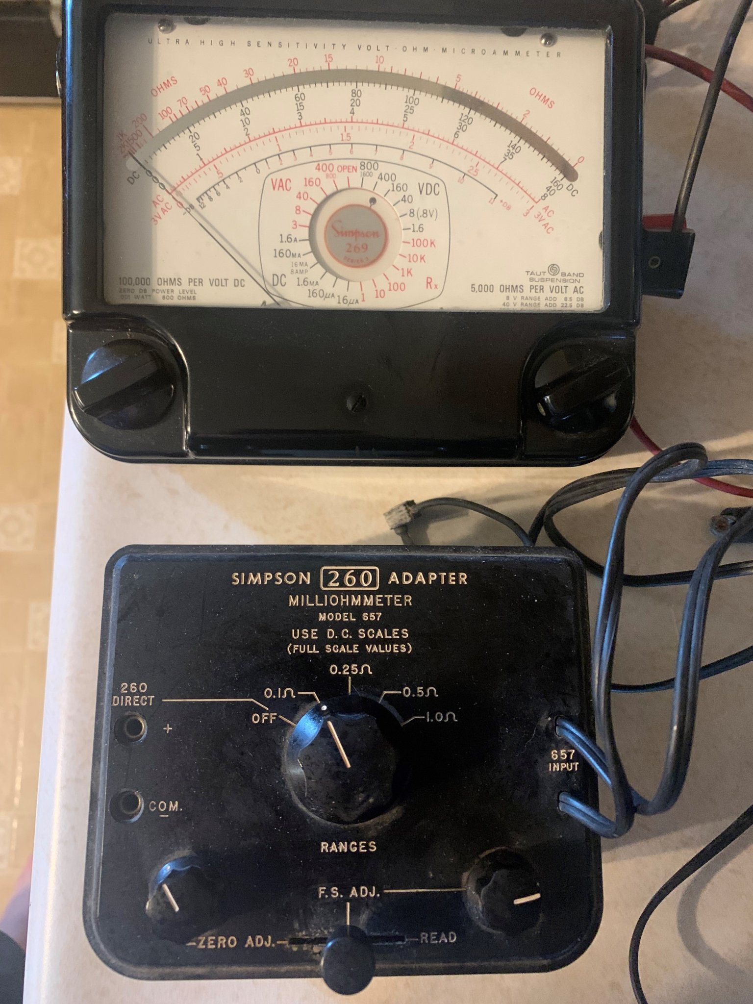

Trying to read resistance with these using a typical VOM/DMM won't work because the amount of resistance needed to create a problem is far less than what these meters are designed to read. 0.1 (1/10) of an ohm creates a 10 volt drop under a 100 amp load but no standard meter will accurately measure a resistance this low. I have a Simpson adapter for my classic 260 series VOM that allows measurement down to 1 milliohm which can directly diagnose these sorts of connections issues. It uses the equivalent of a 4 wire setup so that it is measuring voltage drop across the connection and presents the result in resistance on a choice of four selectable ranges from .1 to 1 ohm full scale.

An Simpson analog meter, haven't seen one of them in years!!!
I have Tektronix and HP digital meters on the bench but I also keep a couple of versions of Simpson analog meters around because I do a lot of restoration of vintage amateur radio gear. When doing alignment, a true analog meter indication is much better than the bar type simulated analog response provide by a DMM. Without an analog meter, I would rely upon a Tektronix scope for those adjustments requiring real time response.
I have a rolltop case Simpson 260 that gets used with several 260 series accessories like the milliohmeter. The Simpson 269 shown in the photo with the adapter is a less common Simpson meter and its high sensitivity 16 microamp taut band meter movement gives it 100K ohms per volt sensitivity for DC measurements providing less loading than a DMM or VTVM once you get above the 8 volt range.
