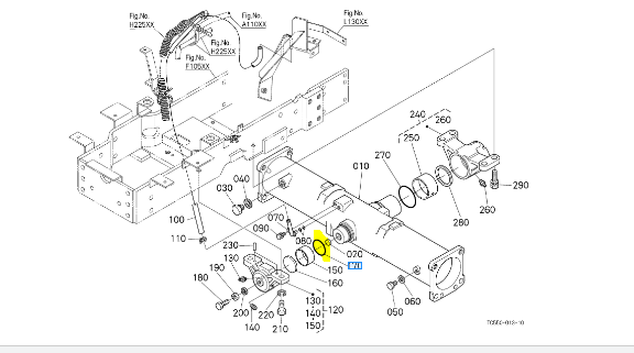

No seal just a simple O-ring seal, 04816-00490.
