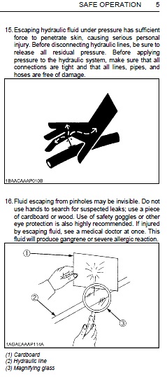

If the hydraulic system is developing pressure as it appears, then it is dangerous and can inject fluid into your eyes and skin. You should be wearing eye protection and gloves.
The following info is found in all Kubota manuals
Dave

Dave and Torch,
I think you both came up with the same idea at the same time, Ok, I'll do the return line first, if it checks out ok, then connect to the inlet side of the filter and try it to see if he filter is the problem, correct.
I wear glasses anyway, and usually wear gloves though fingerless ones. Thanks for your concerns, I appreciate it. Thought the info isn't in all Kubota Manuals, not the 1977 ones anyway. Remember my tractor was made in Japan, the only safe warning we got was, "Aso, be careful." LOL.
