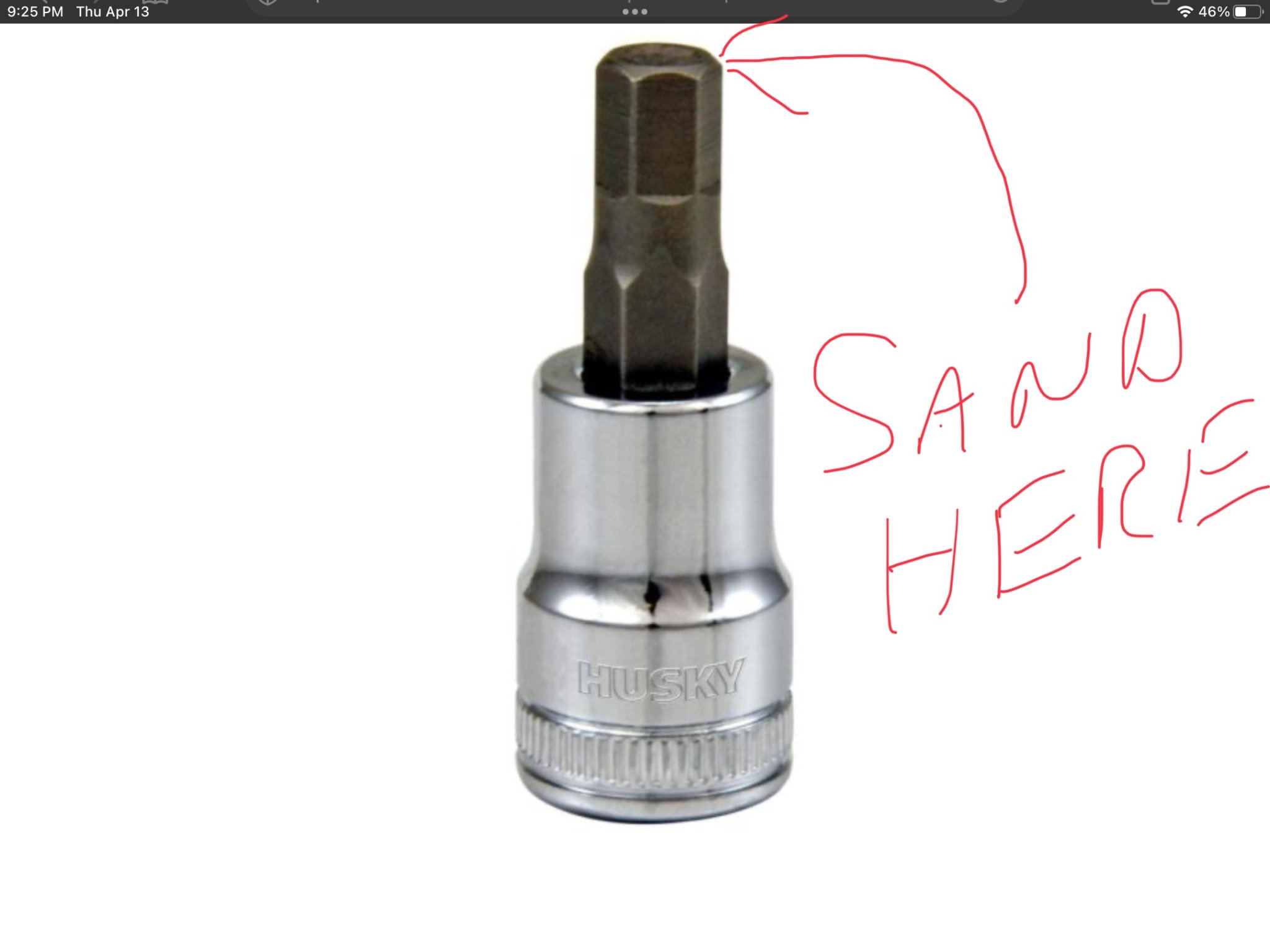

Where did you get the good quality allen wrench?
You’re better off with an Allen socket than an L shaped wrench. It’s much easier to control leverage and keep it square in the plug. Another secret is to take the socket to a belt sander to knock the chamfer off the end. That will allow the hex to go in deeper and give you the little extra bite. Lowe’s(Cobalt), Home Depot(Husky), or Ace Hardware (Craftsman) are decent (although all Chinese) quality.
