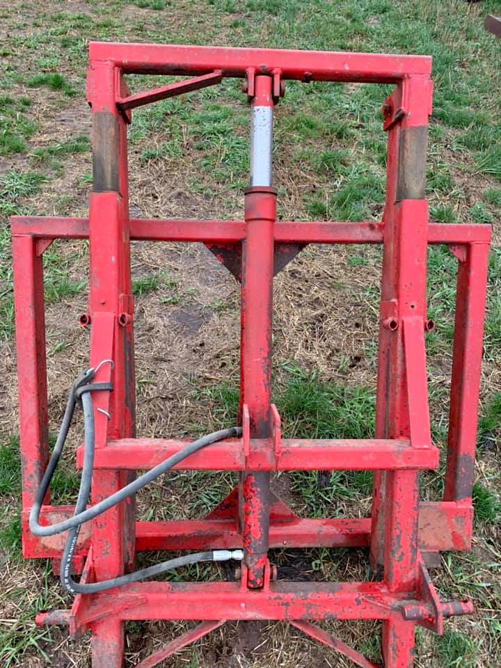

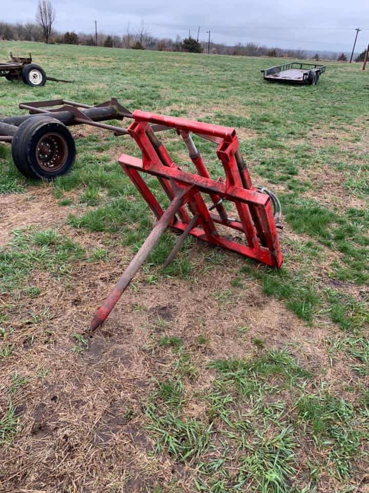

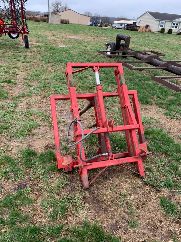

Your question got me to thinking. There is an implement many are not familiar with just because it's not real popular, but it's a 3 pt. "high lift bale stinger". It's made to back into a large round bale and be able to pick it up high enough to load the hay on a trailer, so one could load large bales without a front end loader.
Here's a picture of one I found on FB. There are some without hyd cyl. also. I was thinking you could fab up a copy of the mechanical lift part and attach your snow blade where the bale spike would be. Then you could push snow and lift to make a pile if necessary.
https://www.facebook.com/marketplace/item/600749405434428/?ref=search&referral_code=null&referral_story_type=post&tracking=browse_serp:da0bfaf3-b1ce-48d9-b1a8-625e6c494a09
Very interesting idea.
Are these things in current production by someone?
