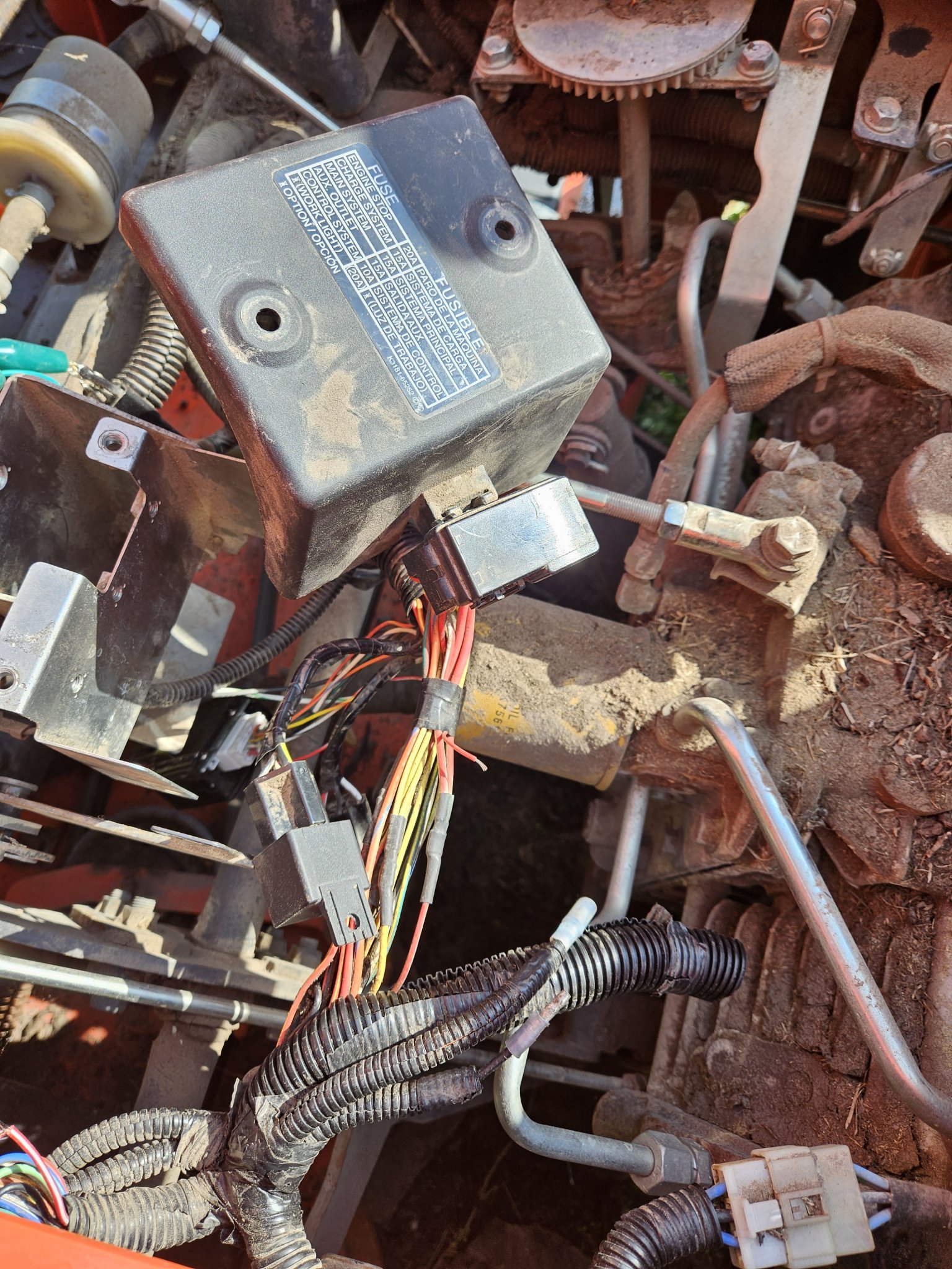

TODAY we had 12v at the 20 Amp AND at the solenoids r/w. (Major head scratcher).
At some point I look at the fuse box and the contacts slot for the 20A. One side seems a bit stretched too wide to make good contact. I grab a flathead and bend it back in. So maybe this was causing the incremental no voltages.
So, try and start? Same issue. I'm getting near my surrender point.
So after the solenoid we have the OPC and meter panel. The (broken) wire for the meter panel now shows 12v. That's a first. So now we're in business.
But the OPC still isn't showing 12v at pin 6. I jiggle, push, and test with a copper wire a handful of times. Nothing. I'm suspecting the plug, but it just seems too solid.
I give in and start untaping the harness. Pain in the butt. I Finally. Finally find the splice and the ultra small pin 6 wire.
It slides right out with a tug. I strip the wire, get 12v on it, and we're cranking away.
Mystery solved.

Yeah I spent way too much time trying to figure out where the OPC was and then had to figure out myself through the comment here and the parts listing I found. (You can't see the wire colors to identify it unless you remove it)
Anyway, I cleaned and put it all back together and now have a direct feed to the battery now for that OPC connection.
Ran great with no issues on the dash. With all the unplugging, fiddling and jumping, especially with those tiny OPC wires, there's always a concern a new problem could be created if something gets pulled too hard or cut.
